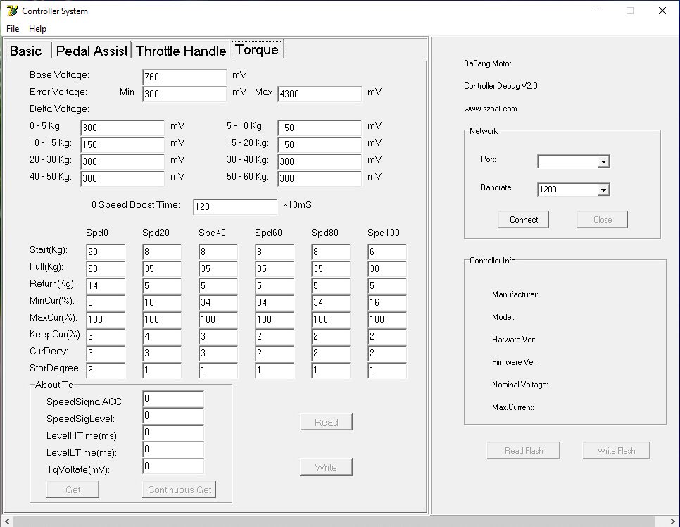

So I adjusted the settings, and the throttle part of the equation has improved; in fact I need to cut back that throttle power now by ~ 1/3 I think to be where I want it.
I'm still--at least for now--not a fan of the torque sensing. How if at all can I adjust my settings to end up with more "BBSHD-like" performance (= deemphasizing/dampening the torque sensing so each PAS level is more static/BBSHD-like)?

I'd suggest to be patient and adjust how you approach the motors response because once understood and accounted for on your end with riding adjustments the refinement of the Ultra controller is something to be appreciated. Took me about 3 months to get there.
That said on the last page Speed Table if you raise your MinCur% it'll feel more aggressive but still be much more refined/manageable than a BBS
I also found lowering the mV values on the Torque table to be smoother and more responsive than just lowering the corresponding numbers on the Speed Table.
Try something like this....
I've used these but in the end tuned the MinCur% back down for a more efficient natural feel. I've had them as high as 40 without issue.
