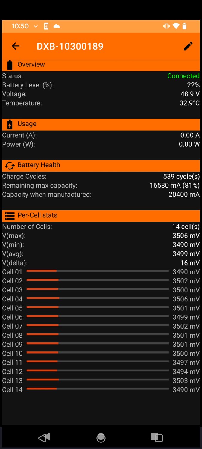

Here's a pic attatched of the bms after the ride, I don't approach the low voltage cut off of the battery even with voltage sag under load. As to why the range seems low for its capacity, the pack is down to 80% of it's rated capacity, still not degraded near enough to retire it.

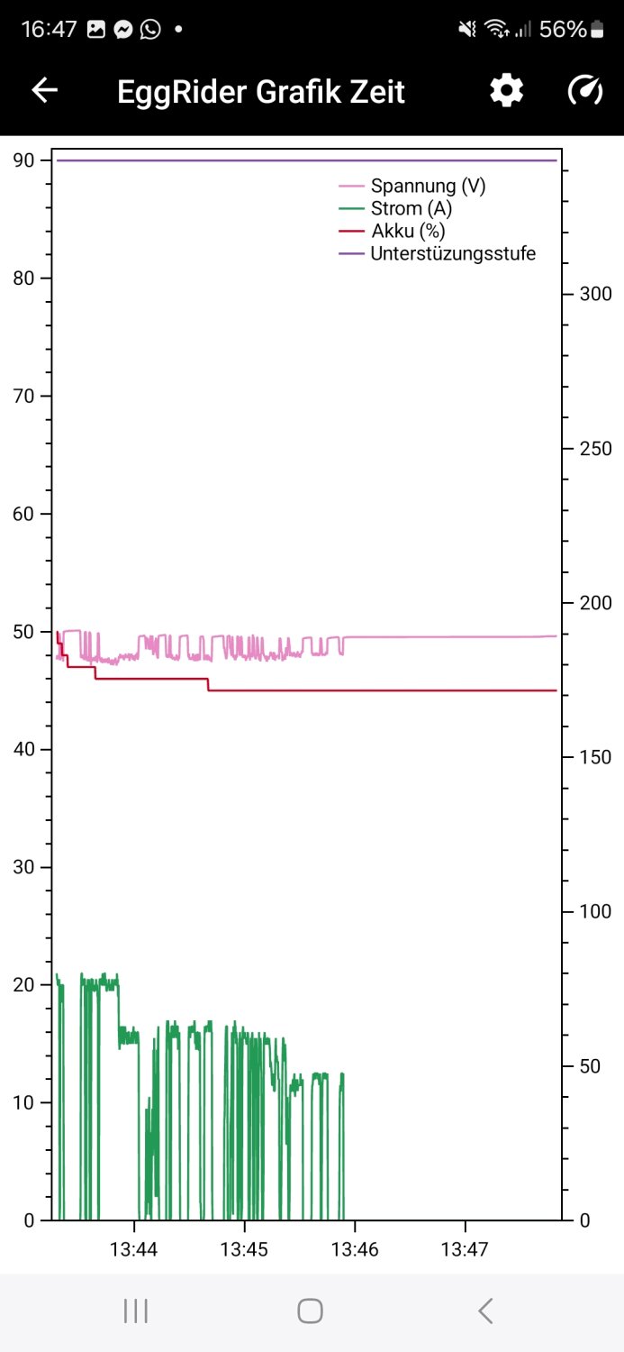

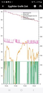

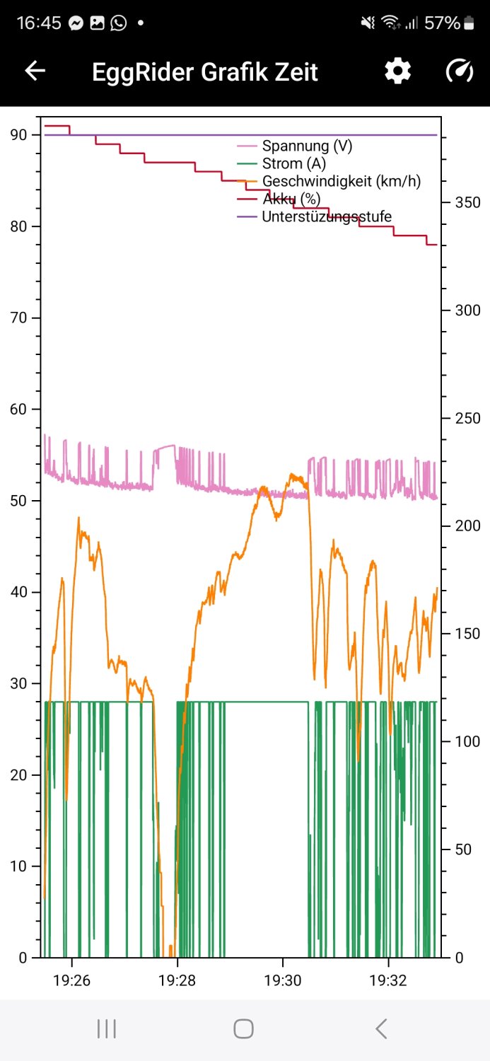

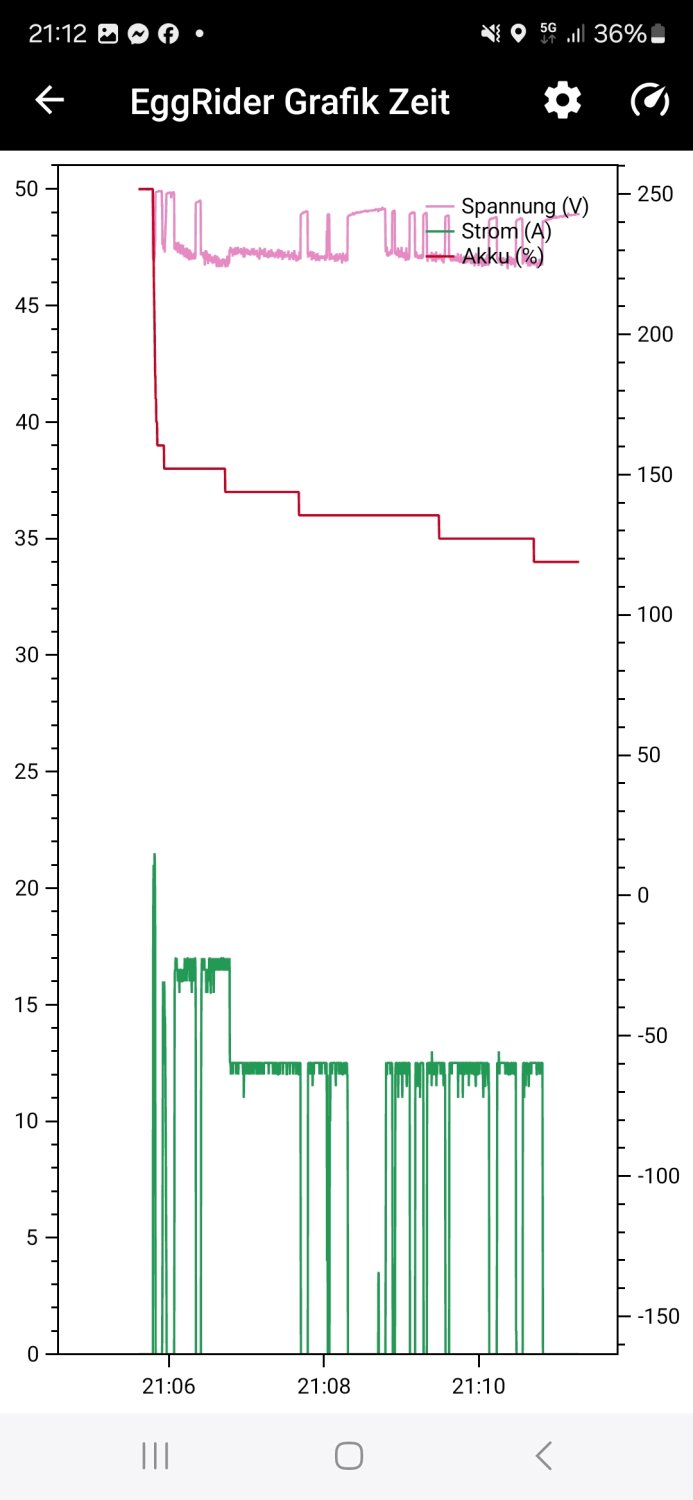

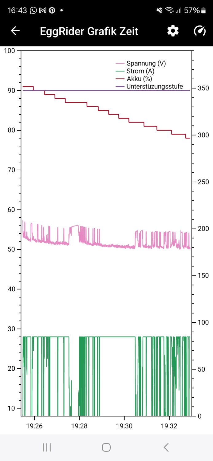

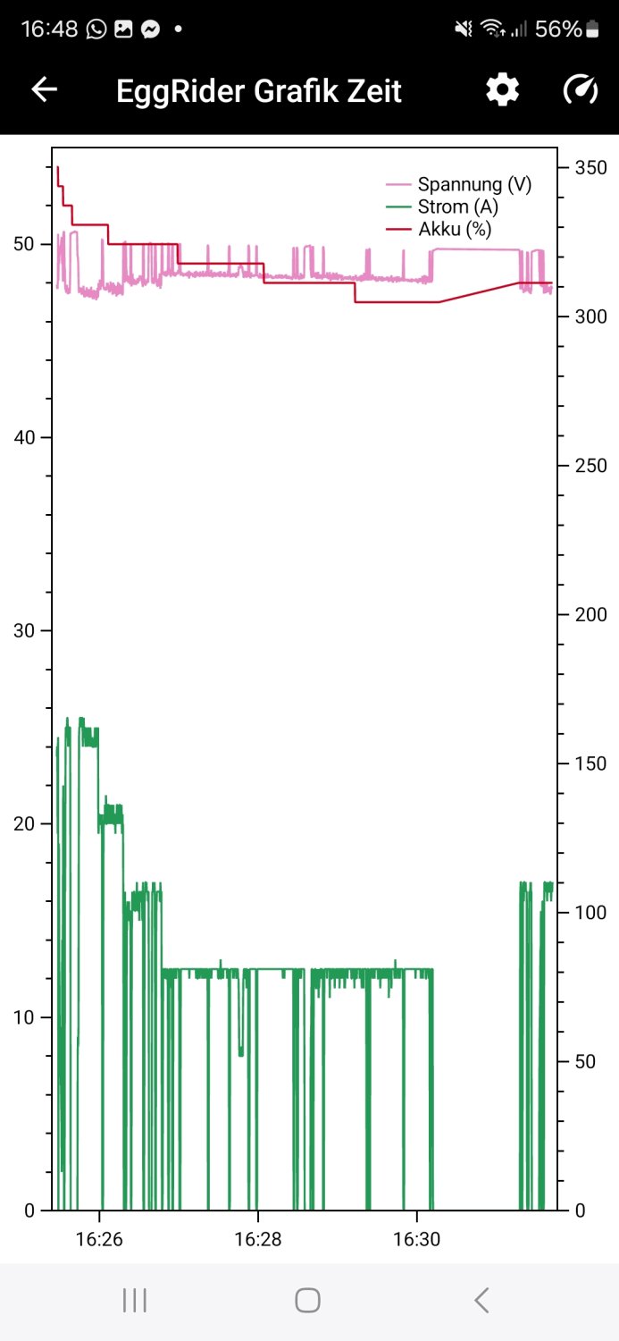

Hey i have same issue.
Max current drops from max 28A to 24A then 20A then 16A then 12A for the rest of "47V/48V" to shutdown....
I could get besst tool with account and some firmware for testing.
Could you tell me what firmware works and stop this behaviour?
Or whats the solution?
Best regards Stefan
