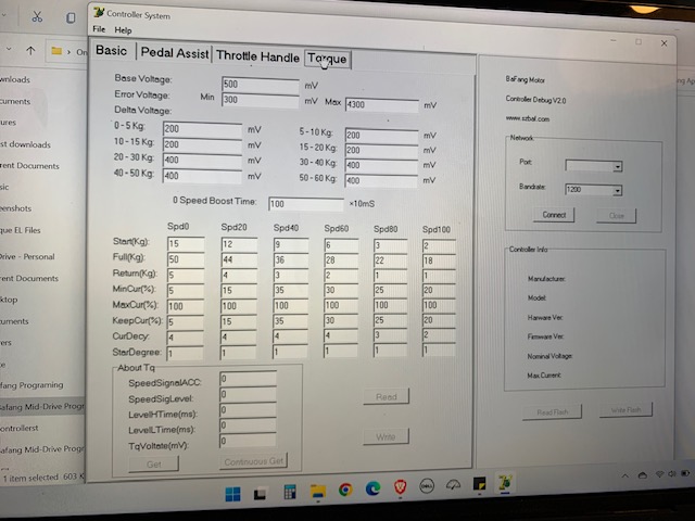

I have been studying the settings and have an idea of what i want to experiment with. I plan on starting out with the Frey Smooth settings. The only three variables i plan on experimenting with are the Limit Current settings on the basics page, delta and base voltage and Full (kg).
I like the idea of what Frey has done by making all 6 Start(kg) settings to 1, it make sense that power should come one as soon as torque is sensed. ( but with the base voltage set to 740mv, power will not come on till the torque sensor output reaches that value). Delta voltage is really something that i can see as user specific because each rider's leg strength is different.
The sweet spot for cruise cadence for me is between 65 to 75 rpm, I will make any changes to Full(kg) if i feel there is too much or too little power in that range. I will also make any changes for the 85 to 95 rpm range as well. The ultra should spin at 150 rpm for a 48 volt system so Spd60 should equate to approximately 90 rpm.
I like how Frey has return kg and keep current set. I really don't like when assist cuts out while i am peddling and find it very irritating.

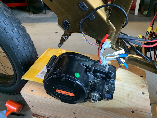

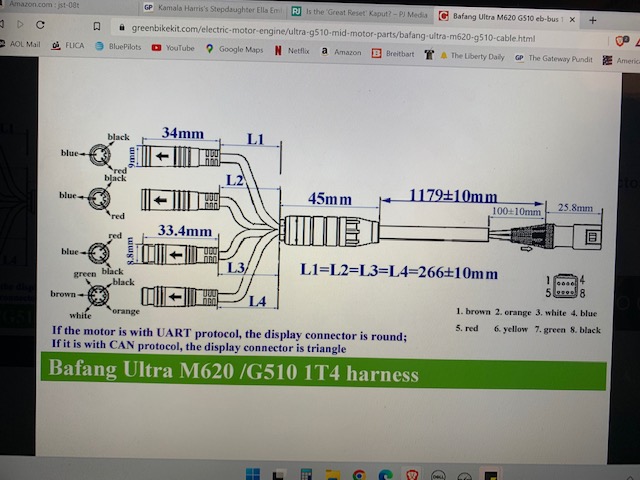

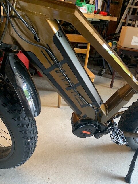

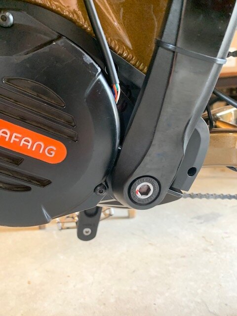

So the motor swap was successful. The Uart and Canbus motors seem to be identical in outer dimensions and shape so the Uart motor swapped right in. The process was a bit of a nightmare for several reasons.
1. Biktrix - it took biktrix a week to ship the motor and then another week for it to arrive. When it did arrive it did not look like a new motor. I was told it was a new motor taken off of a bike ( biktrix would not disclose the reason ). The motor i received looked used. There was dirt in the crevices, a big scratch on the bottom of the motor and the black power wire has a splice on it. I paid $800 for the bare motor not including shipping, Green Bike kit sells the entire kit for $809 new but i went with biktrix because of the support they offer and they did say it comes with a one year warranty.

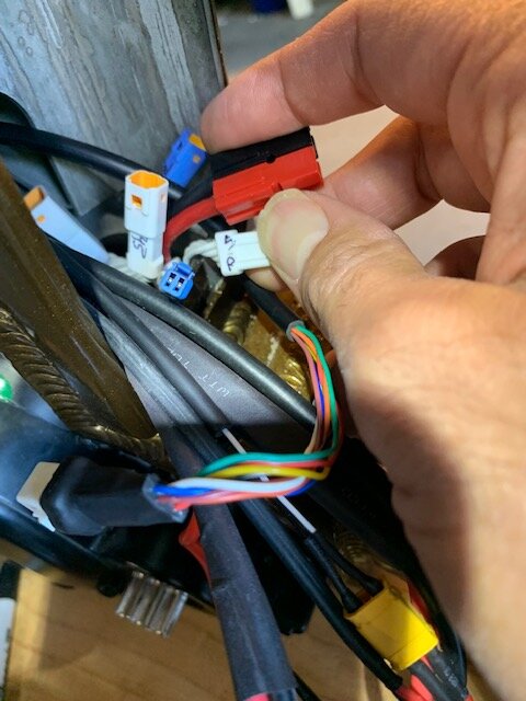

2. Wiring. The wiring on the Biktrix Juggernaut Beast is tight. There is not much room to connect and disconnect the electrical fittings. The biggest problem is the wiring harness. I cannot pull it out the Canbus harness without cutting off the 8 pin JST fitting. The space in the frame is tight, the battery cables are thick and take up a lot of room. For now i ran the Uart cable outside and taped it to the frame ( it looks horrible i know) I will finish the wiring this winter once the season is over. The canbus harness remains in the frame.
I have an idea. I think i can use the canbus cable and not have to remove it. I can cut off the JST 8 pin female fitting and put a male fitting on. (the uart and canbus cables have reverse gender fittings) Green Bike kit sells the fittings. And cut off the triangle display fitting and splice on the round uart fitting. There is a wiring diagram on Green bike kit.
The bike seems to run great!! The new ( not so new) motor seems to be very quiet ( extremely quiet ) compared to the canbus motor it replaced. The first thing i did was program the motor with my settings and it is a night and day difference. I may refine it over time but for now i an going to get used to the settings first.

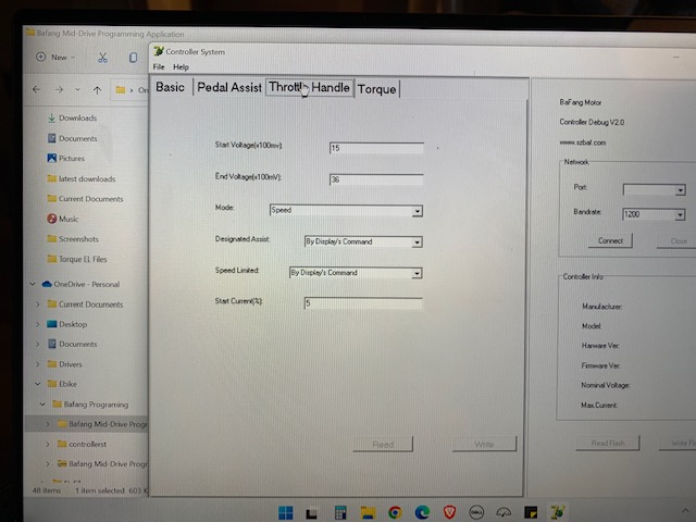

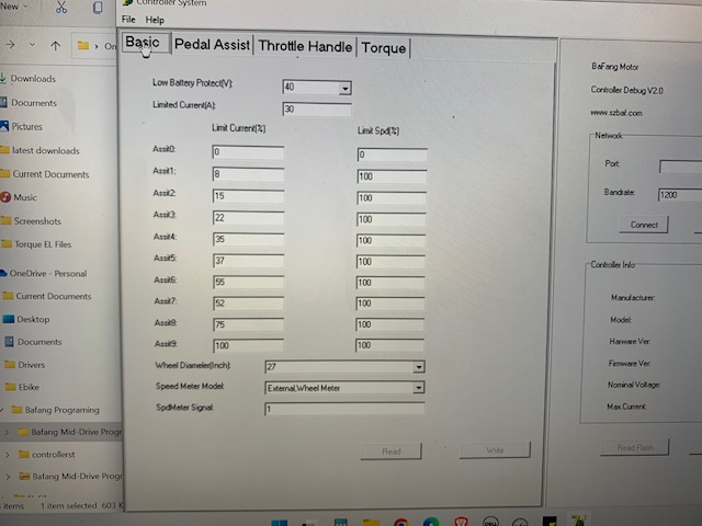

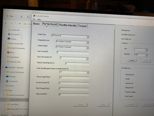

My Settings:
