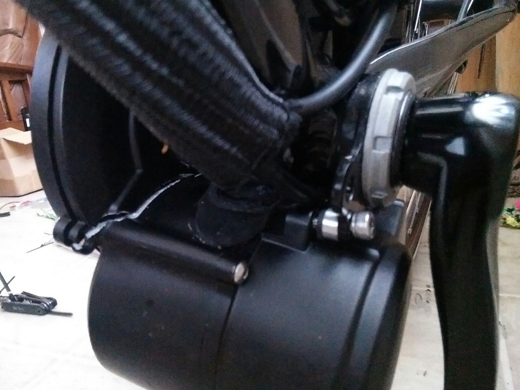

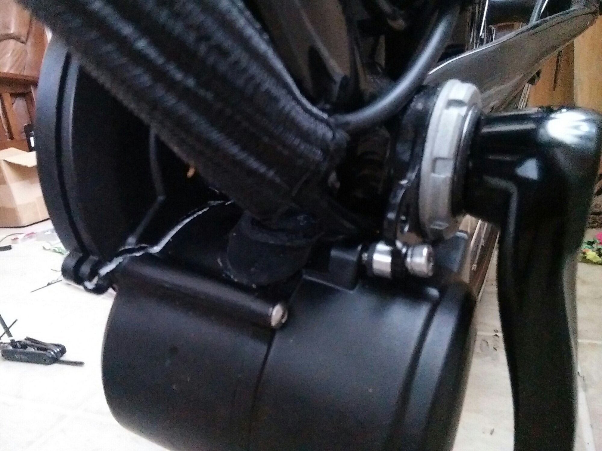

You're not alone - the TSDZ2's fixing block didn't fit my bike either, and the motor's casing broke similarly to yours (pic below).
It was fine for several hundred miles with the stock 42T chainring, but I got speed-greedy and slapped a 52T badboy on it.
10 miles into my first ride with 52T and SNAP! I think there was just too much torque without the extra bracing provided by the fixing block.
I got my replacement case from Eco Cycles - their website shows the motor cover replacement but not the case, which appears to be what you need.
Email [email protected] and ask if they'll invoice you for the "TSDZ2 Motor Case Replacement." They're usually pretty fast at responding, shipping etc.
And be careful about the torque sensor ring and three sensor springs when you disassemble!
I broke the connecting wire (2nd pic below) and lost a spring - luckily it only cost me $25 more, but had to order them separately, adding several days to the process.
After bungling the motor disassembly, I found an electric motor repair guy about an hour away and had him put it all back together again.
I wanted to be sure it was done right, with the correct grease in the right places etc.
He had only repaired one ebike motor before - a hub motor from an Organic Transit Elf - so he was stoked to fix a mid-drive!
All that for a 5mph increase in speed -
I went back to the 42T and used a super-thick zip tie to strap the fixing block to the frame (3rd pic) - better than nothing...
Another few hundred miles since and it's all good (4th pic), knock wood!
Hopefully that's helpful to you - please share how your repair experience goes!

Thanks a lot for the tip and the assembly gotchas! I thought my case fracture looked bad but yours is terrifying.
To be honest, I kinda wish I'd bought my TSDZ2 from Eco Cycles to begin with, since I followed some of their documentation back when I installed the motor. I'll reach out to them. Even if I don't end up buying my casing replacement from them, I might finally splurge on their minimalist display.

Nice to see some more TSDZ2 success stories. To clarify, the zip tie in my picture is just holding some cables. I, too, had to find out the hard way that zip ties aren't enough to hold this motor.
If you don't mind me asking, how did you get the motor to stay rotated forward even when idle? Is it just a matter of tightening the rings that go between the motor and the pedals until the motor is fixed in place?
sorry, this is the image is what I was referring to regarding the zip tie. It doesn't look to be doing anything because under assist the motor wants to rotate forward and up to the down tube anyway and resting or pedaling without assist my motor has never rotated down or back. I tighten the collar nut with the special wrench very snug.
This is the bike that my 36v 500w version is currently on. I've had it on 4 different bikes. For this one I probably could have used the stock anti-rotation bracket unmodified but I would have had to remove the kickstand and I prefer the motor housing protruding forward of the chainring instead of underneath. I haven't previously read of the housing breaking like yours and LimboJim but it is good to be aware of this possibility - I'll deal with it if it happens to mine.

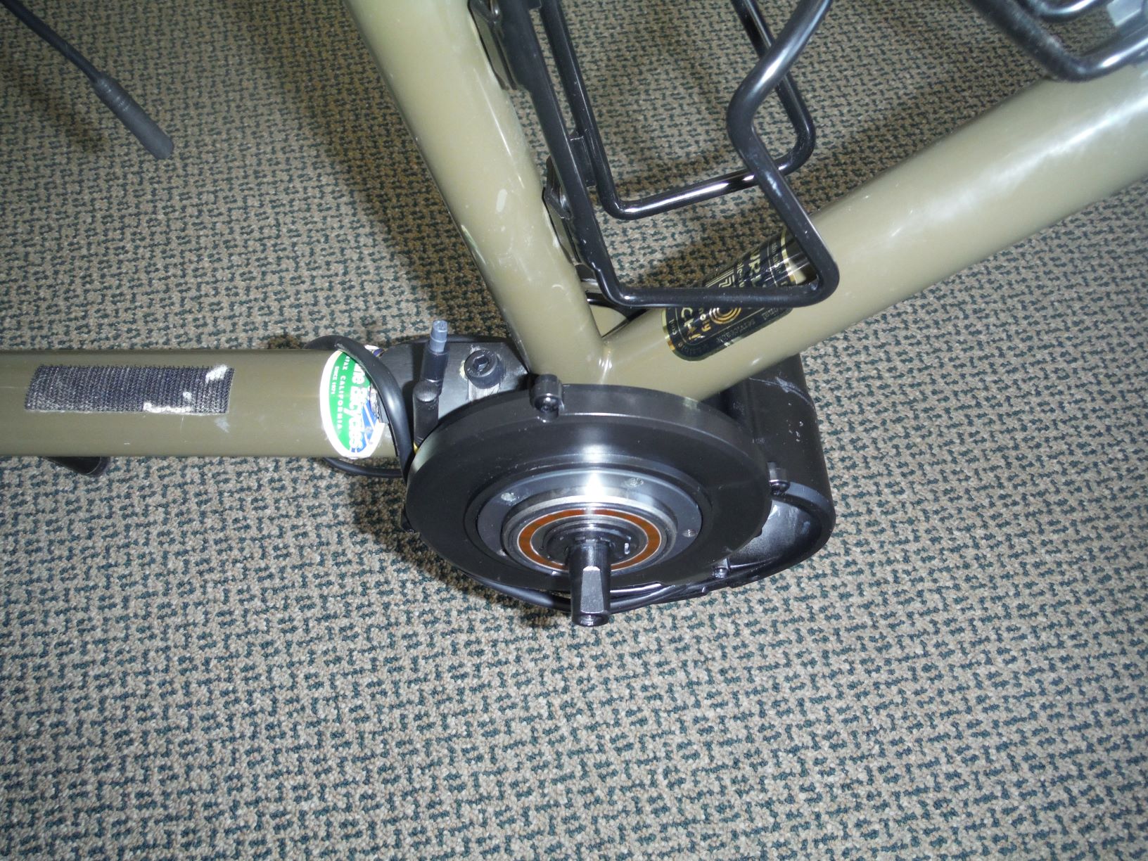

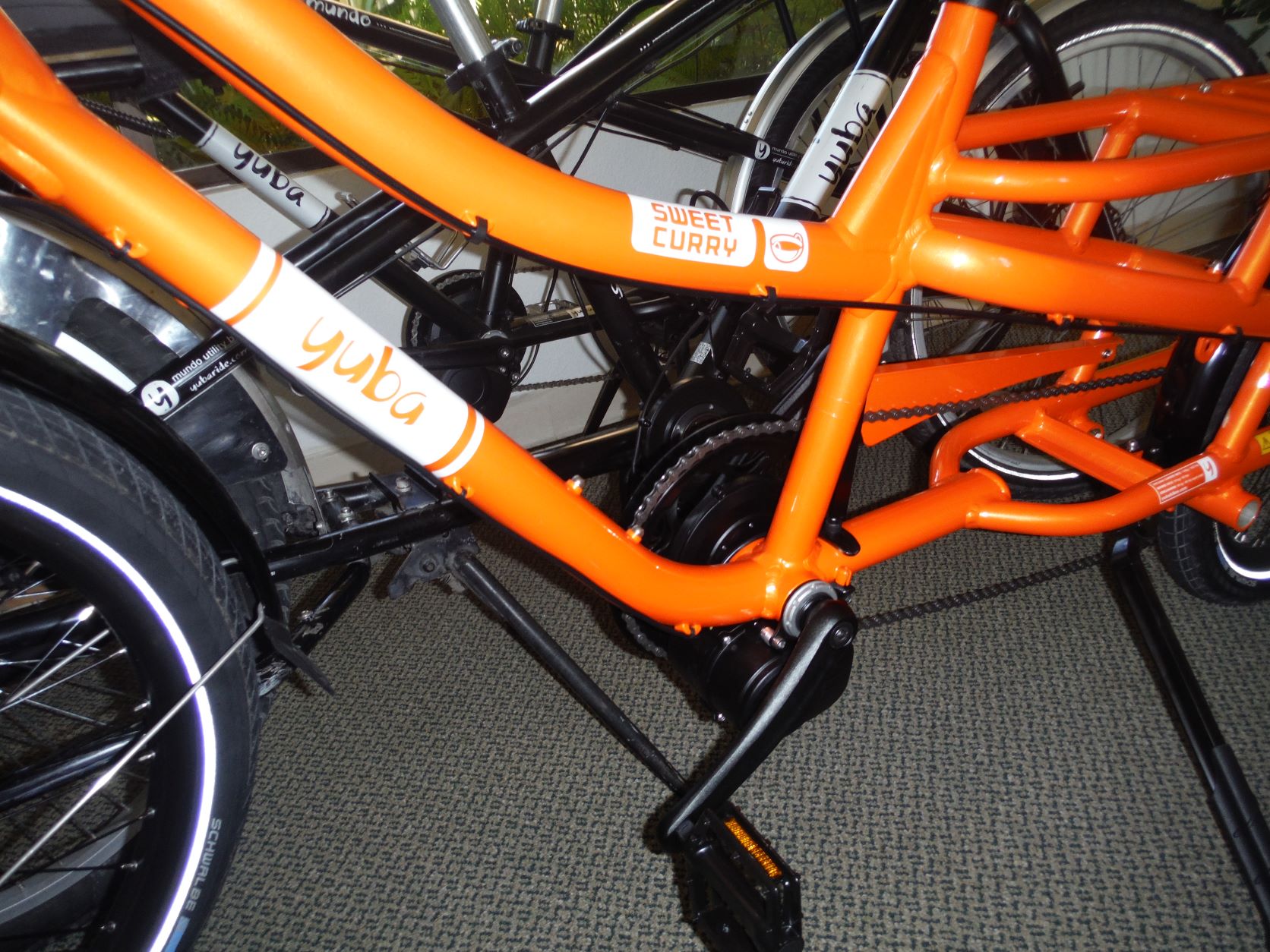

On cargo bikes I drill and reinforce. The motor must not move in the BB shell. I also use shims in side the shell. Onetime I drilled the downtube and put in a reinforced bolt to keep the motor from rotating forward. That was on a very weird one. The weird ones are attracted to me; who knows why? I don't just get recumbents which are all weird, I get the weird for recumbent, recumbents. I always use stronger and longer bolts to the block, or they will sheer. The stainless look nice but I paint the strong ones to prevent rust. I am normally reshaping the block for each bike to increase contact area. Here you will see the hardened black bolts behind the seat tubes.
