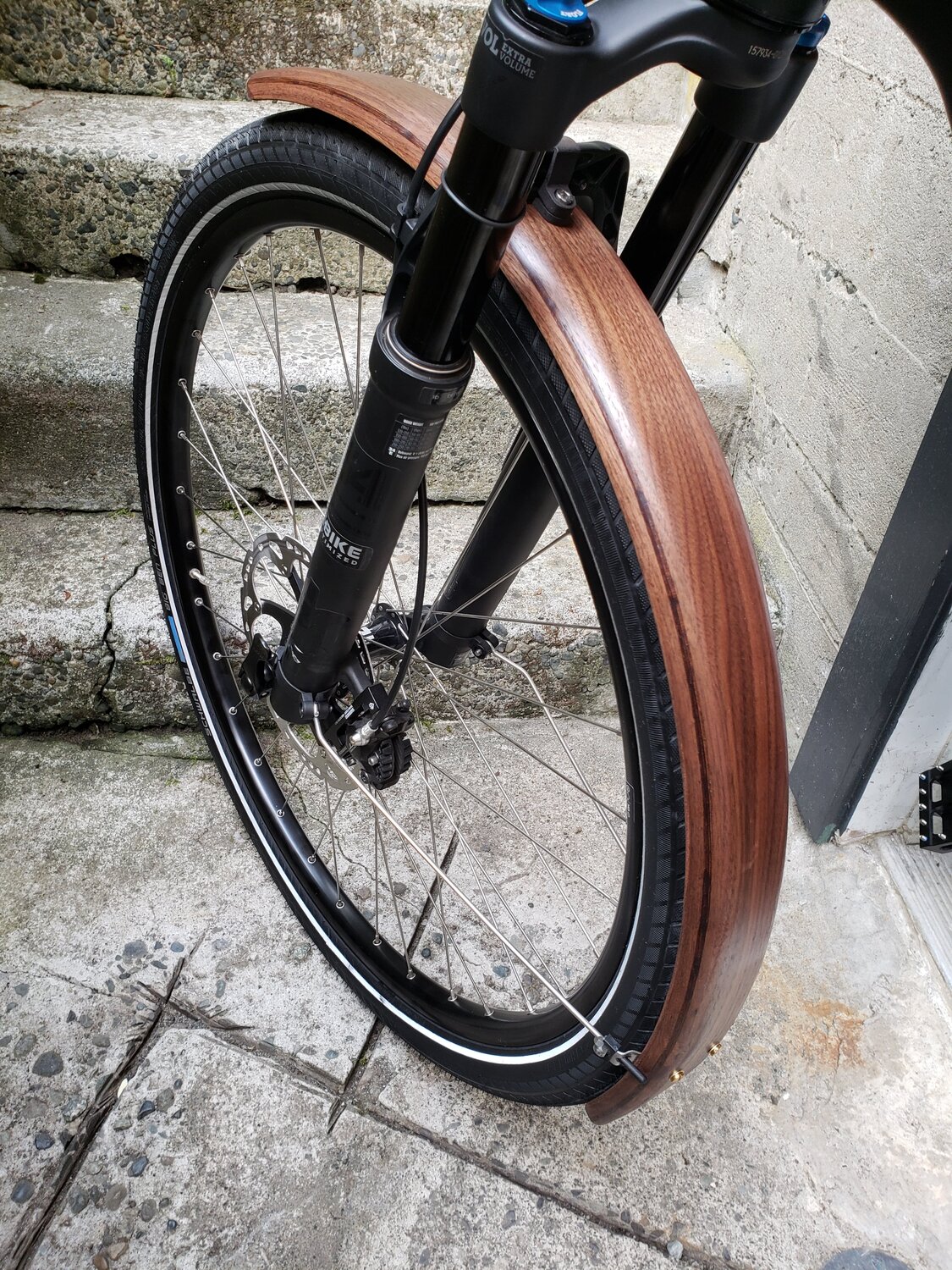

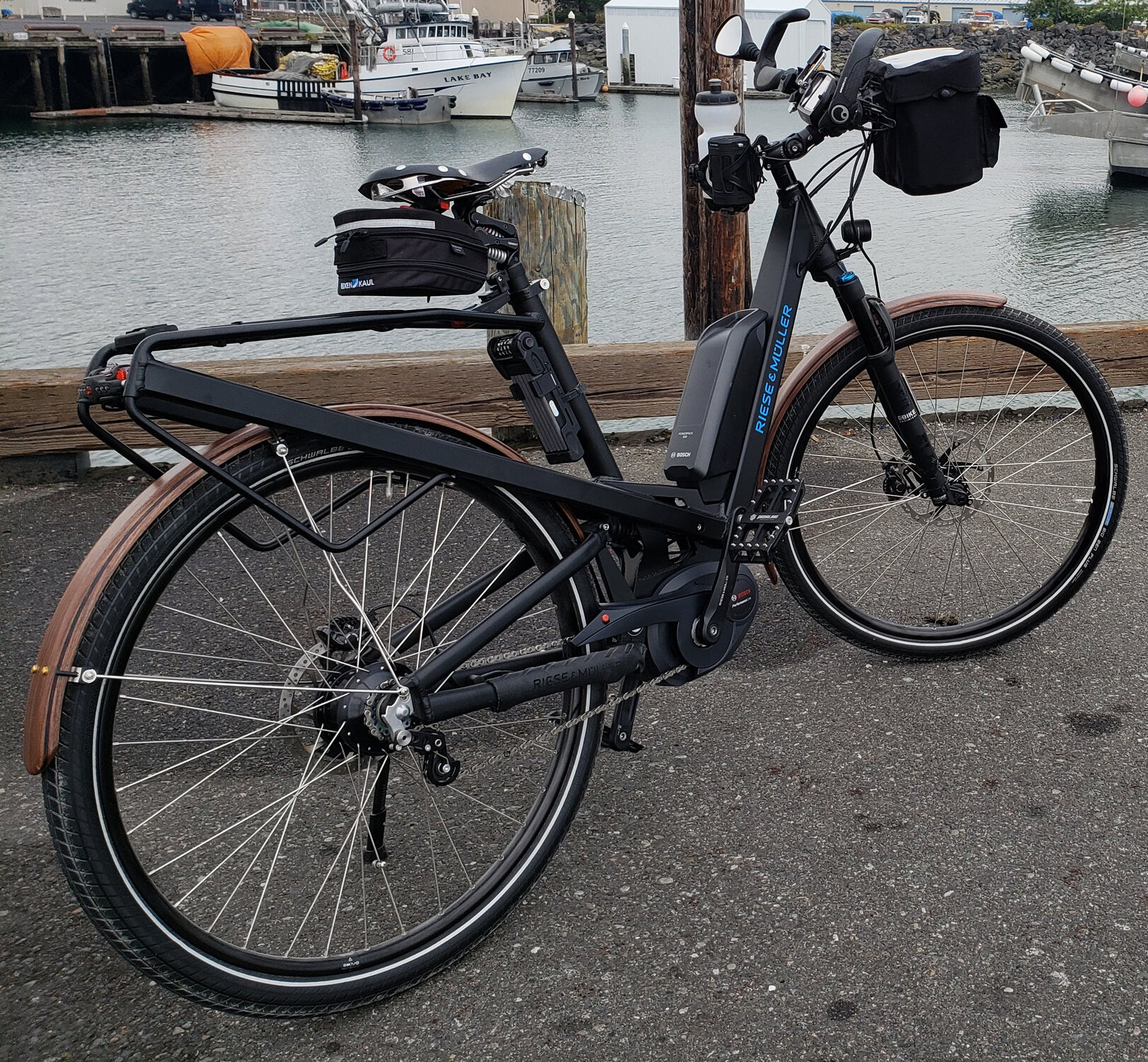

The finished bike.
A couple angles of the new wheel and drivetrain.
