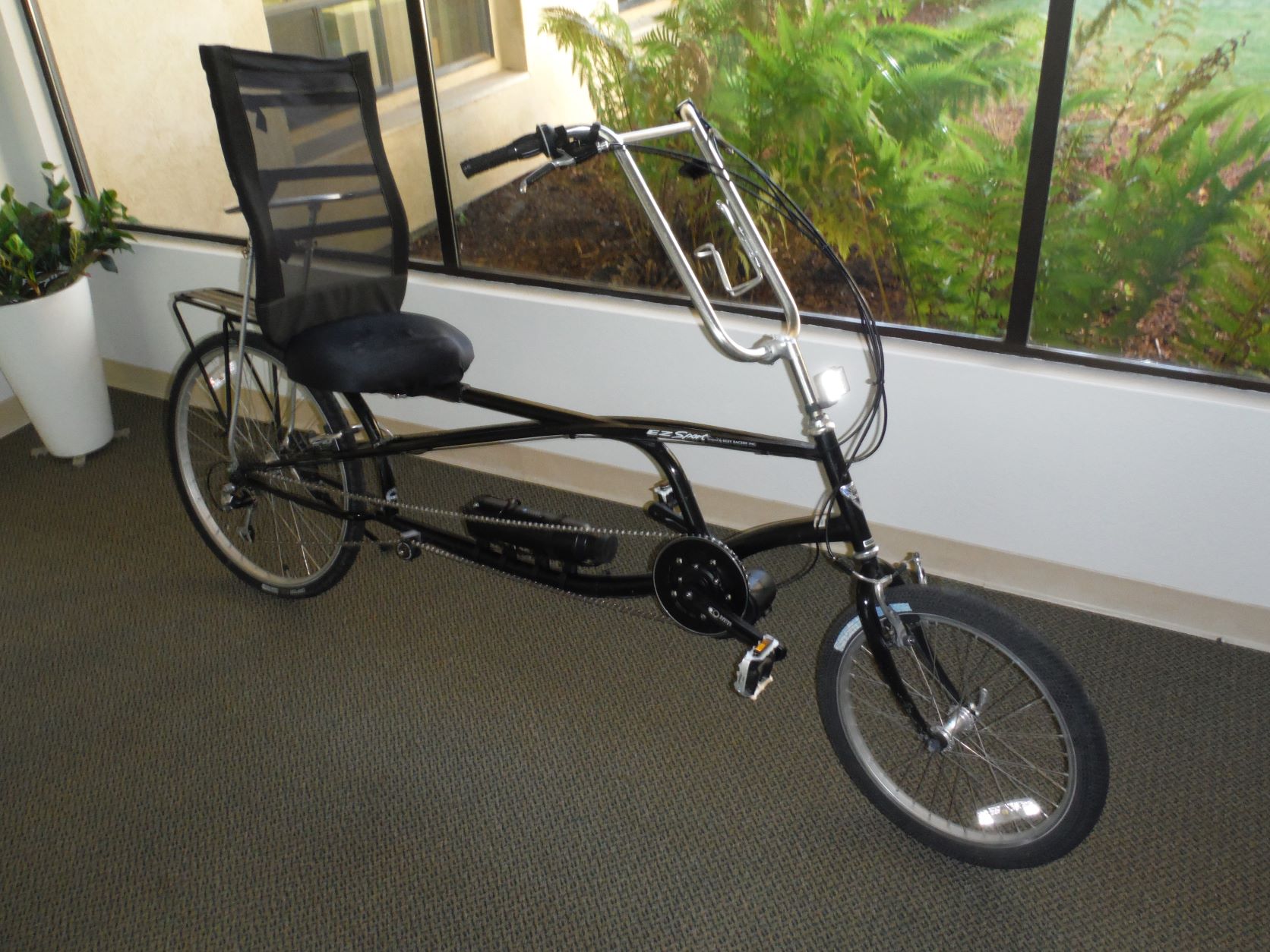

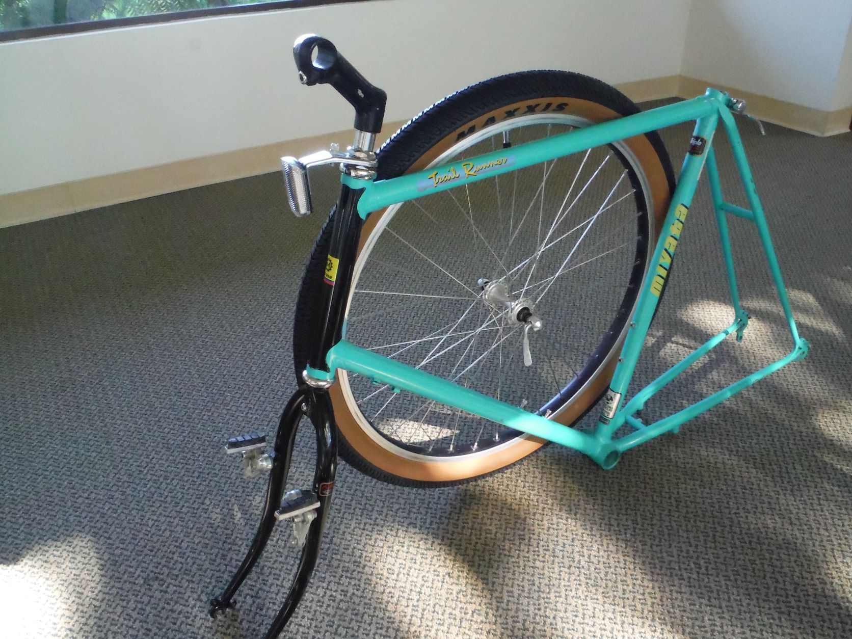

These are the ones I am working on now. A recumbent and classic triple butted, lugged, Japan chromoly.
As @tomjasz knows Bionix was a rear hub from a former generation of bikes. I get asked to remove them because they are no longer supported and die. The TS mid is a reasonable upgrade option for some of these applications. @ultra_deluxe cracked the shell because it was locked down on only the left side. The torque was then all on the right. The block supports the right side but the chainstays were too wide and the block was not extended by 7mm with a plate. It is lighter than the 8-fun but needs full secondary reinforcement on both sides of the motor's shell.
