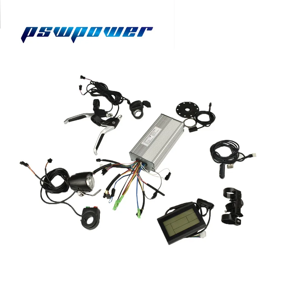

I would offer that the KT based controllers and displays have a pretty good reputation, are able to be configured pretty easily (especially when compared to a CA), and will give you all the control you're looking for when it comes to setting up your PAS.
Check out something like this:
Note that even though you already have most of the necessary accessories (like a PAS sensor or brake levers w/cut off for instance), this supplier offers them super cheap, and they'll have the correct ends on them, allowing you the choice between plug and play using their stuff, or matching your existing. There is no doubt you'll need to match the battery connector to controller (look into a pair of XT60 or XT90 connectors). That will leave you with just the motor connections to figure out. They can be a challenge, but most DIY'ers get through that step OK.
This supplier (pswpower) has been around a while, has a decent reputation, and I've used them several times. -Al

The CA display, and a compatible controller, is going to give you all kinds of control, no doubt. It may be a bit much though.
I watched some videos of the KT lcd3 & lcd8 displays and there is definitely more settings than I have now, but it doesnt look like there is a big difference. The main setting I saw that changes power to assist levels is just a 1-2-3 setting with default being 2 and 1 lowering power and 3 raising power. Am I wrong on those? Do you reccomend any particular KT displays or any other displays that may have more setting? I would love to find one that allows precise settings to each different assist level or something similar.
I like the LCD3 as it's relatively small and does what I need it to do. Not into big flashy displays. In addition to the 3 power assist levels, there is C-3 I think, that lets you select if the PAS levels will be based on speed, or "imitation torque control" (watts). There's also the ability to limit max wattage going to the motor (C-5, 8 levels). Nice if you're running a big motor, and would like to limit the amount of power available to keep wide open power usage reasonable, or possibly mileage/economy reasons).
If you want the max amount of customization, the CA3 is going to be tough to beat. Little doubt there. My point was that it may be over the top, and would add the display is pretty big.
