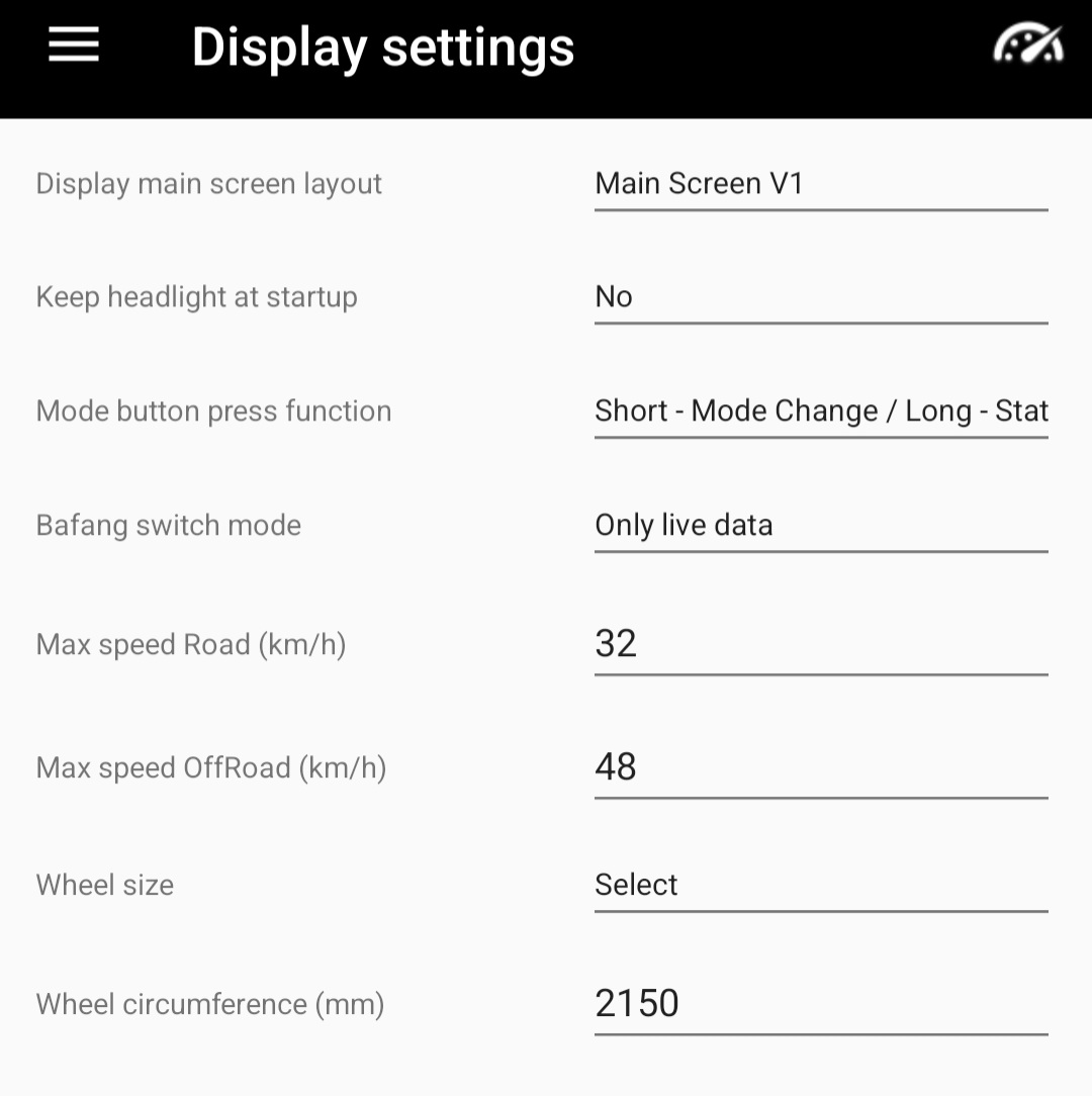

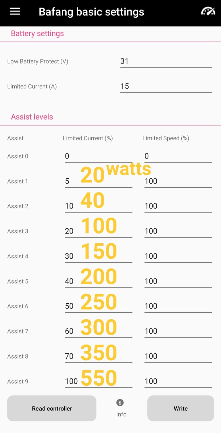

Don't know what the compatibility is with your bike, but for mine (Ride1UP Roadster v2) I was recently able to get a supposedly "unsupported" aftermarket LCD display to work with it, and allow FULL programming of PAS levels/output, assist speed limits, etc. I took a chance, and it actually worked. It's the EggRider display (from the UK). Even though the rear hub motor is not a Bafang, it worked when the display was set up as a Bafang.
In my case, I was able to change 5 PAS levels to 9 PAS, customize the power output (current) at each level, and even set the maximum speed at each which assist drops off. I posted my findings at https://electricbikereview.com/foru...lster-aftermarket-improved-lcd-display.50253/
Love the EggRider! YRMV.
