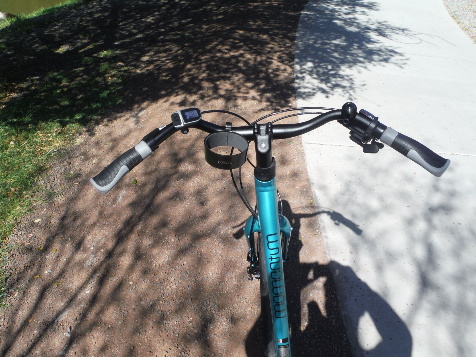

@Nvreloader, thank you for the link to the very useful whatbars.com interactive chart. If you compare the Jones Loop Bar (aluminum, 710mm) to the Velo Orange Granola, they have similar sweep backs. The Jones is 45 degrees while the Velo Orange is about 55 degrees, as you noted. The Jones does have the standard 31.8mm clamp size you need.
I use the Jones H-Bar (Loop) with 2.5-inch rise in both my ebikes. I like the bars very much. They provide multiple hand positions for relief during long rides, and also have a lot of room for accersories such as lights, bell, iPhone mount, GoPro camera mount, etc. The 2.5-inch rise also helps if you want a more upright position.
You probably already know that you can raise the handlebars further with a stem riser or stem spacers, provided your brake and shifter cables are long enough.
Good luck and I hope you find the handlebars that are comfortable!

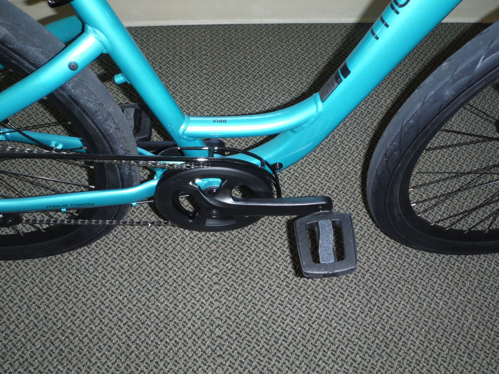

For me crank forward AKA flat foot frames like the Townie and KHS Smoothie solved my pain issues. Sitting upright without pressure on my hands and not having to bend over like conventional frames.
Al

Don, the distance is 4¾ inches or 12 cm., as best as I can measure. I have Ergon grips installed with a mirror on the left and handlebar cap on the right, so I cannot really see the ends of the 710mm Jones H-bar.
Note that the whatbars.com chart shows the handlebars on a square grid. The bold lines appear to be 10 cm. apart, and the faint lines seem to be 1 cm. apart. If you go by that grid, the distance is about 13 cm., which is close to what I measured.

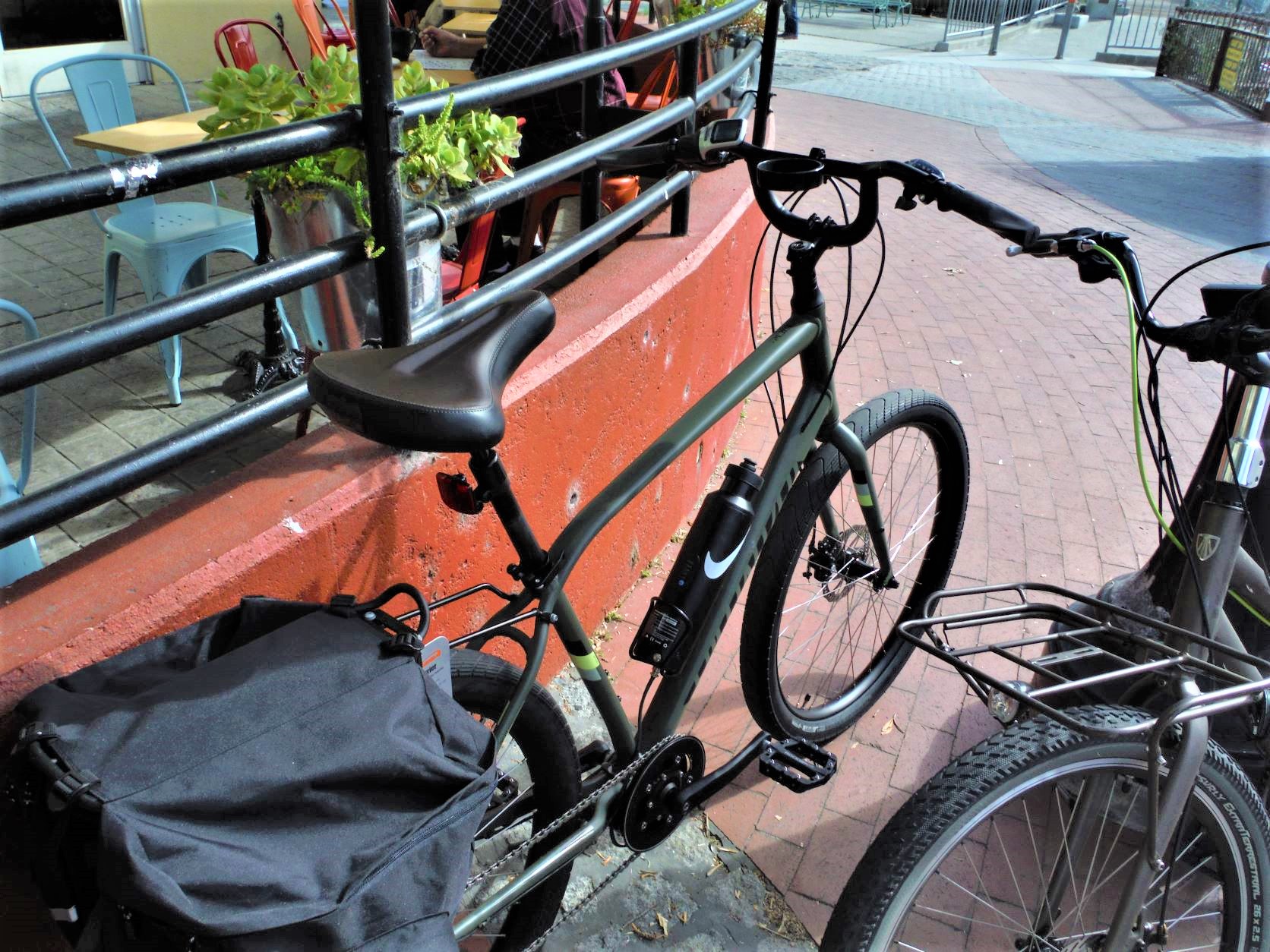

I had same issue with hands going numb and shoulder pain from having to lean too far forward while riding on one of my ebikes. I purchased some swept back HB's as well as an adjustable stem. The adjustable stem took care of the issues pretty much and I was able to use the original HB that came on the bike. I replaced the grips with Ergon GP-1 grips and everything is fine now. I was able to to adjust the stem angle back and up to get the HB farther back and a bit higher than stock. This is the adjustable stem I used:
