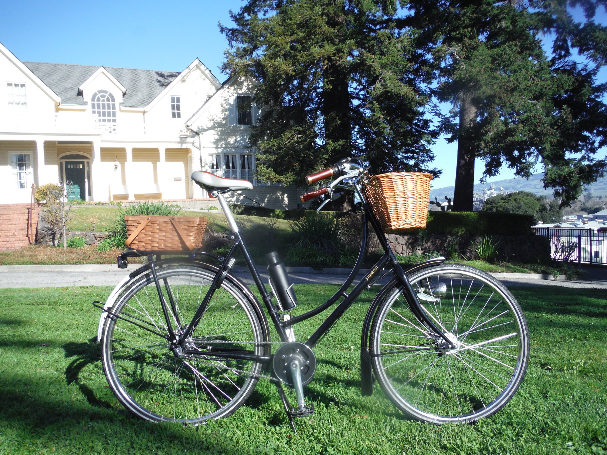

As for weight distribution. High performance aggressive racers will want even loading between the tires. But the Dutch ride bikes every day as transportation and want comfort. They know about an upright position with high backswept handle bars and a ramrod straight back. Humor Disclaimer: The final photo is for entertainment value only. The first bike is electric.
