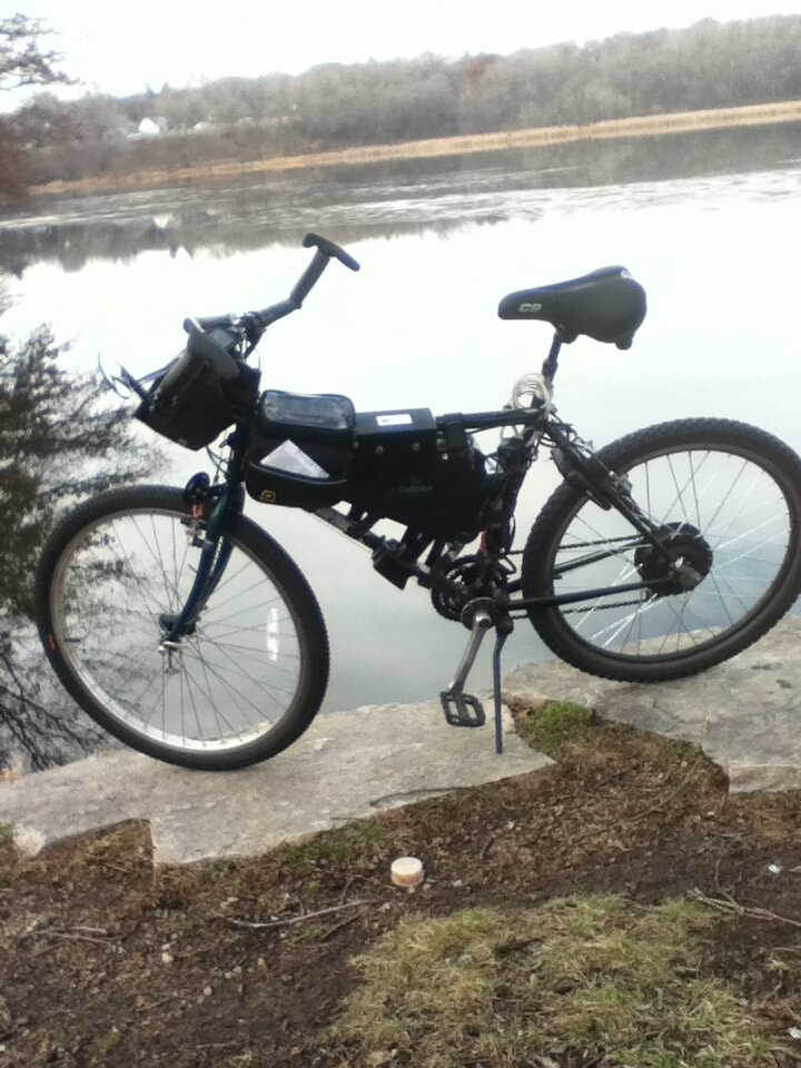

Had the same problem with my Trek. It was cutting into my ride time, wrists, shoulder and neck pain during the rides and stiffness after riding.
I put considerable time into making the bike a cruiser without going hog wild on parts and work.
Ended up with a new seat, post spring, handlebar extensions (4).
Now I can ride with a much better posture and little if any pressure on the wrist shoulders and neck and the seat post spring allows me to ride through most bumps and holes.
