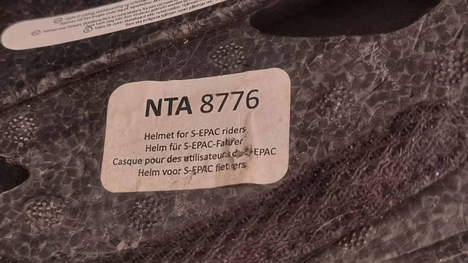

This might be too late but... If you plan to go faster than 15 mph, get a NTA 8776 certified helmet for speeds up to 28 mph. The regular bike/skate helmets don't cut for e-bike speed.

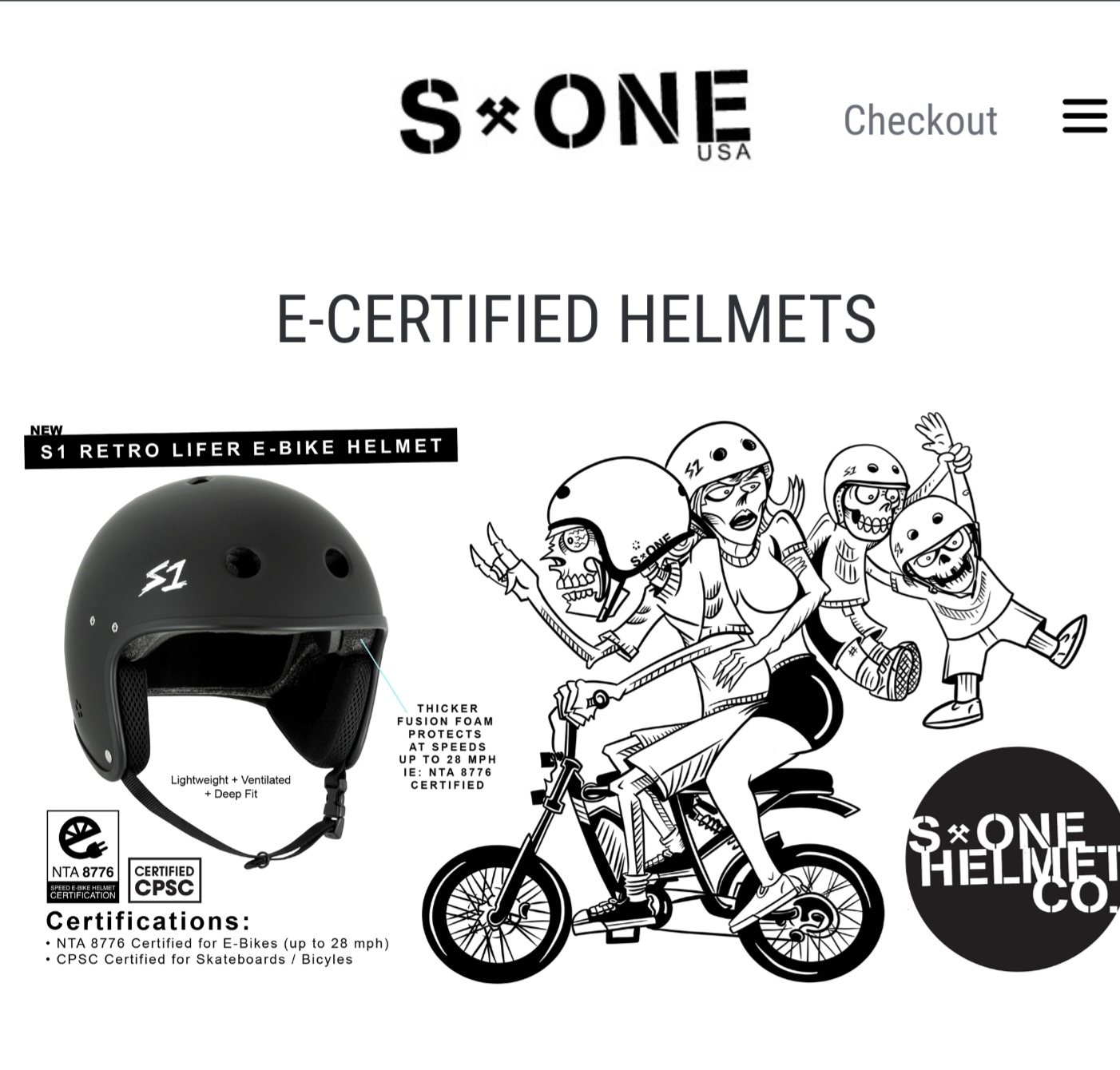

Our brand S1 Helmets, just came out with a new e-bike NTA 8776 helmet https://shop.s1helmets.com/e-certified-helmets/ (a Gardena Brand).
Other brands are slowly bringing those beefer helmets too, we just need to educate more riders about the need for thicker helmets for e-bikes.

To be blunt, a helmet like that would be a disaster on a hot summer day. For a cyclist who is pedaling, at least. Ventilation on those helmets is horrible. If you are riding a Super73 and you ride it like a motorcycle, fine. But someone exerting themselves riding a bike like a bike requires ventilation. NTA8776 is a Dutch standard that I am sure is technically effective at meeting its local regulatory goals, but not any sort of requirement for USA helmet use.

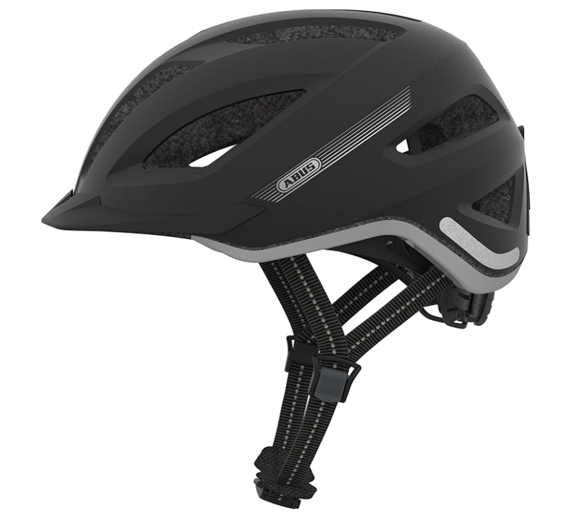

Abus Pedelec + High Speed Bicycle Helmet (NTA 8776). I own one.
It is lightweight, well ventilated, includes integrated rain-cover and the blinking rear light. Nothing wrong with the Dutch standard.

Certainly there's nothing wrong with it... but looking at the way the standard was presented in the advertisement post, it gave a false impression that the standard was more than it is.
I looked at other NTA8776 helmets and they had a similar no-ventilation approach. It looks like Abus had the expertise to design a helmet that does not suffer from that extreme handicap, shown in all its glory in his screenshot above. Spelled 'bicycle' wrong, too.
