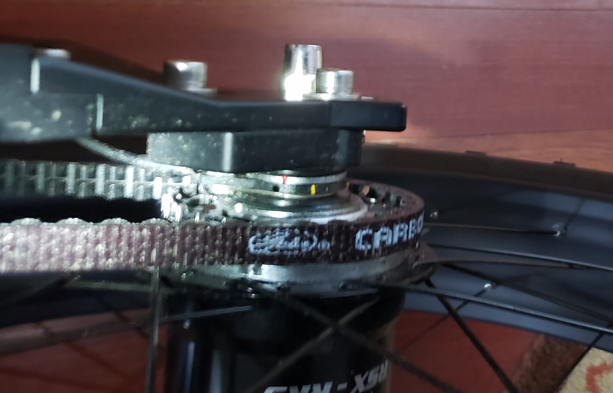

Thanks for the info fellas and I have already reviewed those videos and files referenced. The image below is the relevant info from the SA documentation ( the difference being that procedure shows a chain vs a belt drive). Since I have the red and yellow marks it should be a vertical dropout. The marks are nowhere near each other in 2nd gear. 5th gear is the closest they get as illustrated in my photo post on this. The bike is shifting correctly now so I don't feel adjustment is necessary. I was just trying to prepare for the inevitable future adjustment requirements. For now, I made a green mark next to the yellow line in 5th gear. The SA IGH is a pretty simple mechanical device and logically, if the cable stretches, it should show up with the position of these two marks with the bike in 5th gear. Again, the SA IGH is working perfectly so there is no rush on this but clarification on a working procedure is needed as this is a necessary maintenance function. This will be a much easier process when there are more than 2 owners posting here. :)
I'm going to call Sturmey Archer customer support tomorrow and try and get confirmation of my improvised procedure. This is one of the disadvantages of not buying from a dealer or a company like Biktrix. Of course, Biktrix doesn't offer the belt drive so the point in this particular situation is moot. For me it's worth having to do some digging to find answers to what should be simple questions. YMMV.

Yesterday I got caught out in a drizzly rain and cut the ride short to 25 miles. I tried Sport mode, unlocked the controller speed limit and there was a noticeable jump in power but it was always smooth in it's application. The bike continues to impress with it's handling and in particular the IGH. I am very careful to stop pedaling when shifting and very seldom use throttle so it has been smooth and solid shifting every time. The 5 gears are more than enough with 1st and 2nd able to handle the steepest grades with little pedal effort and it certainly gets a lot of looks and comments as I ride (all positive so far). The one oddity is the IGH adjustment marks. There are clear red and yellow lines on the IGH with the closest alignment in high (5th) gear. They get farther apart as I shift down so I have no idea which is the index gear. Since it is operating great now, I'm not too worried about it but the cable will stretch and it would be nice to know the index gear and mark the ideal position as was demonstrated in the Biktrix SA IGH adjustment video. Honestly, I would prefer the twist shifter used in the Biktrix video vs the supplied trigger shifter. That is something I will consider as an upgrade in the future. Here is a photo of the IGH marks as described.
i those marks are for if it’s set as 1 thing or the other. You can use the IGH for a few different set ups I can’t remember exactly what they are. Something else I looked through also but can’t remember exactly what it said. It’s online though so you may find it too as that’s how I found it. Red for one yellow for the other lining up with the yellow on the other side. Mine has a hand scratched mark that’s in between to two that lined up when it’s in 2nd gear. Cable stretching should be able to be sorted from the wee nut the cable goes through as it enters the trigger shifter. I gave mine a quarter turn one way or the other after a few miles and it sorted for the cable settling. You may or may not have to do it. It’s on this thread somewhere. I have my shock at 90 PSI and the rebound almost in the middle with a couple extra click towards +. I’ll prob just change that on the fly if I’m on the road or off road. I’ve found the PSI of the tyres really affects the ride but I’ll play more when we get better weather here. It’s like an ice rink outside just now and dark at 4 pm ish. Have a closer look on the moving side of you IGH, you may have a wee scratch mark too or it may just be whoever built my bikes way of setting it up. I’m sure for adjusting you start in 2nd gear then click through to 5th and adjust if needed and then repeat and so on till it trues up. Real happy your getting some pleasure from your bike now instead of sore heads. Get them miles in brother! 👍
