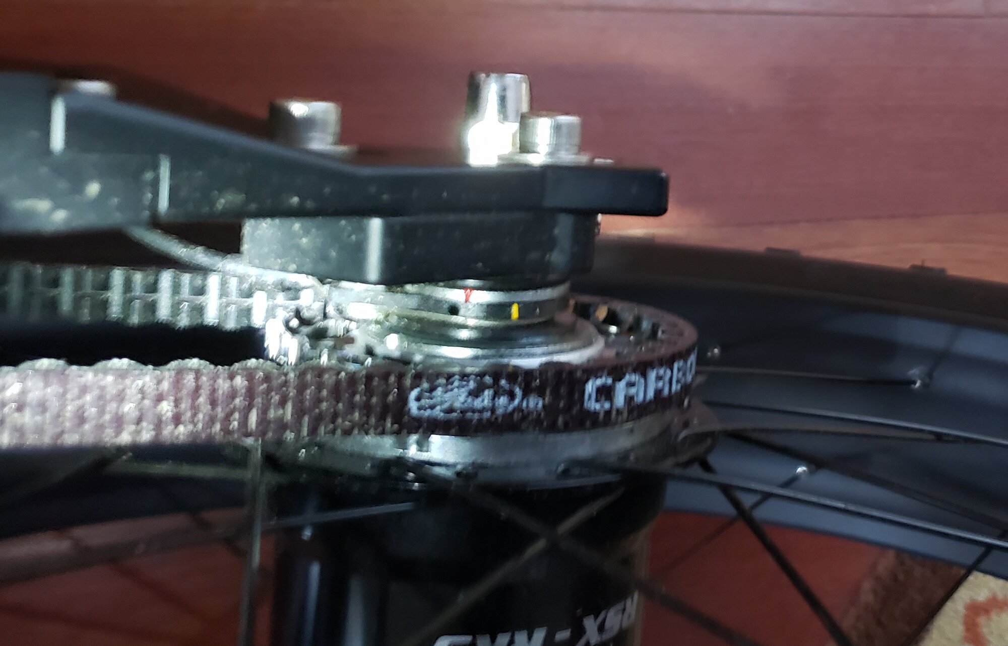

Yesterday I got caught out in a drizzly rain and cut the ride short to 25 miles. I tried Sport mode, unlocked the controller speed limit and there was a noticeable jump in power but it was always smooth in it's application. The bike continues to impress with it's handling and in particular the IGH. I am very careful to stop pedaling when shifting and very seldom use throttle so it has been smooth and solid shifting every time. The 5 gears are more than enough with 1st and 2nd able to handle the steepest grades with little pedal effort and it certainly gets a lot of looks and comments as I ride (all positive so far). The one oddity is the IGH adjustment marks. There are clear red and yellow lines on the IGH with the closest alignment in high (5th) gear. They get farther apart as I shift down so I have no idea which is the index gear. Since it is operating great now, I'm not too worried about it but the cable will stretch and it would be nice to know the index gear and mark the ideal position as was demonstrated in the Biktrix SA IGH adjustment video. Honestly, I would prefer the twist shifter used in the Biktrix video vs the supplied trigger shifter. That is something I will consider as an upgrade in the future. Here is a photo of the IGH marks as described.

I found a video on YouTube months ago and I think they said that those marks should align in the second gear. I will try to find the video and confirm that!

Here is another video I just found. It is not the 5 speed hub but it should give you some understanding how that works.
I will still look for the one with the same hub as on MD1000

I think it needs to be aligned in 2nd gear. I attached a manual from SA website.
