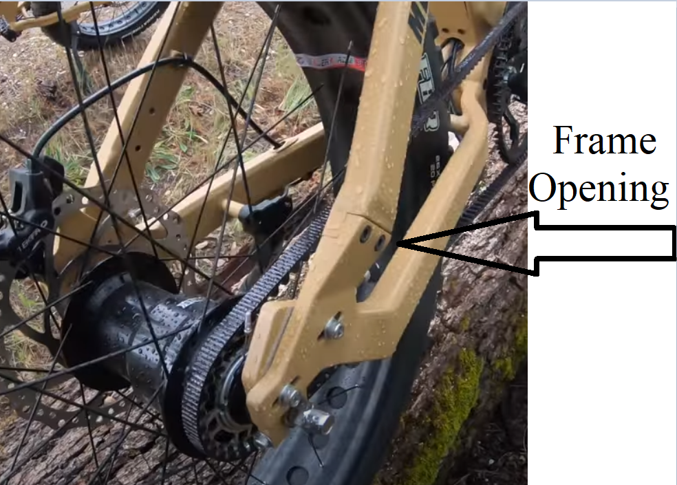

All of the MD-1000 frames are set up for a belt drive, correct? In other words, if you order one with a chain and derailleur it will still have an opening in the rear triangle.
From cyclingabout.com:
You Need A Belt Compatible Frame
As belts are one-piece, your frame will need to be designed with ‘belt splitter’ in the rear triangle. The frame will also need to be ‘stiffness test approved’ to ensure the belt cannot wander off the rear cog. When the rear triangle is particularly stiff you can actually run less preload tension on the belt, which results in less drivetrain resistance.
If this is true then you could convert to a belt-drive down the road when there is an affordable solid IGH designed to handle the big torque Bafang M620.
I believe you are correct about the rear triangle frame opening on the belt drive MD's. This allows for changes to the belt and or IGH. Of course you could also switch to a compatible hub and chain groupset.
Note that the frame for a belt drive must also allow for the belt to be tensioned properly. The axle will need to mount in a horizontal slot vs. the more typical short vertical slot.
