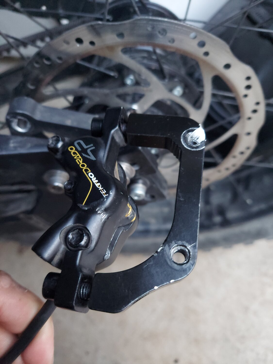

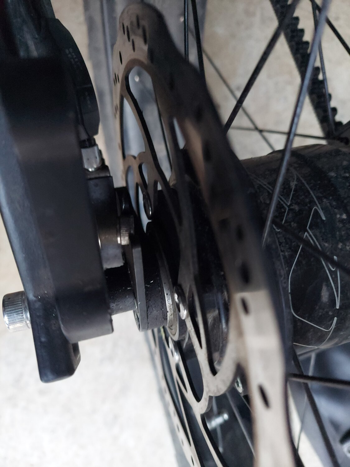

Does anyone know what size rotors these take are they 203mm? I bent my rotor and snapped the rear brake adapter last week. Curious if anyone knows where to get a new brake adapter as well and spacers? I was thinking bikonit instead of reaching out to the supplier. If someone could please take a picture of their bike I would be curious to see how the adapter attaches to the bike since my spacers fell off on the trail.
Thank you
Thank you

On my Wart Hog MD 750, bought in Dec 2021, the rotor size is stamped on them,
take a strong flashlight and check both sides, mine are stamped 203-16, right down next to the axle.
HtH's
