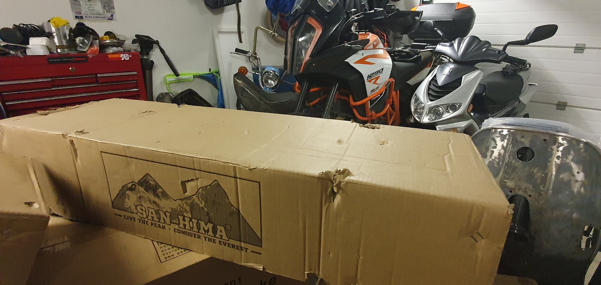

Hello. I live in Iceland. I am new to this forum. I have been watching it from the start. Some of you guys were talking about a bike rack for your cars. I just got a rack last week. It is built to hold a motocross bike. It takes two electric fatbikes with ease. I think this is the way to go with the fatbikes.

What's the name of this rack?
That looks good Bigjoe, do you have link to purchase this rack? Looks like they are made in Australia so unless they have distribution in the US shipping will be more than the rack.
Sorry no link. I bought it in Iceland.
The company seems easy enough to get through to. A quick call should get you all the info you’re after. RMK has had plenty of practice with that the last wee while due to Leili’s master shipping efforts!
Should be a breeze brother Lol
