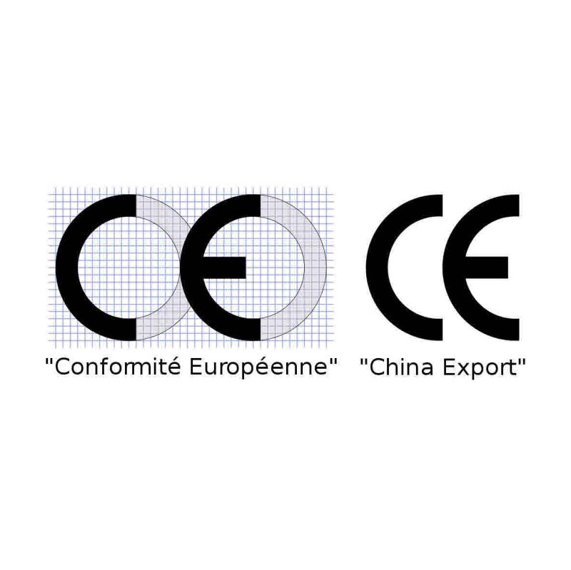

One thing I wonder about is fake certifications. I've bought a lot of electronics on the semi-gray market and there were a lot of things I bought that were in no imaginable way up to standard yet they had all of the UL and CE certification labels. For me, not wanting to wear my electrical engineer hat all day is reason enough to stick to name brand battery and charging systems. Although there will probably be fakes even of those...
Thus the problem, labels can be fakes also. I tend to buy electronic products from companies that have something to loose if there is a serious problem. I wouldn't trust online companies with names like Lim Ho, LTD (made up name).
Someone I know who is involved in safety certifications wrote to me about CE label.
Note that CE label doesn't mean much on hardware piece and I would much rather trust UL or CSA.
Please rease below..
I get this question a lot from startups on where and how you get CE "certified". CE is short for Conformité Européenne(French for European Conformity). It's a sticker/symbol placed in your hardware product to let the user know that you are conforming to all directives by the European protection standards. So as a rule of thumb, if your product is marked "CE" you can freely sell your product in the European Union. This is NOT a certification mark. Please understand that.
So back to the question how do you get it? CE is a self-declaration process, meaning you as a manufacturer can put the CE logo on your product. Once it's placed on the product, it's assumed that you as a manufacturer have taken the effort to test all the relevant directives and have passed all quality and safety standards mentioned by the EU. The onus is on the manufacturer, they can slap a logo on the product and not have done any of that. Therein lies the problem of CE, where people think just because it's marked as CE means that the product is of the highest quality. Again, CE is not a Quality or Certification Mark.
In a proper workflow, if you need to affix the CE symbol on your hardware product, you need to create something known as a Technical file, which details all the product specifications, test safety reports, standards compliance reports, instructions of use etc. This document is to be produced to EU authorities when asked for or when a dispute is raised. You can be penalised if your product doesn't adhere to some standards which you may have missed. Then there is a document called Declaration of Conformity which is an undertaking mentioning that your product adheres to a list of EU directives. This is to be signed by some person in your company taking ownership saying these standards are met.
When you do put the logo on your product, please make sure that you follow the CE Logo's standard design guidelines. There is a myth floating about that the China Export logo is a similar logo found on products shipped from China and you should look at the spacing to ascertain that it's an actual CE logo. Actually, a logo like that doesn't exist. I don't think it's hard for any manufacturer to adjust the spacing on symbols to fool you if they want. Just because you see CE in a product it doesn't mean anything. Always remember that.

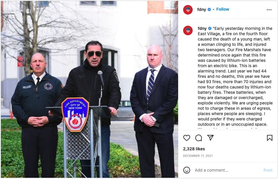

A little context to the most recent article on "ebike" fires in NYC.
There's going to need to be a strong education campaign. I'll bet 99% of the content in this thread would go over the head of most of the general public.

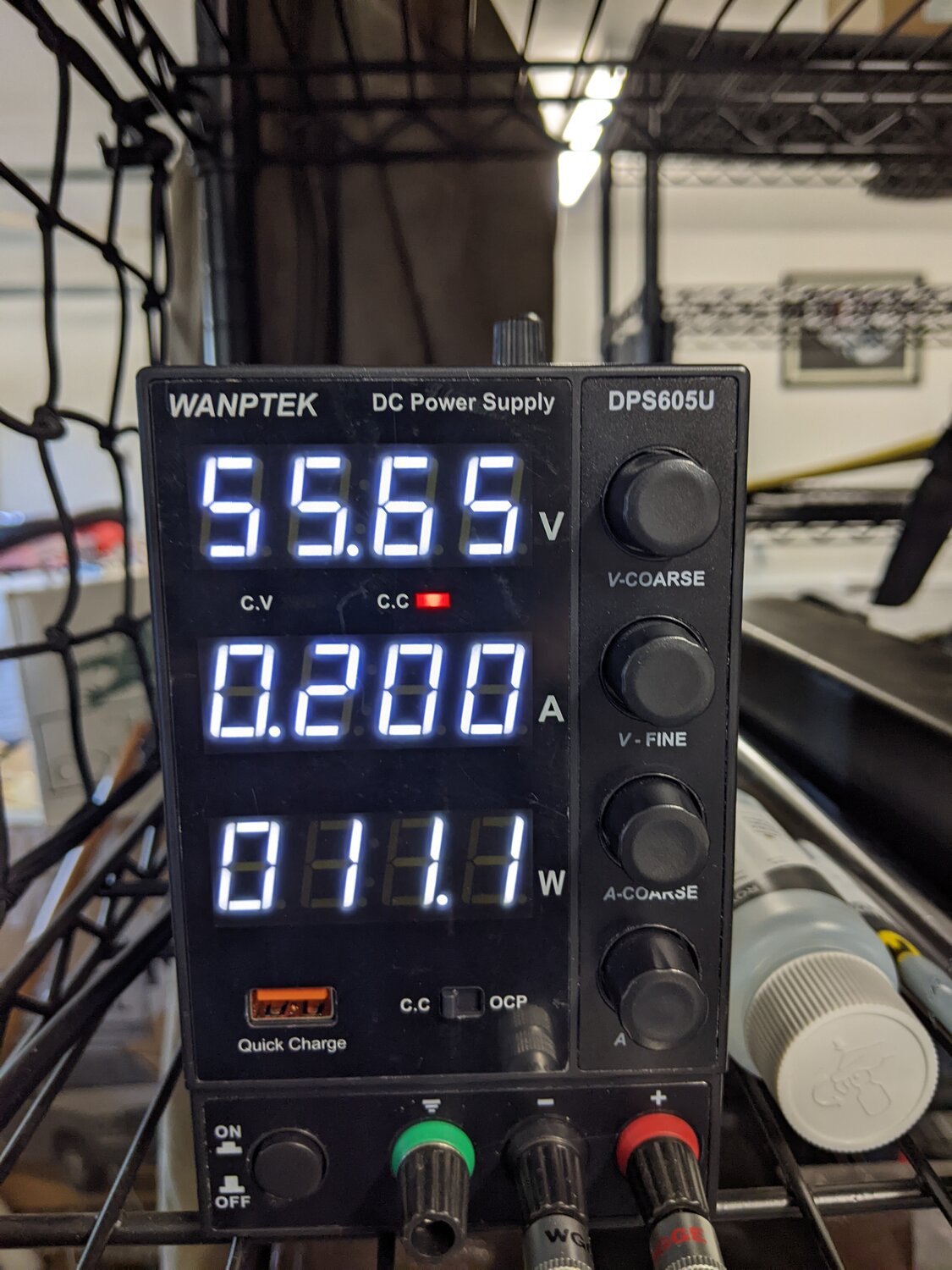

Ok now I am terrified. My new Luna on the way. Should I charge inside the bike or take the battery out? I live on the beach so I’m wondering if Salt air going to be an issue. It seems like charging on the bike would make the battery much hotter. Any advice appreciated.
It shouldn't matter (heat). I would, however, charge at low amperage on general principles. Which Luna is it?
Its never going to hurt to take the battery out of the bike and charge it separately. I personally never do. I ride bikes daily-driver style and that means with that kind of frequency, its not practical to be fussing around with pulling the pack, placing it in a bunker etc. etc. Last night I charged my 32ah Bullitt battery overnight in the bike. But I also charged at 0.20a (thats one fifth of one amp). So I was only putting out 11 watts. this morning I increased it to 1 amp for the remainder of the 12 hour charge cycle, followed by 4.5a for the last hour or so as it topped up (and ramped down the amp rate) to a peak of 58.8v at which time (which is after I finish this post) I leave for my ride across town.
I am of course also using a 12-hour manual cutoff timer but in this case I'm charging so slow the 12 hour charge time is not enough to overcharge the pack - not even close.
