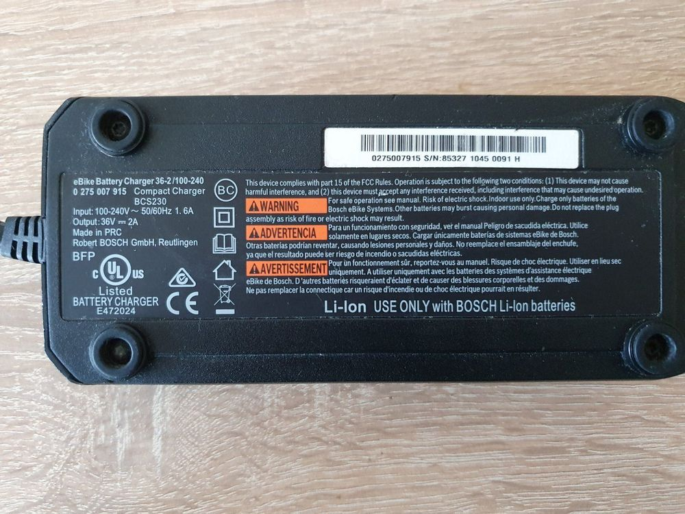

Is the CE/UL certification number normally indicated on the battery?
Yes, UL-certified chargers and batteries have signage on the device. The certificate number can be obtained by the manufacturer but you will often see something like this.
This is one of the Bosch chargers. You see both UL and CE certifications. It is important that the battery has rigorous testing done to prevent life threatening events like this. If you have toddlers or kids, it is even more imperative to use safe, certified equipments.
