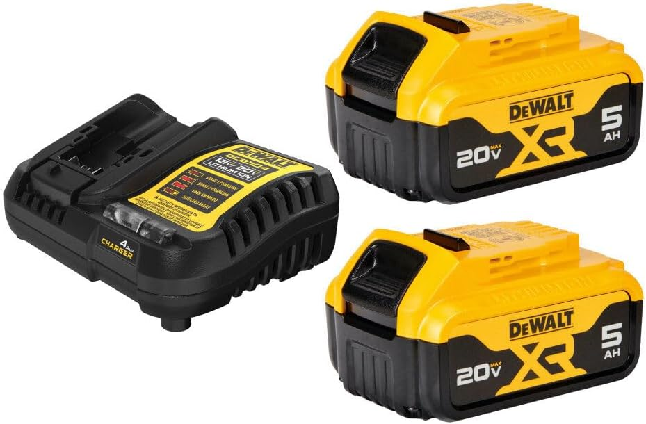

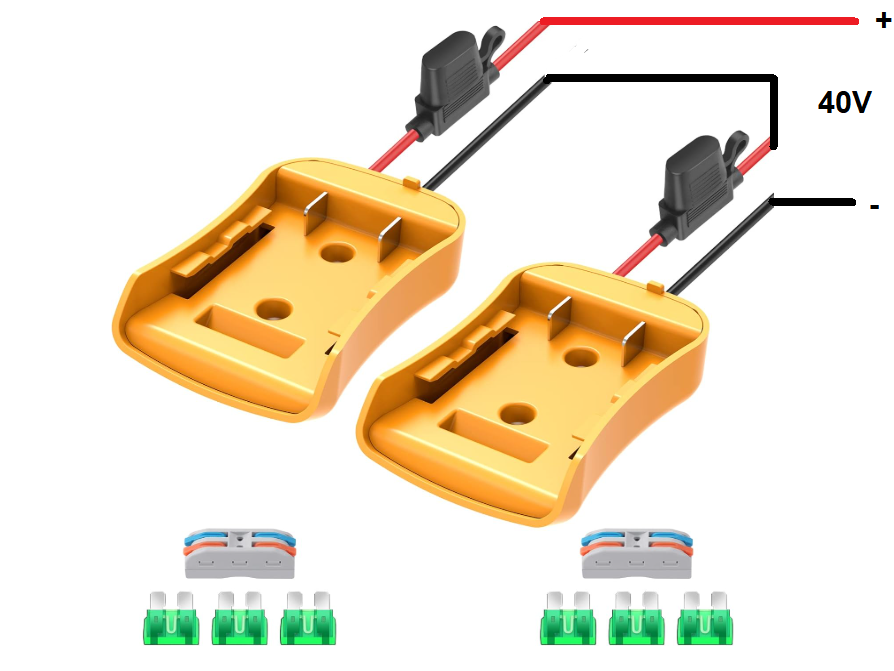

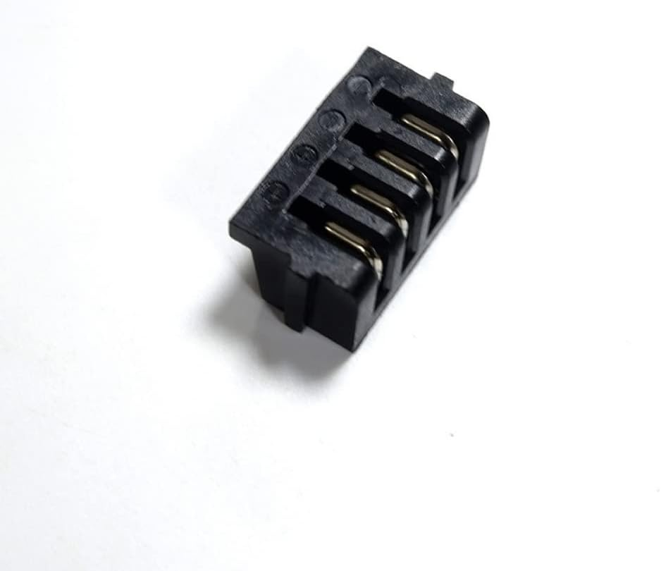

If you're serious and want to try it, you could use two 20V 5AH DeWalt tool batteries in series to give almost half the capacity of the 36V 6010 battery.

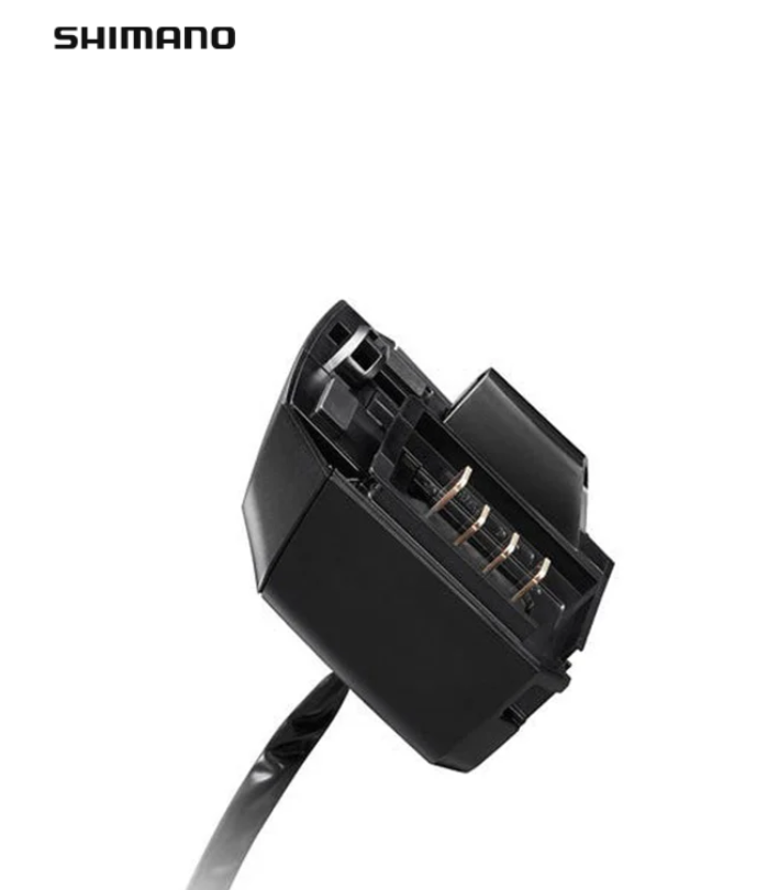

If your battery mount on the bike looks like this and the distance between the pin centers is .25",
You should be able to use this 4 pin female connector wired to the DeWalt tool batteries:

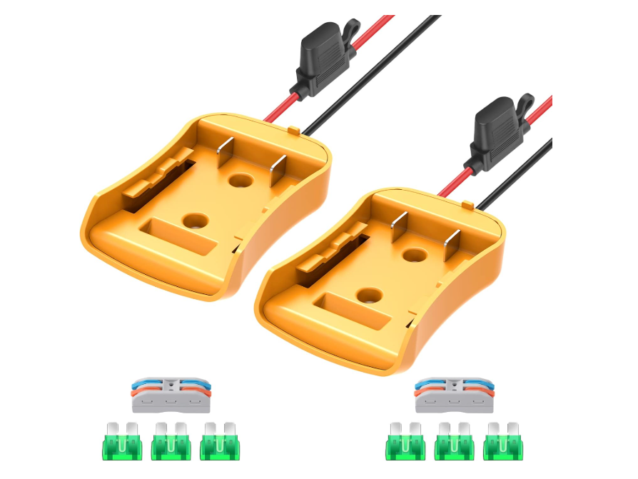

Use these fused adapters and wire them in series:
DeWalt 20V batteries come in several capacities. I use 5AH with a standard charger:
Not sure of the pinnout of the Shimano connector, you would have to test it with a voltmeter before wiring. It's possible there is some proprietary wiring configuration that could cause a problem. This is especially true if it's a Bosch system. Also, keep in mind there is no low voltage cutoff in the DeWalt battery internal BMS. If you discharge below 15.3V (30.6V in series), you could damage them

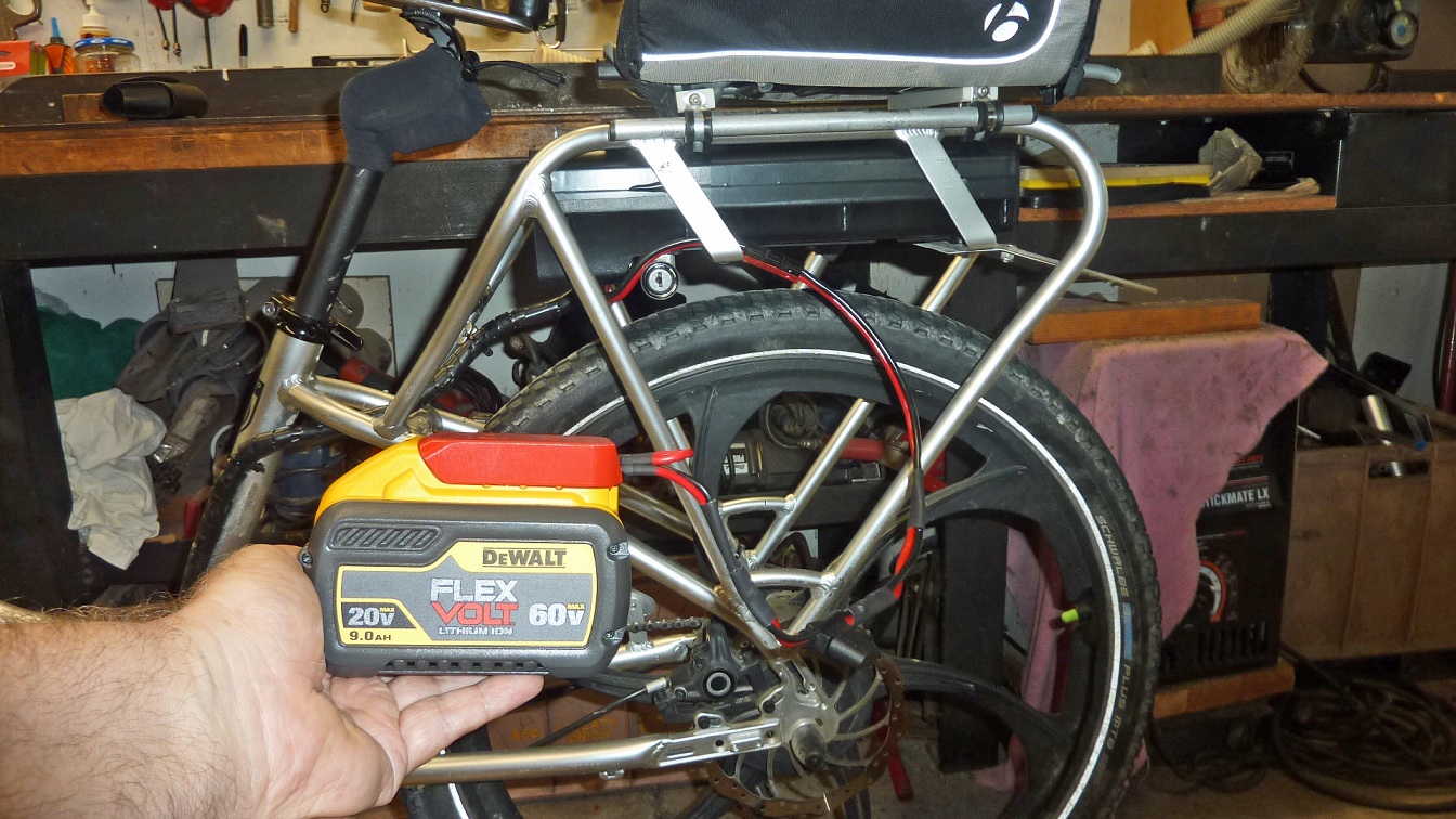

Lots of options for carrying the batteries. I generally use panniers or a rear rack bag to offer some protection.
The whole rig should cost less than $175. I would measure the pin spacing and try to figure out the wiring diagram before ordering anything.

I take it what I would be doing here would be completely taking off the battery, sticking it in a backpack (unfortunately-- I'm not gonna add a rack or pannies for a rare situation like this) and being comically unbalanced for the last five or 10 miles home. Which I could totally live with.
As for mounting the battery on the bike, things about this are super interesting.

Since your bike uses a Shimano 6010 battery, I assume it also uses a 36V Shimano controller. Any 36V controller will accept voltages slightly above 42V and should not have a problem with the 40V DeWalt batteries. Since the batteries are fused individually, it isn't likely they would be damaged either.
The biggest problem is figuring out the correct wiring to match the connector on the bike and if there is some sort of "handshake" arrangement between the bike & battery.

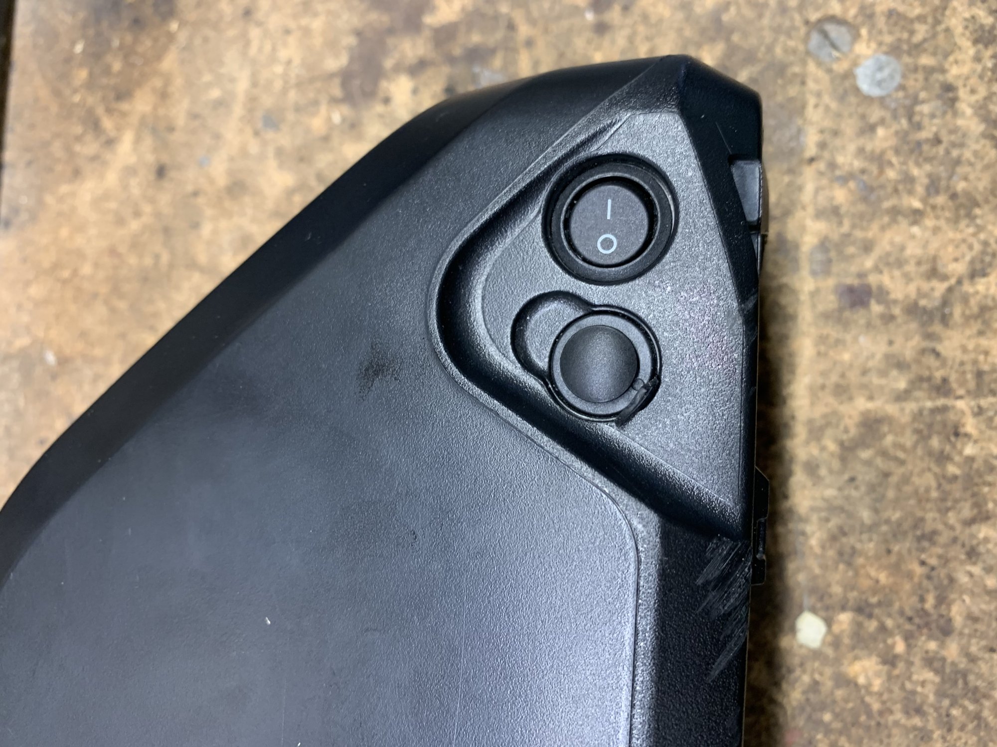

If the battery has an on/off switch, you could tap into the circuit using a short pigtail with a connector. That way, you could leave the battery in place, turn off the switch and plug in the tool batteries. They are smaller, lighter and more easily carried. My battery has such a switch and that's what I do.
Good luck!
