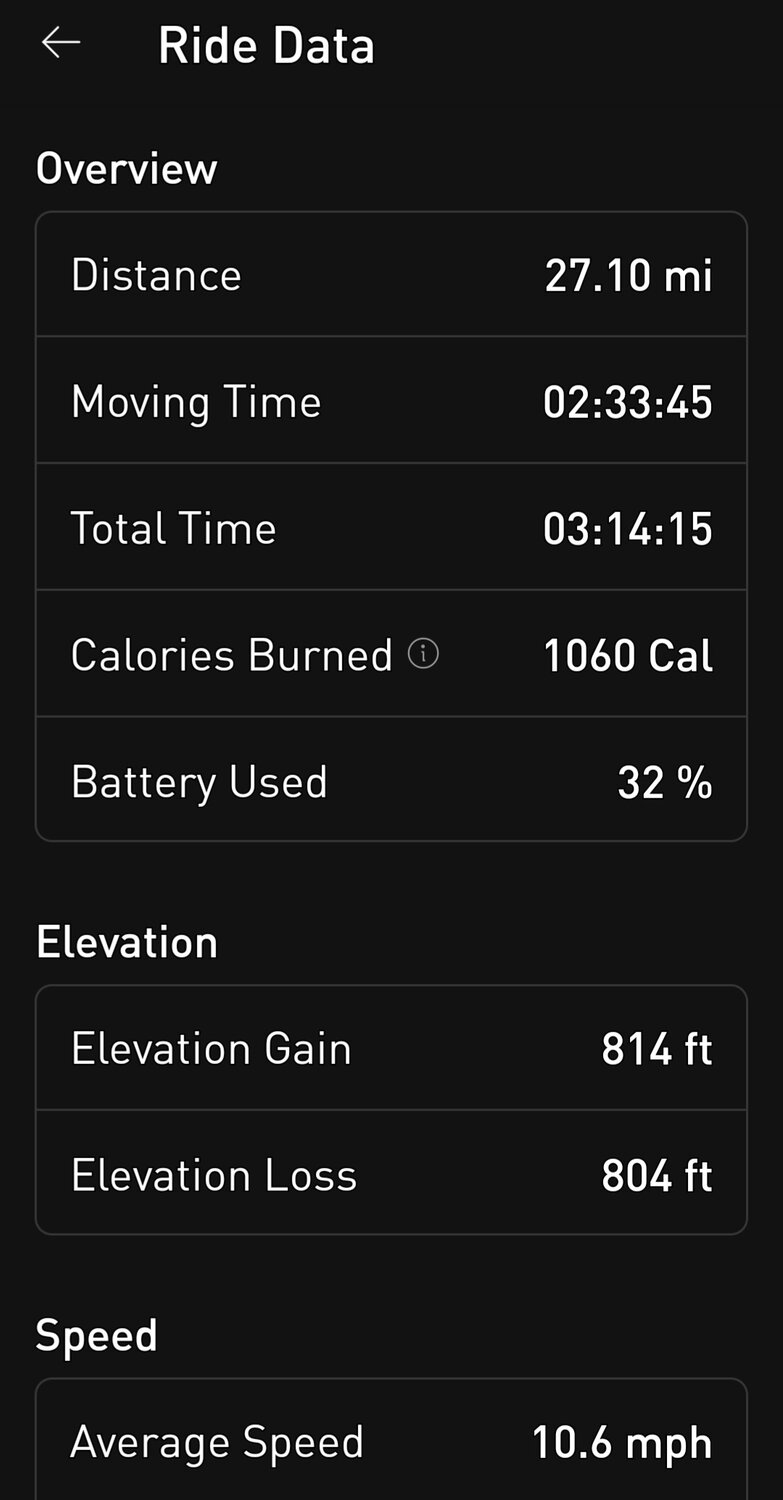

I ride a Vado SL 5.0 Eq usually charge the battery to 80%, I ride about 25 to 35 miles on a ride and the battery last me two rids before I charge it, I ride on Eco mode set up @ 25/25 I hardly ever go to Sport or Turbo mods, my last two rids added up to 56 miles and that is in 4 weeks period with the bike sitting in the garage. I am thinking about a RE. For the first time today I went under 20% battery and finished the ride with 15% left.

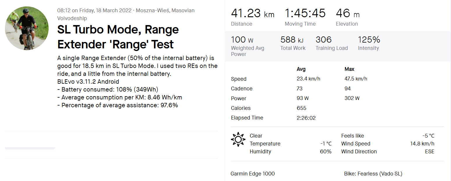

Now, I have found the outcome of an SL Turbo test ride 8 months post my Vado SL 4.0 EQ purchase. I rode using two Range Extenders one after another. As the test results show, each Range Extender was good for 18.5 km (11.5 mi) so both would be good for 37 km or 23 mi. The fact I could ride for 41.2 km (25.6 mi) was only possible because the Main Battery contributed with 8% of the charge extra.
