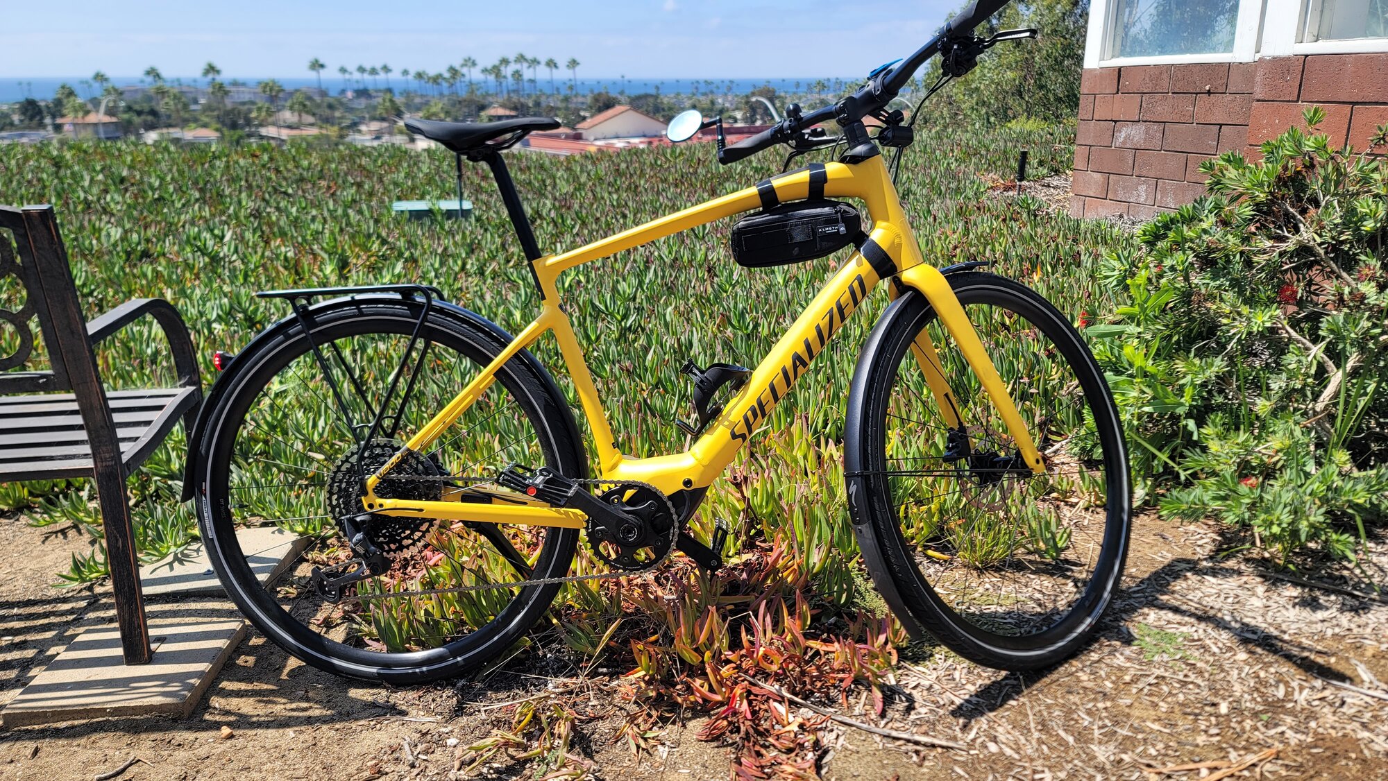

Thanks to SL intel and encouragement from you, @Stefan Mikes , @Prairie Dog , @Saratoga Dave , @DaveMatthews , and many others on EBR, I picked up the SL 2 days ago and declared it a keeper after its hilly 21-mile shakedown ride home.
What a wonderful bike — a class act all around! More first impressions here.
As of now, the bike has 27 miles and 1,562 ft of vertical under its belt on grades up to 10%. Most of this was in ECO with equal parts OFF and SPORT and no TURBO. Thanks to the reduced 40t chainring, most hills were conquered in ECO alone at cadences above 75 RPM — the happy place for my knees.
Battery remaining = 41%. Left the shop at 100%, so that's about 2%/mile in some of my hilliest terrain. And as many of you predicted, that means no RE on typical rides!
You guys kept telling me that the SL's a lot zippier than you'd think from the 250W and 35 Nm motor specs, and boy were you right! Having never had a power meter, I was also quite surprised to see an adjusted (average) rider power in the 120-150W range with short bursts of over 300W. Guess I have 3,000 mi on a heavy torque-sensing hub-drive to thank for that!
Thanks again guys. This bike is gonna be fun!
Jesus, that’s a good looking bike. Put some helicopter or other 3M tape under those straps on the bag so the paint doesn’t get worn there!
Thanks! Helicopter tape is a great idea.
At least on a bike. Still find it disconcerting that tape has any role whatsoever in a helicopter. No more helicopter tours for me!
Bumble bee beauty! I wish that color was available when I bought mine. Good for safety and pretty. Tip from an expereinced Specialized owner - be sure and register it AND scan in your receipt to the specialized web site. Recently had mine in for service and they made a big deal out of the "original receipt" issue in order to get discount; even though it had been serviced at their shop many times and bought at an affliate store.
