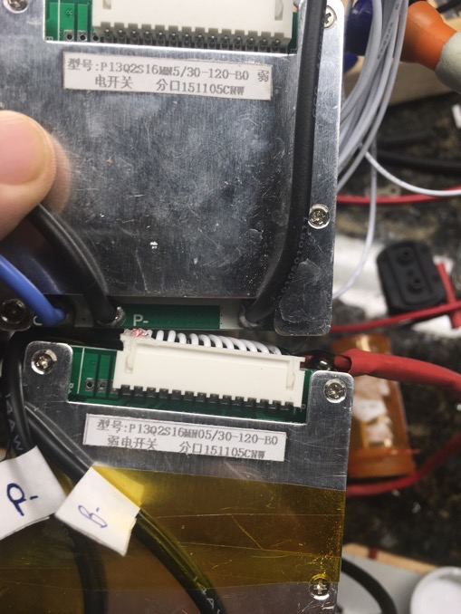

Actually I had an ebike pack with a bad cell, initially I didn't even know. But then got app on phone to connect to BMS over bluetooth and could see while charging one cell's IR was higher than the rest. BMS never really complained and let me cycle the pack. Realistically I could likely continue to cycle it for a long time and chances are it wouldn't actually fail catastrophically.. but it could. I guess one issue is I'm sure lots of packs are built with junk cells.
Wow! Very cool! Who built the battery with a BT BMS capable of IR readings? Which app?
Thanks!!!
Oh sorry, not that cool, just the Xiaoxiang BMS app (actually there are a few versions of it, just one that lets you watch per-cells voltages). When cells are basically balanced either putting big charge load seeing one cell read much higher than the rest, or putting on big discharge and seeing same cell sagging much more. Eg got 13 cells in series, all balanced, then apply load and you have 12 cells within 0.01v of eachother and one outlier 0.07v high/lower depending on type of load. That is basically a difference in IR you're seeing, if they started at same voltage within a 5 seconds they're effectively still at same state-of-charge, its just IR differences showing up. Annoying thing with ebikes is you can't just easily pull apart cells in parallel and figure if you just happen to have 5 below avg cells in parallel or if you've got 4 avg cells and one piece of garbage making them look bad.
