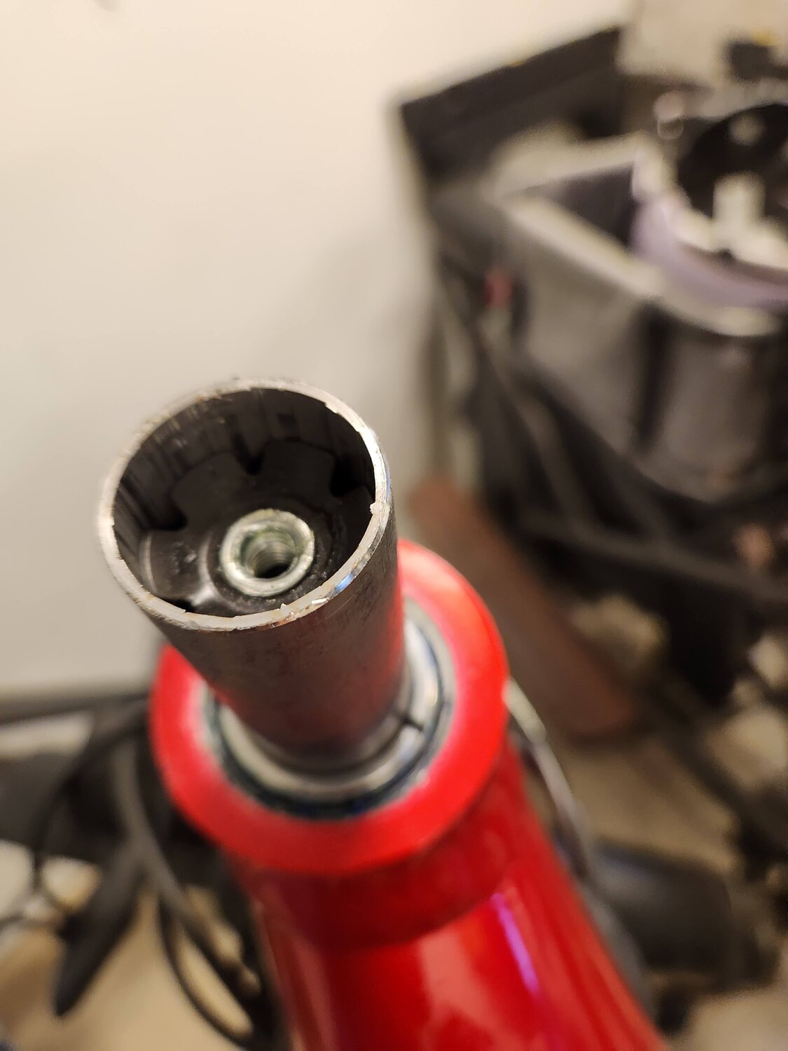

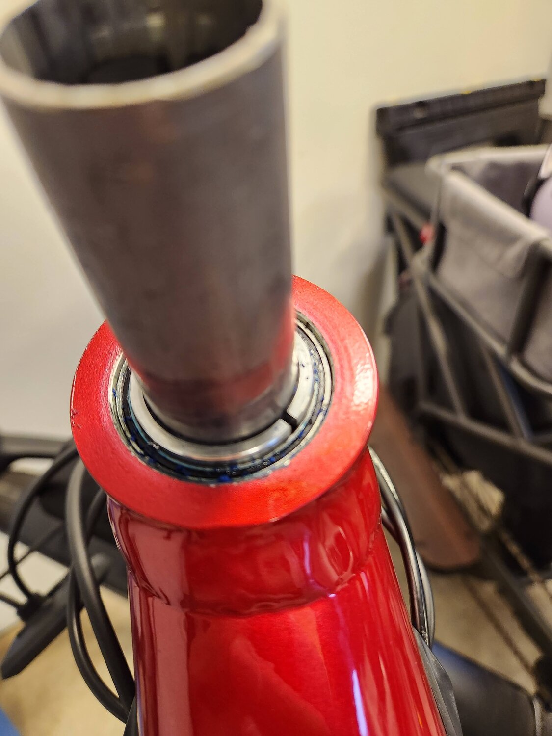

Hello I believe it is possible and I am in the process of trying to do it. I have a 2023 Como 4.0 I just took off the integrated bars/stem to see what is underneath and what I found that it seems to be possible. The only issue is finding a headtube cap/cover that will fit properly to protect the bearing and not impede the steering. I am going to contact some companies for help and hope I don't have to get something custom made. Anyone's help here would be appreciated too. Here are some pics and specs.
Steerer tube = Standard 1 1/8 (28.6mm) diameter​
Total stack of steerer tube = 61mm​
Headtube outer dia. = 58mm​
Headtube inner dia. = 42mm​
The bottom of the cover would need a lip that is also the same as the top opening for the steerer tube (28.6mm) so that the cover sits on the split ring you see in the pic that sits between the bearing and steerer tube. That way when I compress everything the cover is not sitting directly in the top of the headtube and creating friction or grinding it when turning. At least I think this is how it is supposed to work. If the cover sat directly on the headtube, it would need some kind of plastic/rubber washer/shim maybe?
Other specs here are some more if it helps:
Split compression ring sits about 1.5mm above Headtube​
Split compression ring has about a 2.5mm thickness (from steerer tube outward)​
According to Specialized, the upper bearing is a fully integrated 1.125" Campy-style 45° cartridge​
Any recommendations for a Headtube cap/cover?

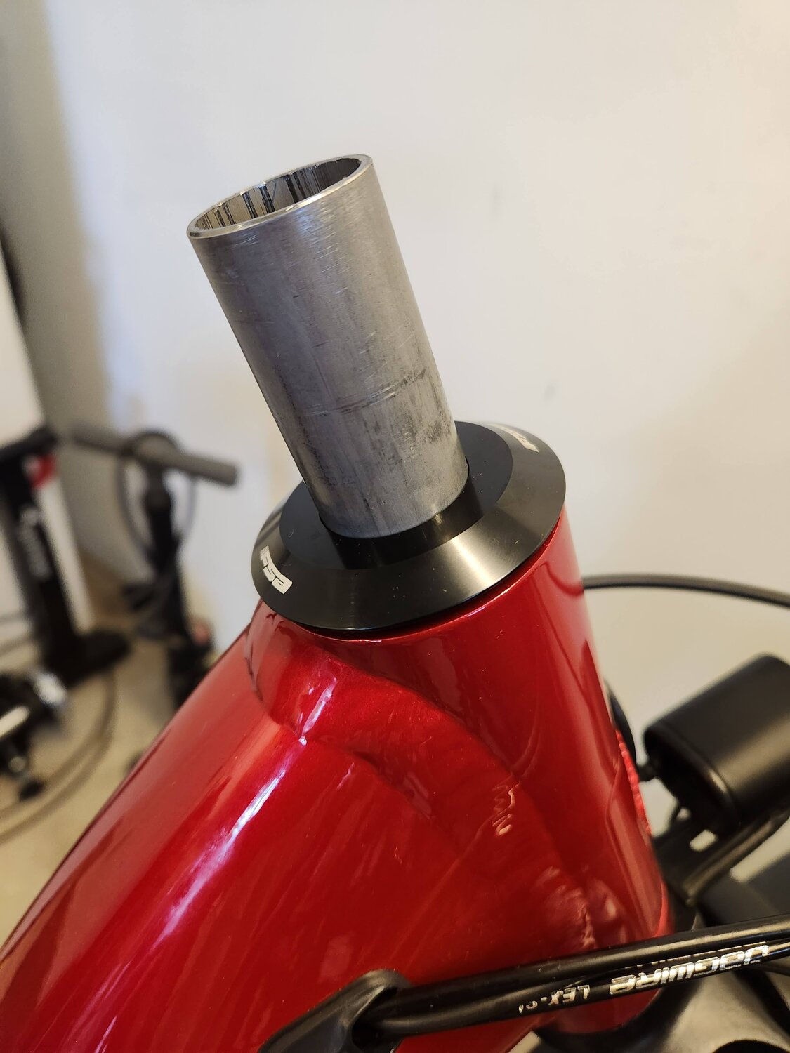

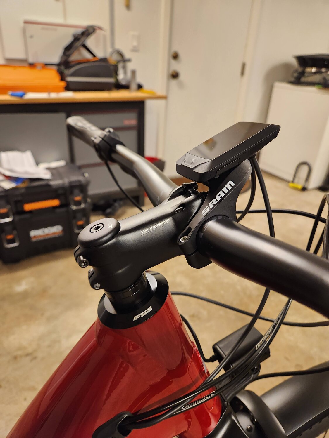

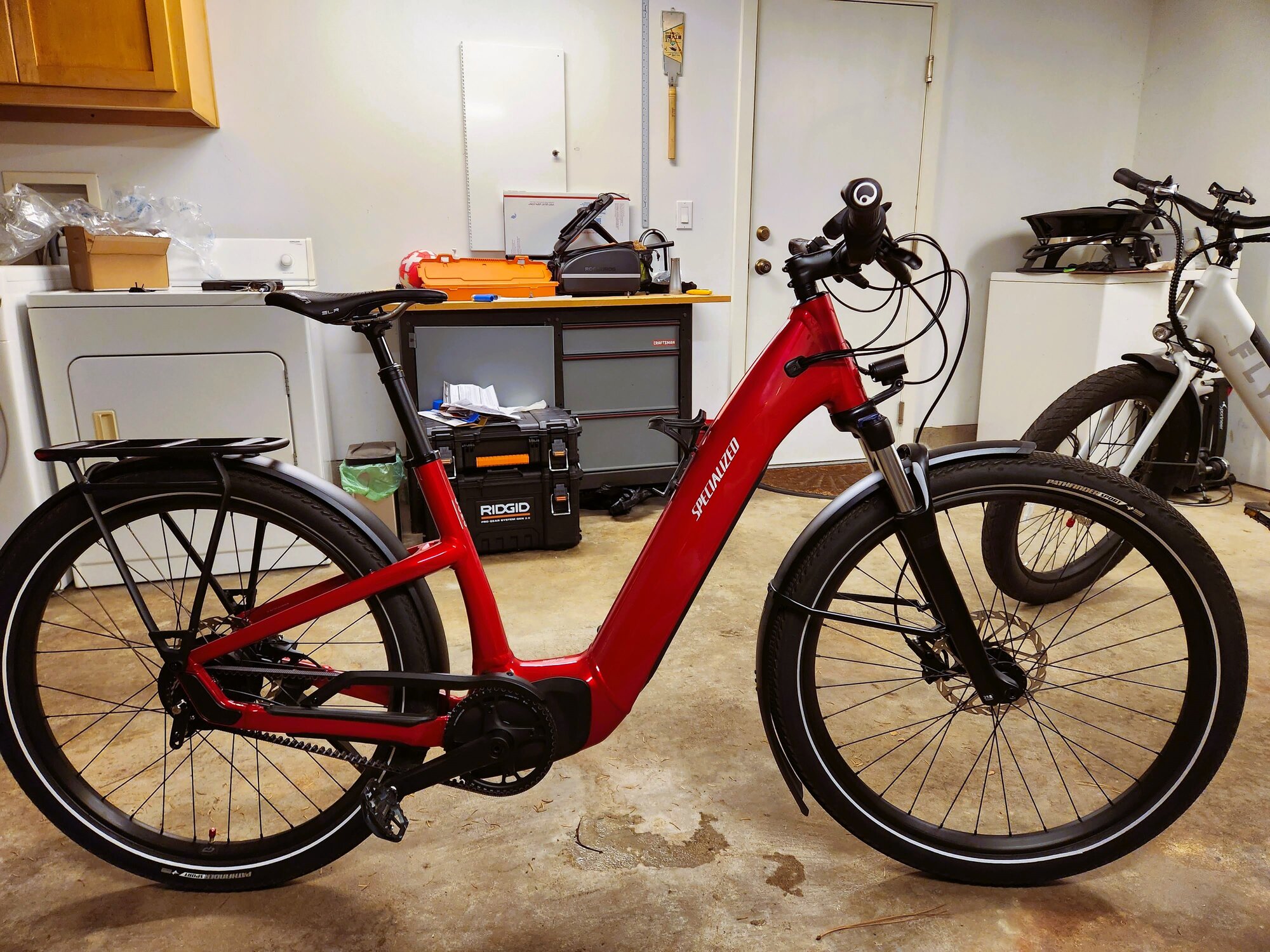

Update on my project. It is possible to change the bars. It took a long time trying to find a headset top cover that would work since the Como has a large diameter headtube. I found one by FSA that is not perfect but will do. It is part of headset No.55R 1.5" the cover is part #H2285. They don't sell the cover by itself, so I had to get the whole headset which runs about $45 (I got it on discount for less). It is a nice piece that has a rubber gasket that hugs the steerer tube and prevents water/dirt from seeping in. The cover is a little larger in diameter at 61mm (headtube is 58mm), ever so slightly larger than the headtube diameter but I figure it will help water/dirt from getting into the top bearing. There were other FSA covers that would work, the closest being one that was 55mm in diameter which would leave a 1.5mm of headtube exposed. Once I get my spacers I'll add the stem and bars I got to show.

Yes that is possible. You can find the same cover I did or anything between 56-61mm in diameter. As long as the cover is flat on the bottom it will sit on the compression ring and work. You need to get a higher angle stem, maybe 46 degree, and perhaps some 20-35mm riser bars depending on how high you want.
@CiscoComo once again congrats on your bike's transformation. I just wonder how is the bike handling, comfort, and general feel after the change? By removing the back sweep you basically increased the bike by two sizes and it is a really long bike to start with. I'm considering a similar transformation, just using a riser handlebar with some back sweep to retain some of the comfort.
I also tried looking up another steerer cover that would match the headtube more closely, but yours seems to be the best fitting one.

The bike handles well and still feels comfortable. I'm 5'10" and have the medium size Como frame. The bars a more forward but since I only used a 70mm stem and 15mm riser bar, I don't feel like I'm extended a lot more than the original setup. My positioning is still more upright than a road bike, with a slightly more forward position. With the original setup, it was comfy but I felt off-balance when going into turns being so upright. I felt I needed to slow way down or I might loose control of the bike. I also didn't like the positioning of the bars when climbing a hill (even though I can just use the motor more, I still keep it on eco to get the exercise). Now with the new setup, the bike feels more nimble, feels like I have more control in turns, and better positioning for uphill climbs. With my weight a little more forward, it takes the weight of my seat so no soar butt after a long ride. I love it now as a road/groomed gravel commuter bike for my area that has lots of hills.
I bet it must feel much more sporty, and funnily as it has a slacker / more mtb-like head tube angle than the Vado, it might be better suited for descending and off-road. Just be aware when going gravel, that its BB height is 10 mm lower than that of Vado, so swapping to a shorter crank might be a good solution for solving both crank-strikes and knee problems. The BB is still higher than most gravels though - 275 mm vs 268 mm in Sirrus X, and 265 mm in Diverge, so it should be fine.

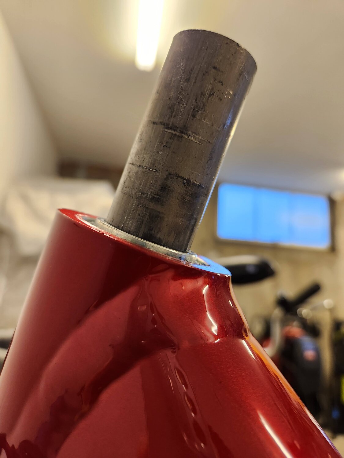

BTW are you sure, that the stem conversion is sound from the technical standpoint? Was there a star-nut inside the steering tube? I suppose there should be one to compress the steerer.
When I say gravel road, I mean well groomed, smooth and compacted gravel trails we have here for runners/bikes. I wouldn't take this in the "outback" trails or anything that has really rough terrain. The bike is not meant for that. And, yes there is a star nut in the there:
@CiscoComo what mount did you use for the Mastermind computer? I wonder whether a regular Garmin mount would fit. Did you consider bolting it directly to the stem cap?
I used an SRAM Garmin MTB mount. The specialized computer uses the same mount as a Garmin. I reused the part from the original Como bars that twist into the computer mount and give you the ability to adjust the angle. It also gives some clearance for the wire harness on the back of the computer. Specialized also sells handlebar mounts for the computer. I did think about getting one that moutns to the stem cap, but I decided I didn't want to have to take many things apart if I needed to access the steerer tube or service the bearings in the future.

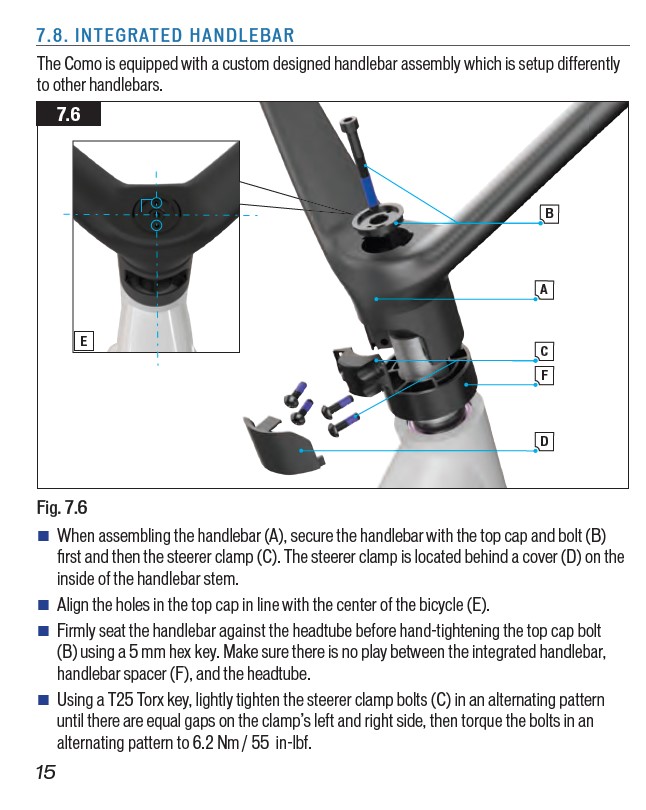

On the L size, there are two "F" (marked on the figure above) spacers, is there only one on S and M or none on S size ?
I should try with one space less but with the same handlebar to check if the position is interesting...
Yes the S and M have one spacer. You would need to take the bars off to see, I am guessing the steerer tube is longer on your L bike. Maybe the place you bought it when assembling didn't cut the steerer tube? If they used two spacers then that means they are needed. If you want to keep the bars, you could get the steerer tube cut down so you only need one spacer or none at all.
