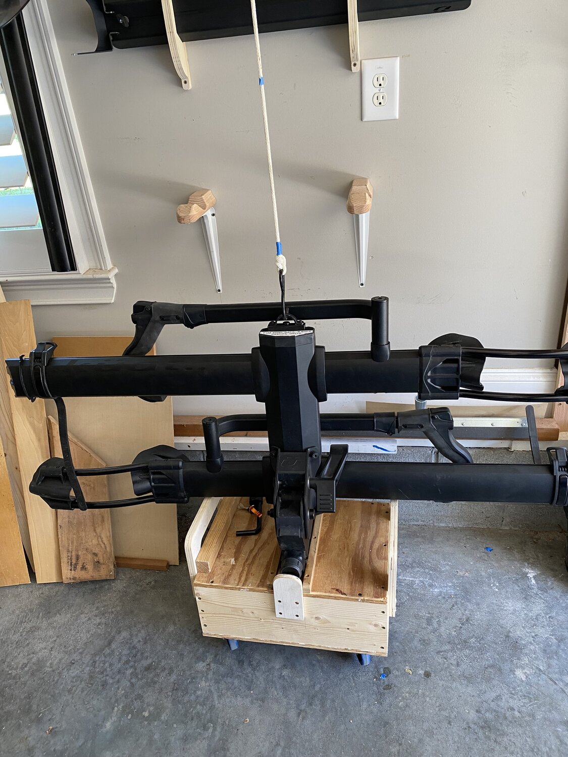

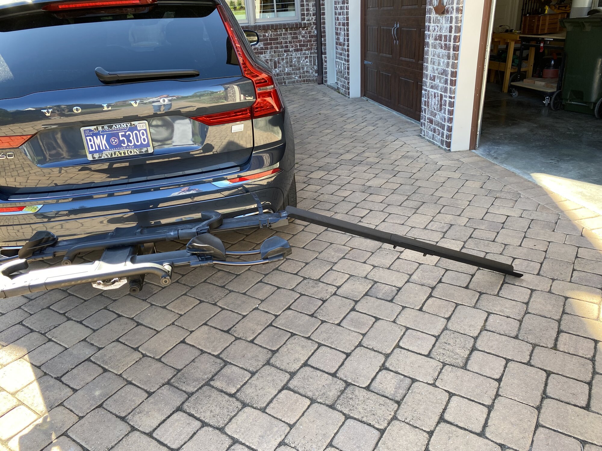

So, here's what I did to deal with the weight of the Turbo Como.
I have a KUAT NV2.0 base carrier. Works great but heavy (52#). Bought their loading ramp ($96). Now effortless to load the bike nearest the car using walk mode. Using this method for a second bike takes some effort as it has to be leaned way over for bike #2 handlebars to clear bike #1 handlebars. Honestly its easier to load bike #2 using the lock the rear brake and pull up method.

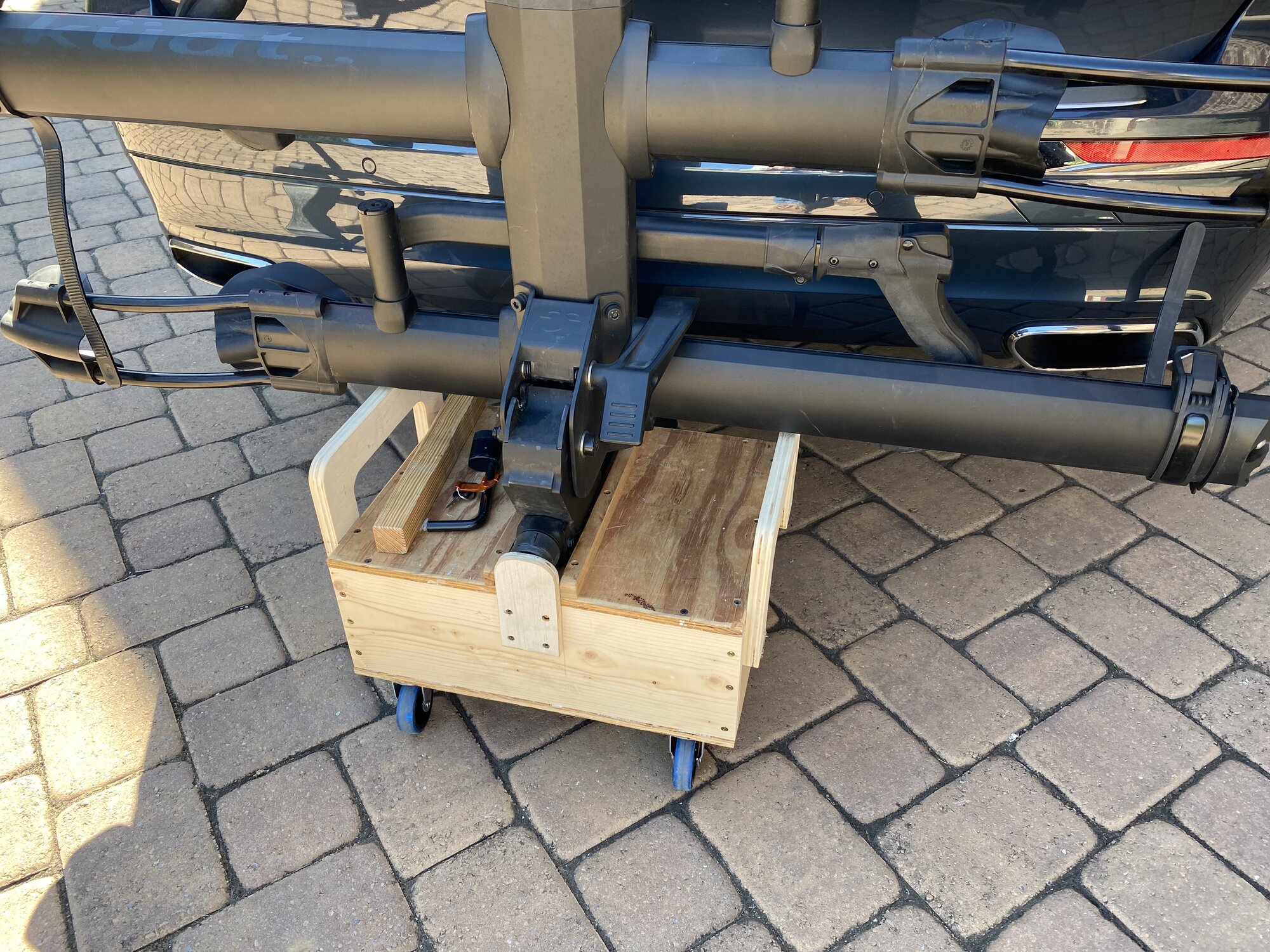

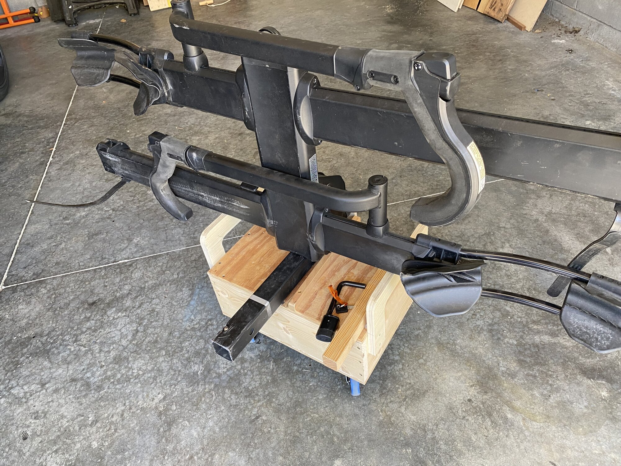

Here's the dolly I made from scrap wood and $12 worth of Harbor Freight casters.
Its just the right height for the square tube to slide into the hitch receiver

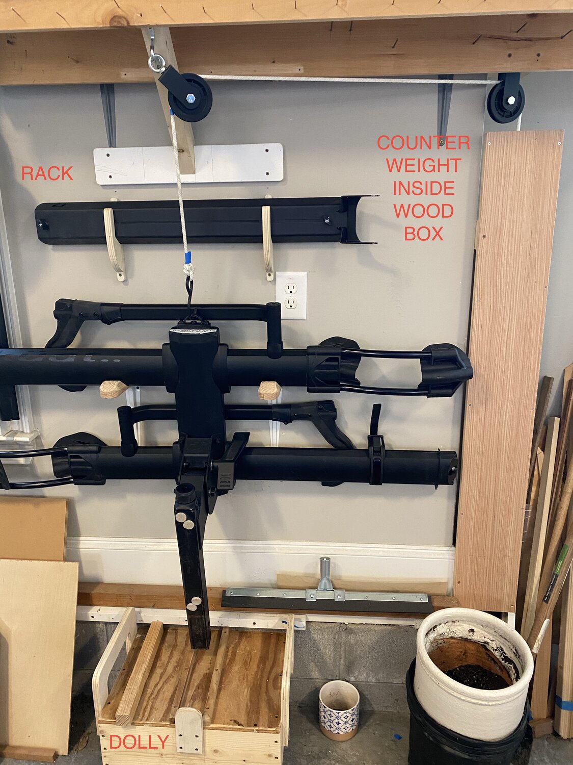

I made a counterweight system to help load it onto its brackets on the garage wall. There is a 28# piece of lead on the other end of the rope so I have to pull down with 28# force, hook the rope onto the bike rack then lift its now apparent 24# up onto the wall brackets. Pretty easy to do.
And all put away
