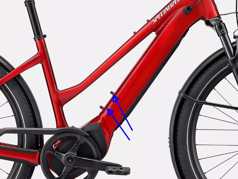

Green, if you want a water bottle cage on the Vado 4.0 ST, it is probably doable to mount the cage on the bottom "tube". You just need a side loading water-bottle-cage, e.g., Specialized Zee Cage II. Please ask the shop to test it for you! There are bottle cage mounts there!

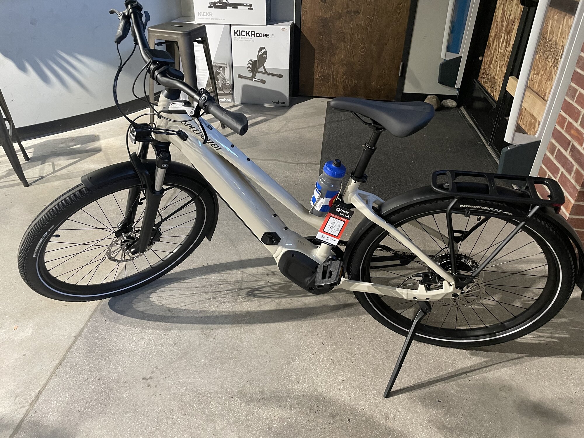

Thanks for the responses. I did ask the shop to install a side loading cage in the bottom area of the step through but they told me it would not fit. They said the water bottle was hitting at the top. I don't know which model they used though. I will ask them about the Zee Cage II to see if that will work. Was curious if anyone was successful fitting a water bottle in this area. I saw these adjustment brackets. Was thinking something like this might allow the cage to be lowered a bit?

I stood over the medium standard frame Vado 5.0. I am 5’-8” tall (wear 29” -30” inseam pants) and there is not much room on the stand over. I did not try a small size frame because several of the sale people said medium was the size for me. Now I am wondering if a medium is too big. How can you tell what is the proper fit? For the 4.0 ST I did find a couple of options for mounting the bottle cage vertically on the seat post tube. It it completely out of the way. I honestly don’t understand why they didn’t mount it there in the first place.

I have a Turbo Vado 5.0 in size medium. The regular frame model and it fits water bottles perfectly fine. I am 5'9" and the frame fits me perfectly. A Large would be too big I think.
BTW, the shop tried the Specialized Zee Cage II tonight and confirmed this does not work on the bottom mount location for the Vado medium step-through frame. Might fit on the large frame though.
How bad! It looks the new Vados ST have their top tube located lower than the pre 2022 models...
