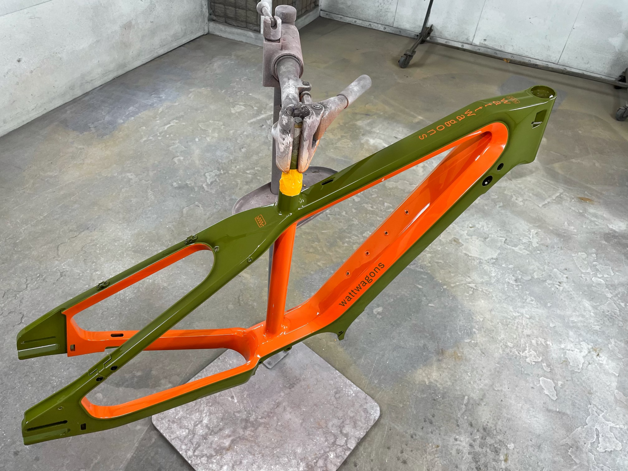

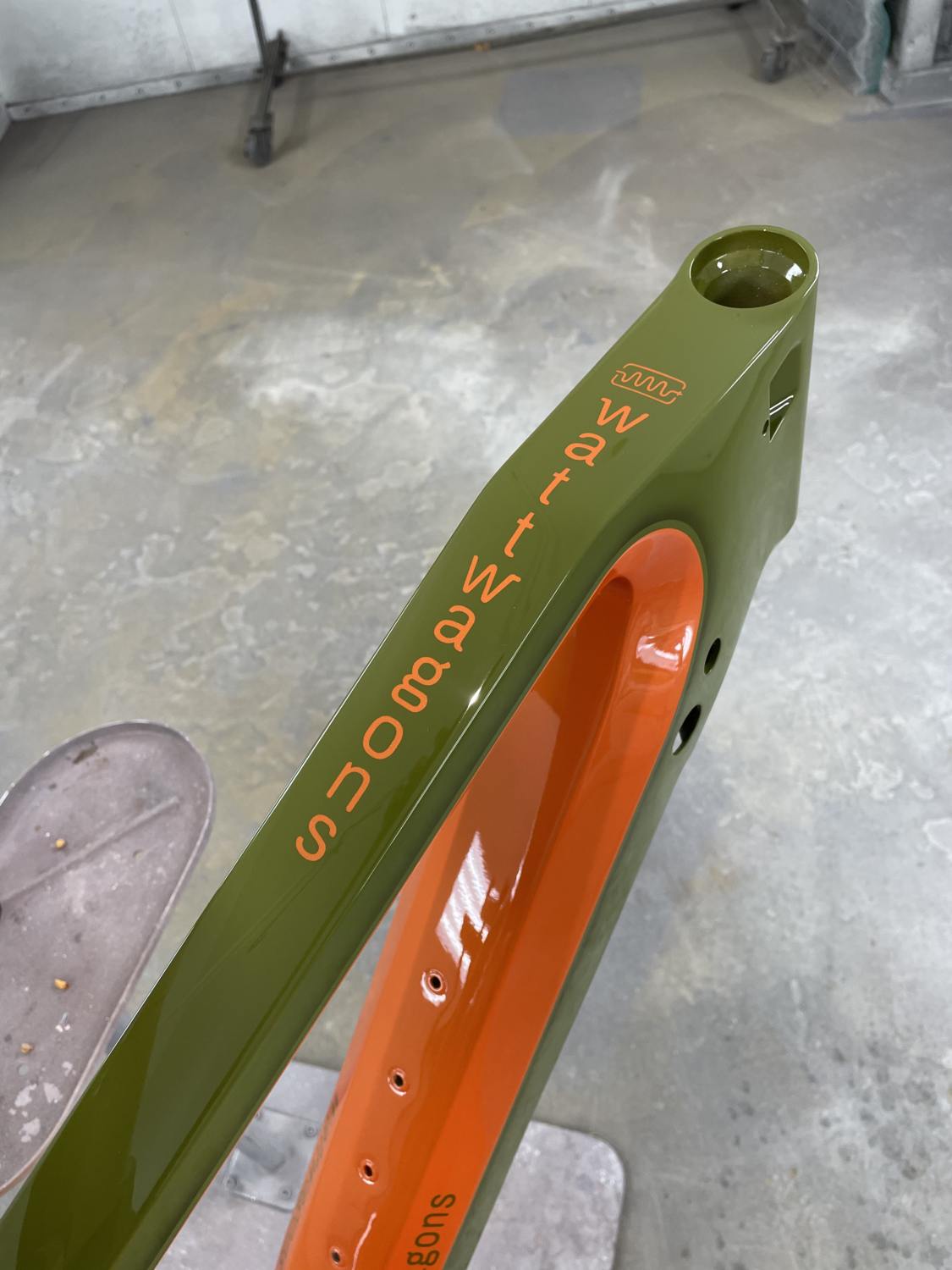

Oh.. as an aside - we finally have the painted frame on Helios.
View attachment 78203View attachment 78204
W O W !
This one is paint (just to show how paint can look). I am negotiating a price if we do clear coat on all our bikes.
Seems to be a popular option, and it also keeps the color intact for longer.
Geeez that's a nice paint job. But if it was my bike I'd have to name it Pumpkin. 🤣
