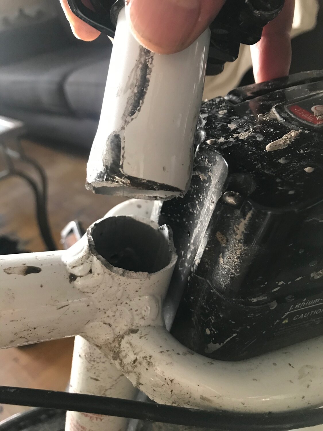

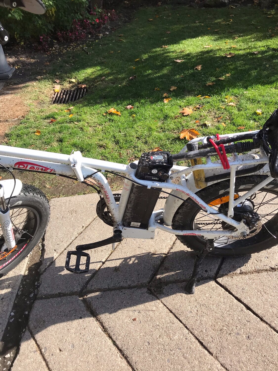

Bought a DJ Fat tire e-bike late July of last year. Used it for 2 months. Used it again this year. All in all I have only put 3,400 km on it with simple riding. Am 5'4 at 140 pounds so not heavy for the bike.
Today while riding, the seat tube of the frame itself snapped at the seat.
The seat broke and immediately caught itself in the spokes of the back wheel and I slid onto the muddy grass to a stop. Fortunately not hurting myself further.
Is there any way of fixing this so it is still useable?

If you can't get any satisfaction from the seller call around to local welding/machine shops. Ask about TIG welding an aluminum bike frame. Most should be able to do the job. It's not a big job and shouldn't be that expensive.

Could be a warning about the future life of that frame. When the break is just off the weld, it usually means their was too much heat and brittleness in the welding process of the aluminum. The safest way to fix just that break is to add another smaller diameter piece inside the tube to spread the load across that seam, then have it all welded up. Start doing a weekly inspection around all the weld joints and really study that thing for cracks. You used up one life on that failure, no need using up more by ignoring the issue.

How much seat post was inside the frame? If it was beyond the extension mark, or the bottom of the post was at the junction of the two tubes, the seatpost would act like a long lever and break the frame just like how it appears.
I threw out the seat earlier but if I understand your question, the seat was not high up as I am only 5"4, perhaps even 1/2 inch shorter so I had to ride with the seat low.
