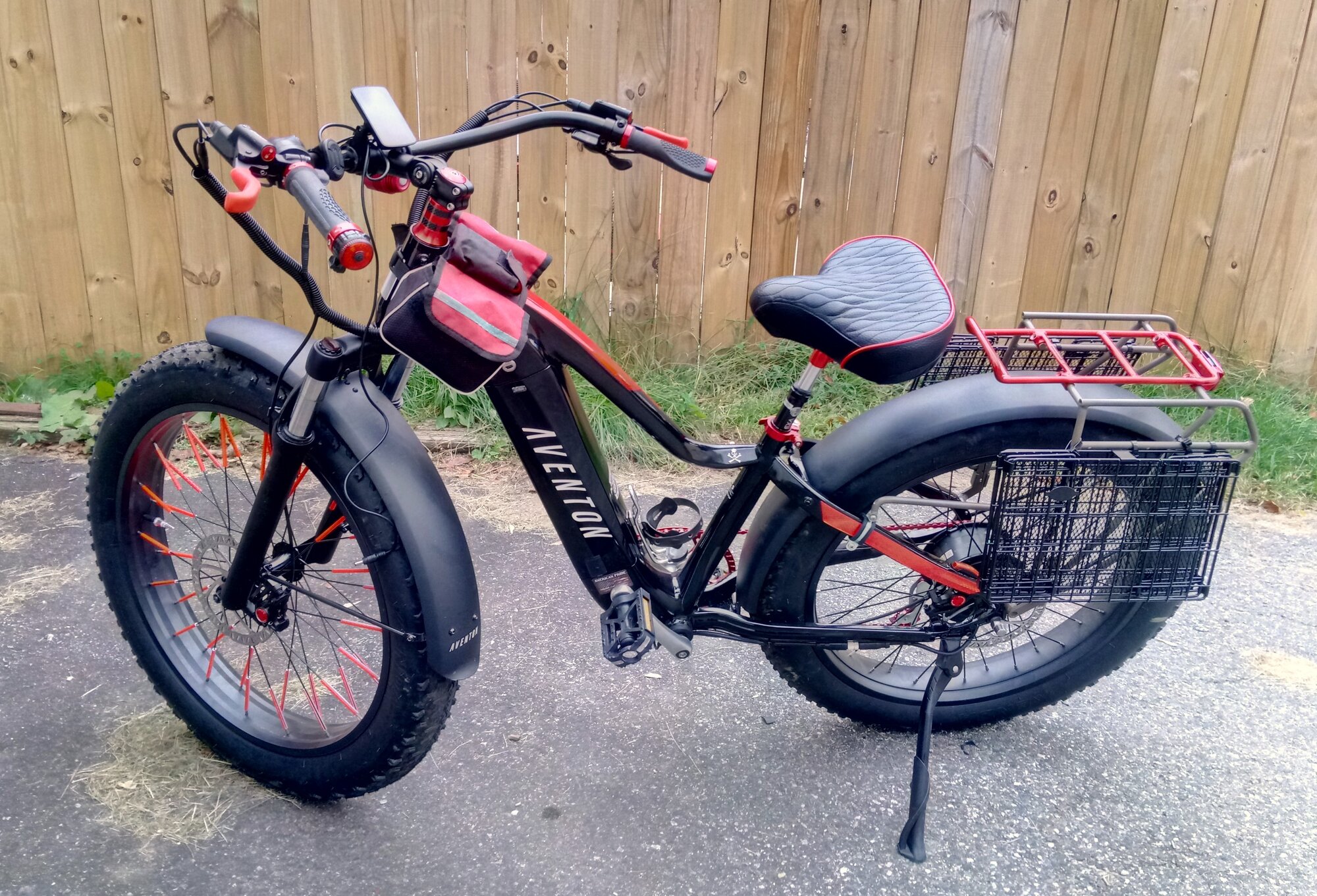

Instead I'm just going to focus on the current bike. An Aventon Aventure.
When I got it the chain was too short stretching the derailleur out straight and bending the mount. In fact I'm reasonably certain that the chain it came with isn't even an 8 speed chain as it's thicker and has no flex. The brakes didn't work, the front one barely engaging and the rear being totally nonfunctional. Their support has ranged from vague to nonexistent, my local bike shop I don't trust and wanted $185 just to look at it, so I was 100% reliant on fixing this myself. In fact I ordered online specifically because I don't trust any "LBS" within a two hour drive of my location.
The chain was easy, I was planning on swapping that out anyways and I ended up having to splice links in from a second chain to reach the correct length. Using two master links also meant I could swap out the smaller section when I did my planned upgrade to a 52 tooth chainring and better cranks. The front brake the only problem was the nut holding the hose on was unscrewed about three turns, so it was bleeding pressure there. Bleed kit, some proper oil, and tightening the nut fixed that right up.
The rear brake caliper was completely seized. Disassembling it the piston itself wasn't frozen but the bladder to push it out didn't inflate, despite there being no obvious leaks. I suspect some sort of clog between the hose and the bladder. Since their support wasn't responsing I broke down, ordered a cheap rear kit off amazon that used the same caliper -- since nobody would sell me JUST that part. Swapping that in, doing a proper fill and pumping out the bubbles, and I've got working rear brakes. Woo-hoo, I can ride!
I thought there was something also wrong with the motor side of things when I took it for a ride in an abandoned lot before I made any of the repairs. The fixes to the drive-train in terms of swapping the derailleur mount for the spare the bike shipped with and a proper length / style chain seems to have cleared things up.
From there once I got 60 miles on it to be sure it wasn't going to die -- like my first few bikes I had to return -- I started swapping out the furniture.
And yeah, I didn't go nuts cleaning it up post-ride to take the pics. It's a bicycle, not a supermodel that needs airbrushing.
The panniers are at an odd angle because the arms to mount to the frame are about 4" shorter than need be. I could have got the one from Aventon with the bike, but I already had this "fat tire" compatible one. The arms are threaded so I'll be able to correct that with some 5" long bolts and some steel shims.
The seat is temporary and just something I had lying around. Still and improvement over the arse-busting sheet of cardboard butt-floss it came with. . This one is better, but still has those two raised "bumps" to apply all the force of sitting on the "sit bones"... nonsensical design and ergonomics since whilst YES, most of the force of sitting is placed there, that's no reason to make it WORSE by placing ALL the force there. I've got a proper "cupping" seat coming, which despite being dirt cheap will likely better fit me. That way I'm not screaming about how much it hurts my coccyx like Deputy Dawg. Which is EXACTLY what those flat narrow seats do to my back.
And that's the thing, you like the narrow seat, good on you. I like the wider seat, good on me. We're not all shaped the same, we're not all in the same physical condition. I've gotten too much advice based on fanboy cultism preferences and not on ... well... reality.
Making much more of an impact was my adding a suspension post. Sure it's a bargain basement one off Amazon, but it works. Big trick, if you just put a little wash of 3-in-1 on the exposed shaft, after three or four compressions it gets as smooth and effective as more expensive ones. Not sure how long that will last or if I'm washing away grease inside it, but it's not like taking one of these apart to redo the grease and such is rocket science. It's a freaking air dampener.
Also readily apparent is my covering up the side yellow stripes with red reflective tape. Easy change, easy to remove back to stock, and improves your ability to be seen at night. Important since I oft ride around 3AM as it's actually safer than daytime riding.

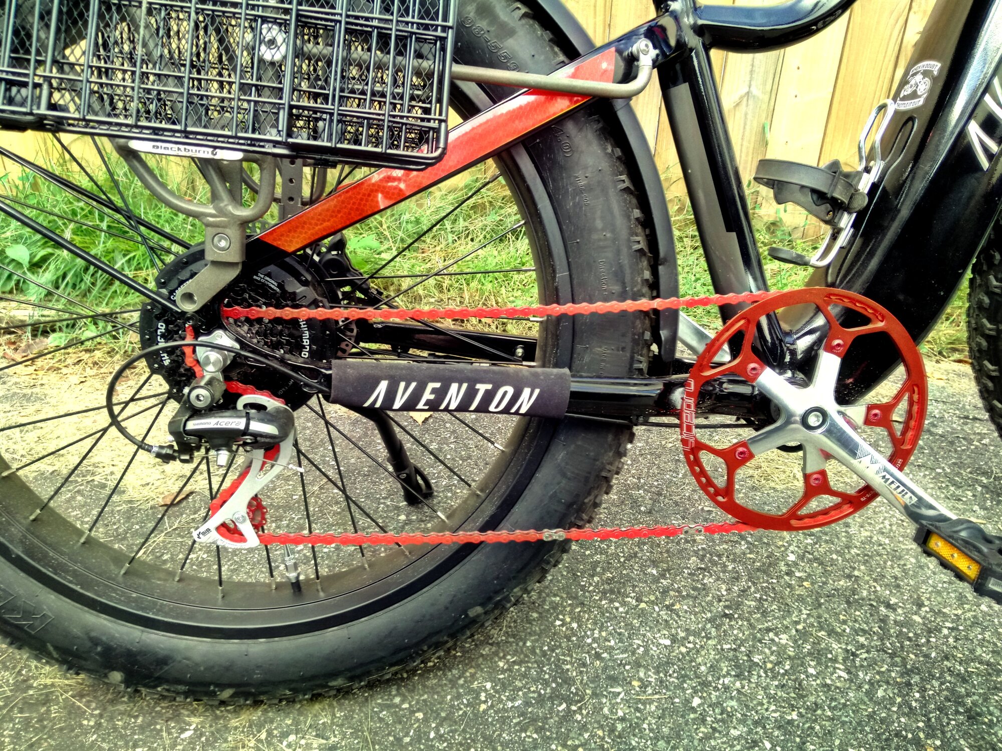

The drivetrain:
You can see the extended cheap chinese teflon covered chain (which I waxed), how I swapped out both cheap plastic pulleys in the derailleur for smaller metal ones which greatly smoothed out the shifting, my el-cheapo lightweight 52 tooth chainring replacing the pathetically small 46 it came with, , and a cheap set of aluminum cranks. The laugh being these bargain basement cranks and chainwheel knocked 2 and a half pounds off the bike.
And yes I'm also using light-up pedals. Those of you about to kvetch about how 'cheap" they are can kiss right off. I used an identical pair on my beach cruiser for a decade, and they're in fine shape.

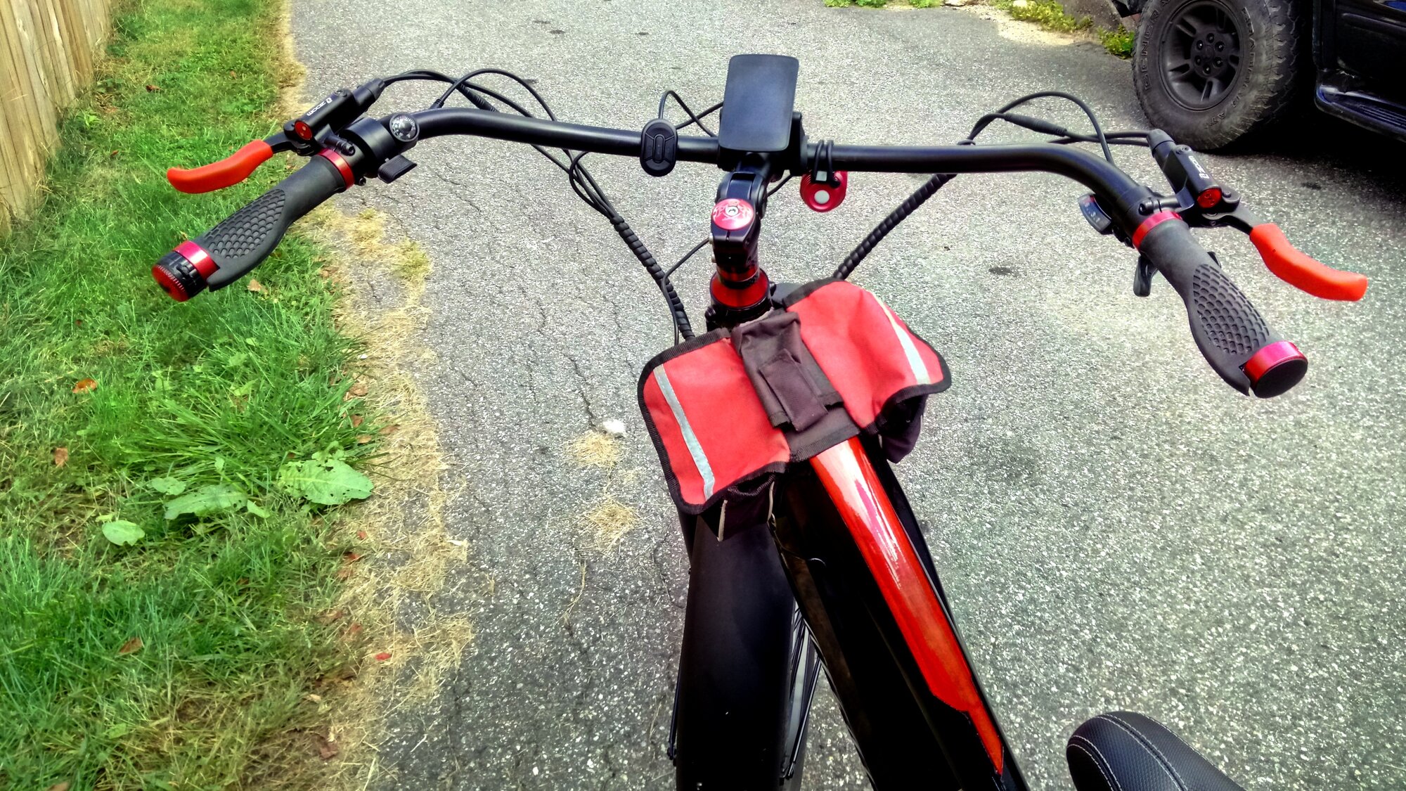

I swapped out the bars for a beach cruiser set.
Widening the stance and improving the comfort. The Aventure -- at least the "small" I got" feels like a bit shorter a bike, so to normalize out the cruiser bars I used the longest adjustable neck I could find at a reasonable price.
These bars are cute as they're a set I took off another bike over a decade ago because the chrome was peeling off them, and were sitting on the floor of my garage ever since. They were a hideous pile of rust with any traces of the chrome completely gone, and I was about to toss them in the trash and just order a new set, when I said "No, you can fix these!" I should have grabbed a before pic... but a pass of rust remover and steel wool, further pass with scotch-brite and pine sol (sounds weird, trust me!), pressure wash and dry, filler and primer, sand, prime again, two coats of satin black, and they look great!
You can see I went with a cheap set of paddle grips, I've got peasant tastes, these are actually what's most comfortable for me, I've had a set on my old cruiser for years without problem, and if they do magically have the rubber break down they're $5 to replace. Naturally I added "sticky fingers" to the brake handles, and I dived into my parts bin to find some anodized red headset rings that I alternated with some "carbon fiber" patterned ones.
The switch to the wider bars meant the control pad couldn't reach since it's got a very short cable from the display, but honestly out at the grip it was hard to use without taking your hand off the bars anyways. My thumb just didn't reach that far, and mashing around could never hit the right buttons anyways. I might take the time to make a custom replacement with cherry speed silver switches, but that's a ways off.

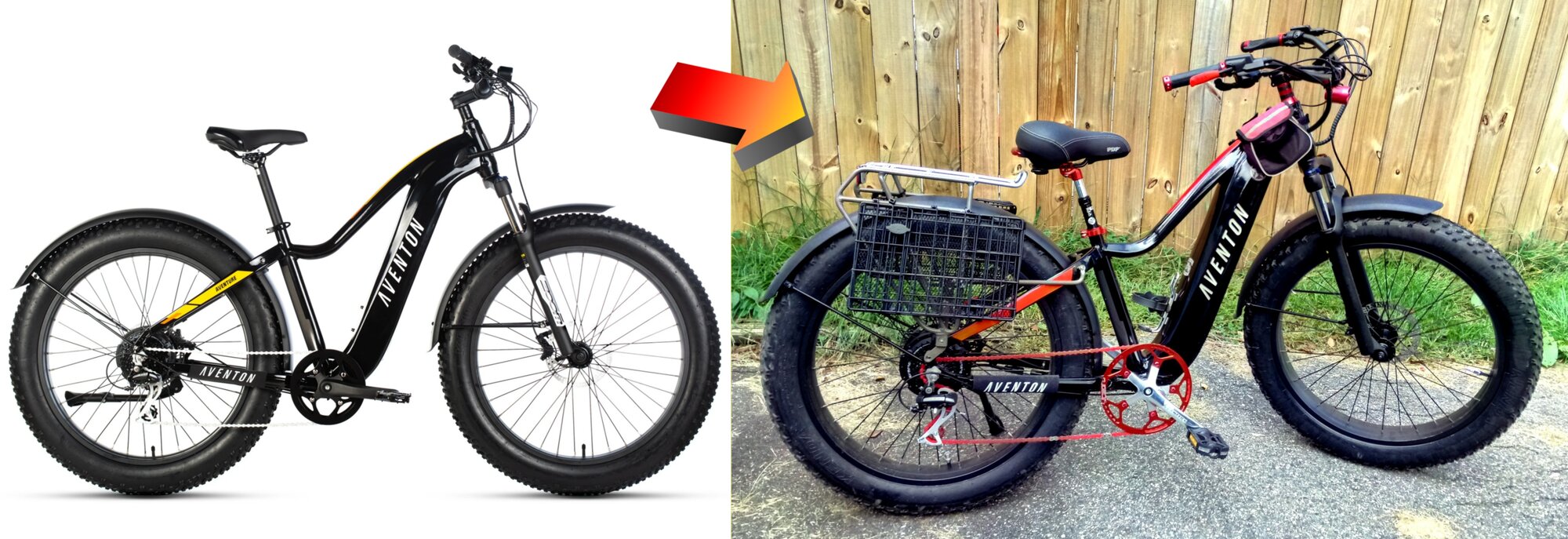

Also see the red stripe on the top tube? I masked off the yellow one it came with and just shot it with three coats of candy apple red and two coats of clear sealer. The original pattern shows through the translucent candy paint. It's hidden under the bag, but the "Aventure" text can still be clearly seen through it. Given I've got a medication induced parkinsonism I'm rather proud of that paint job, simple as it is.

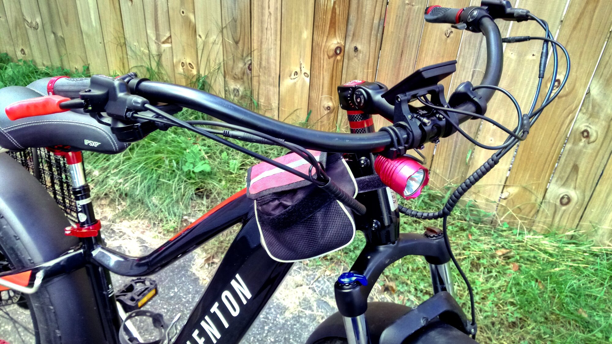

And you get a better look at my replacement light. These run around $30 to $40 and with a single cree T6 they're way brighter than most stock lights that come with e-bikes. I'm powering it off a battery in the tube bag for now, as I haven't had time to sit down with my multimeter to see what the stock light was getting for juice. I'm hoping it's somewhere between 4.6 and 9.6 volts as that's what this light can handle, but in all likelihood it's the raw 48v just like the Nakto's I had to return. For now it's enough to get me out and riding.
The cruiser bars are narrower at the join to the neck than the stock bars, but I keep all my old tubes because you never know when you will need some scrap rubber for patches, spacers, etc. Cut out two strips, wrap them around the bars held in place with a small piece of electrical tape, and on the display went. It actually looks like it bounces around less, making me think the rubber is absorbing some of the vibration.
The hose for the rear brake is right at it's limit of length, I figure this spring I'll replace it with a new one three or four inches longer, but for now that's fine. I was quite pleased that they gave me as much slack on the wiring and hoses as they did, as most e-bikes I've looked at have no slack even on short-bars.

A lot of those display-controlled headlights like the ones on the Bafang displays are usually limited to 6V output. If you want to get a serious headlight above that, you'd need to find an appropriate output on the controller (or splice one), and then run a relay circuit to the controller output. Or bypass the display output completely if you just want a stand-alone switch.

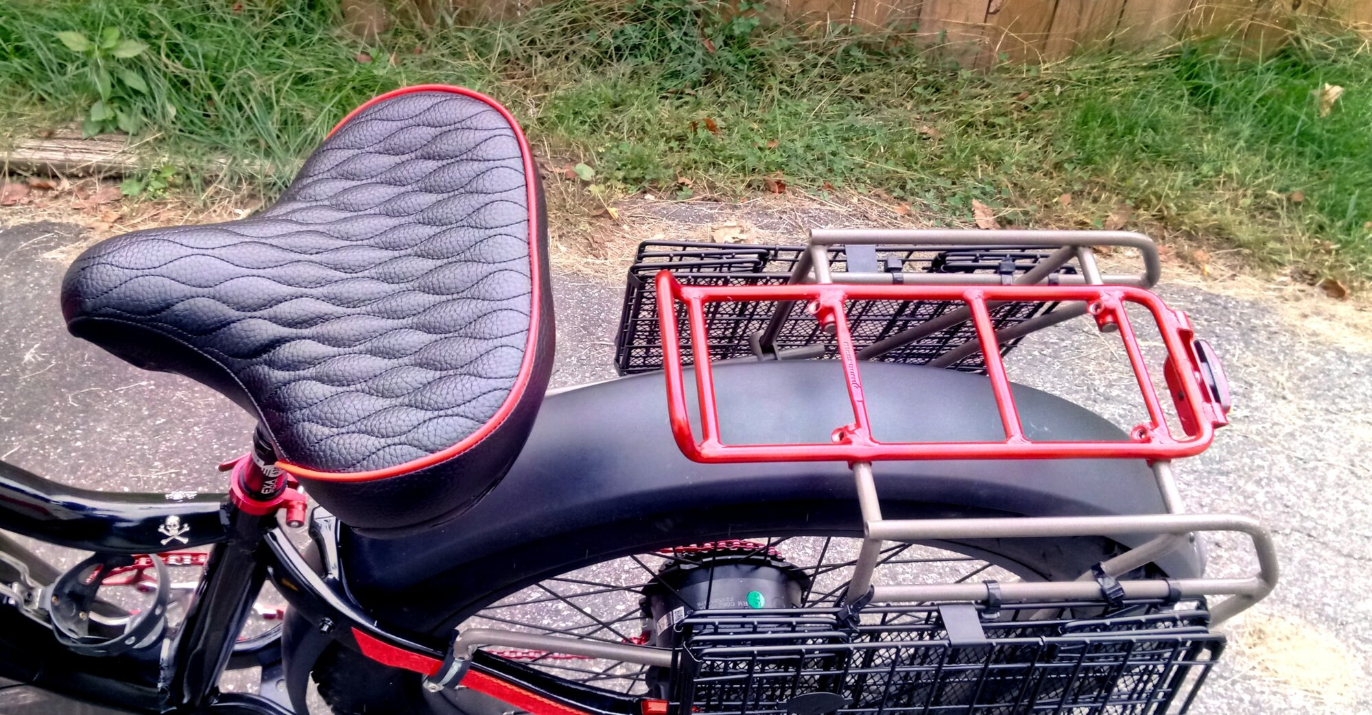

Updated pics. I made a couple of my own mounts for the rear rack stabilizer bars out of parts in my plumbers kit,, since the frame mounts are just too far forward. I SHOULD probably just drill and tap proper mounts, but I don't like drilling into structural members if I don't have to. While I had the rack off I gave it a shot of the same candy apple red I used to cover the yellow stripe on the top tube. Cleaned with IPA, three coats of candy, two coats of clear.
Likewise my final -- and way more comfortable -- seat arrived. Sure it's a "Cheap" Fimo branded one, but I'll stack this against the butt floss narrow seats that direct every blasted bump directly to my tailbone, or the "hump" seats that direct all the force to bones that are already under too much stress when sitting.
Also added cheap reflective sticks to the front wheel, and did some more cable management replacing their tight wrap with some simple vinyl conduit. Ignore the light cord dangling down, that's usually stuffed into the bag.
Close up of the seat and rack
That candy coat pops a lot more in person as you can see the silver flake / reflection showing through the candy coat. Still not sure if I'm gonna hit the tan parts of the rack with black, red, or not at all. Good rack this Blackburn, I just wish the welds didn't look more like JB-Weld than actual welding. Greatly conflicts with Aventon's clean and finished frame welds, which is another place they really seem ahead of the game compared to other makers. I forget what brand it is, but the local shop here has one bike they want $4500 for where the post welds are so ugly it makes me wonder if the frame builder even knew how to weld.
The bike looks great. I like the red accents. I usually use P clamps for this as you did. However, rivnuts are the way to go if you are going to drill into the frame. It is a threaded rivet that is inserted into the hole and secured with a rivnut tool. It would be hard to tap a thin walled tube or aluminum frame.
https://velo-orange.com/products/p-clamps-for-fender-attachment
MTA: I would only drill into the larger down tube or seat tube. Not the seat stays.
Good to know. 6v is within the range of the controller in the light I'm using... any idea what the amperage limit is? Max the light I have can pull 15 watts, which shouldn't be an issue, but... you know how that works. There's what it can do on paper, and then there's reality.
Half tempted to just dig into the frame, put one of the MANY buck's I have here in tapping the battery directly in parallel with the controller, though I'm not sure how/if that would impact the controller's behavior. Especially since this coming month I'm probably putting something newer and brighter on there. This is kind of a stopgap using spare parts off my normal bike.
At least then I wouldn't have to deal with the garbage "dimming" behavior.
I was just surprised that even the largest ones in my box weren't big enough for the bike, so I had to double-up.
Thanks for that, I may look into it, though these seem plenty secure... oddly, I think I like how they look better than the on frame mounts did.
The drivetrain:
We take a look from the other side...
The drivetrain:
