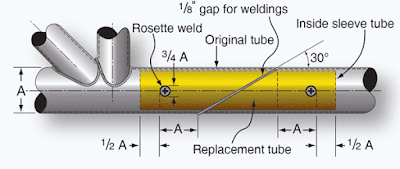

Could be a warning about the future life of that frame. When the break is just off the weld, it usually means their was too much heat and brittleness in the welding process of the aluminum. The safest way to fix just that break is to add another smaller diameter piece inside the tube to spread the load across that seam, then have it all welded up. Start doing a weekly inspection around all the weld joints and really study that thing for cracks. You used up one life on that failure, no need using up more by ignoring the issue.
I agree that this could be fixed easily with a sleeve weld.
