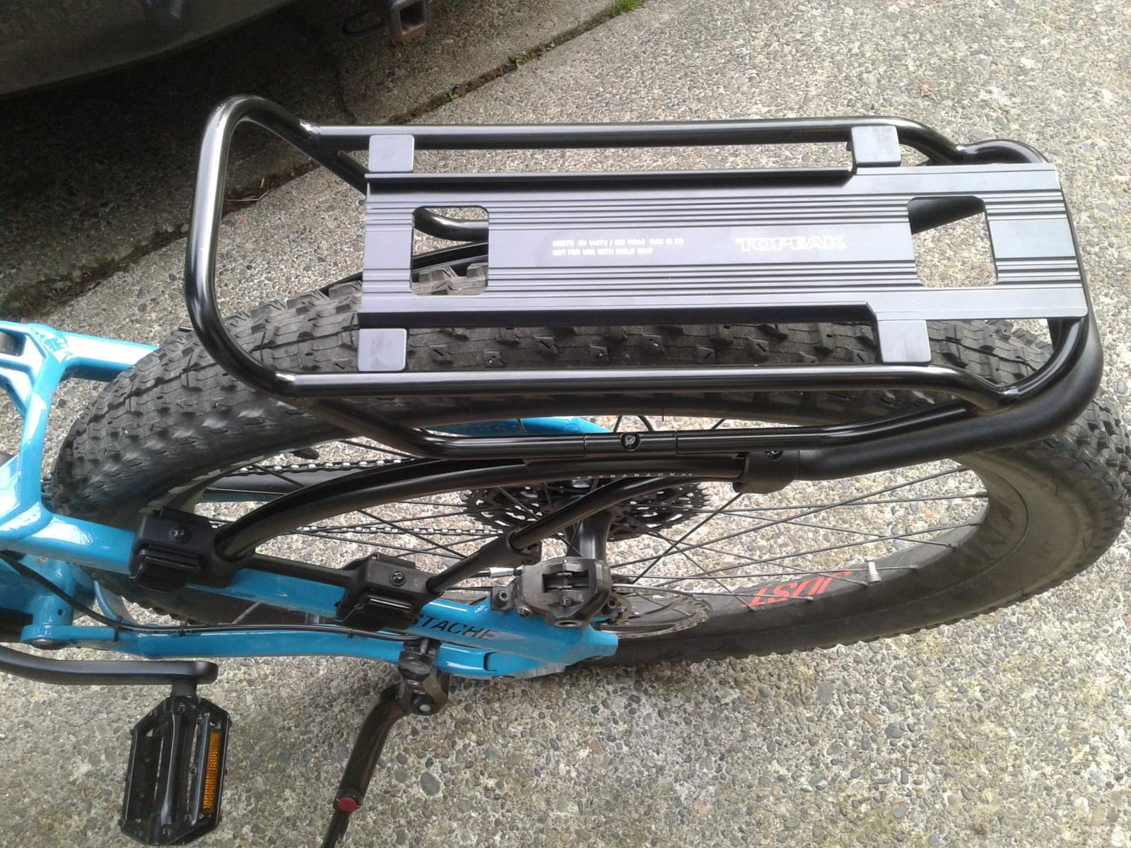

Those are 2.8" tires in the pic. It fits well on my bike but yours may be different. I use it to solidly hold a pair of powerpack 500,s in a Klickfix rackbox. Read about it yourself here: https://www.topeak.com/global/en/products/tetrarack-series/1286-tetrarack-m2-(mountain). And here is the userguide. https://s3.topeak.com/storage/app/m...-series/TETRARACK_M1_M2_2020_0207_A2_line.pdf

Yup I do. It works great. It can hold 25 lbs.View attachment 54870
Trying to determine if it will fit my bike.
What is the width on your seatstay?
My bike also has 2.8" tires. Hub spacing is boost 148mm
The manual for the tetra rack m2 states that the seatstay width on the bike must be between 95mm and 125mm.
My seatstays have a slight curvature on them (yours appear to be straight), and I measured the seatstay width on the bike to be 115mm to 150mm over the length that the rack would mount to. So, it appears that it won't fit.
I do not have the seatstay measurement info. You can try to find it if you like. The bike is a Moustache Samedi Race 4 (2019)
