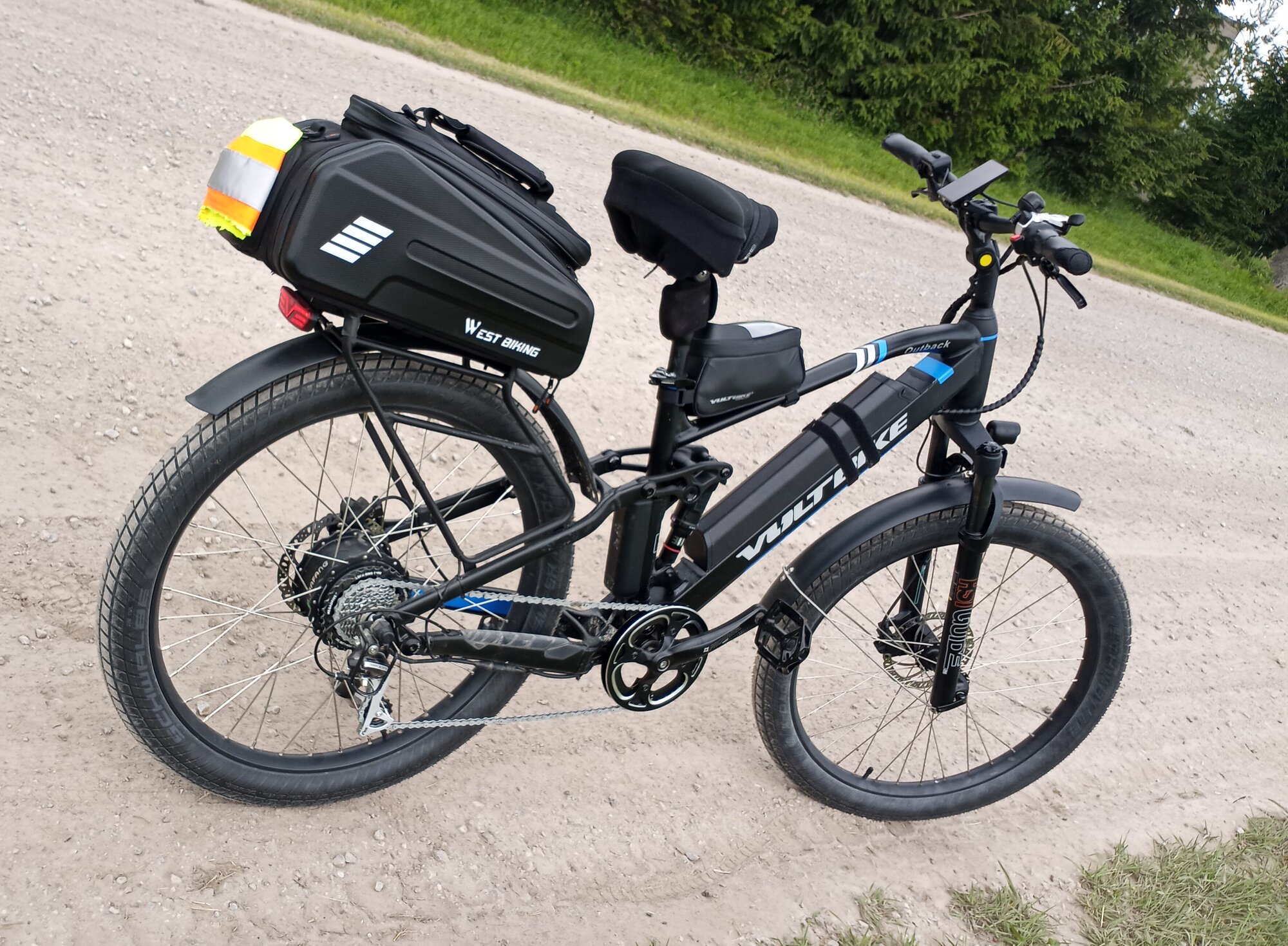

I have three 48 Volt batteries, a 19ah, 21ah, and a 25ah.
I charge them all to 52.6 Volts. I have two with me for my rides, and cycle through the batteries.
If I'm going on a short ride, I'll top up one of the batteries before the ride, and just take one battery.
My battery case design is soon to become extinct, so I bought a new e-bike that uses the batteries before e-bikes with Reention style batteries are also unavailable.
Downside is weight..
Yeah, my e-bike is close to 100 pounds with the two batteries, but it doesn't matter much with all the range I've got.
