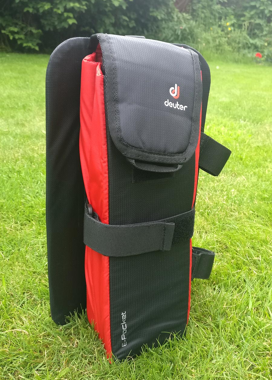

Detuer e-Pocket backpack insert has arrived.
Deuter E-Pocket
Dimensions and capacity:

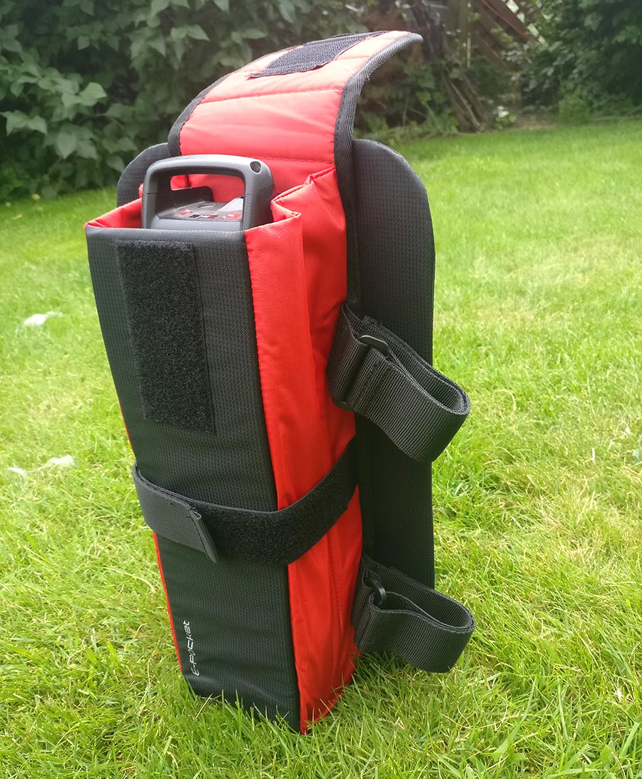

With Yamaha battery (overal high quality, battery pocket padding seems strong):

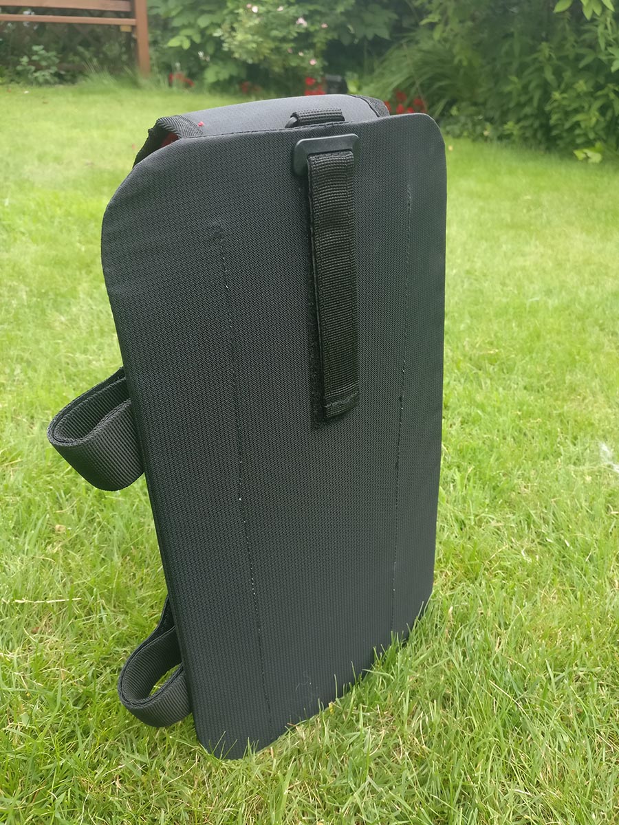

The back reinforced plate is stiff but thin. Proper dimensions for the backpack, for the panniers a bit small.

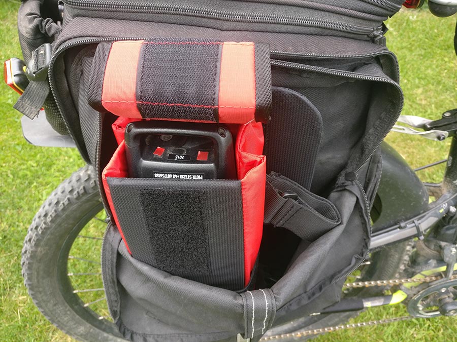

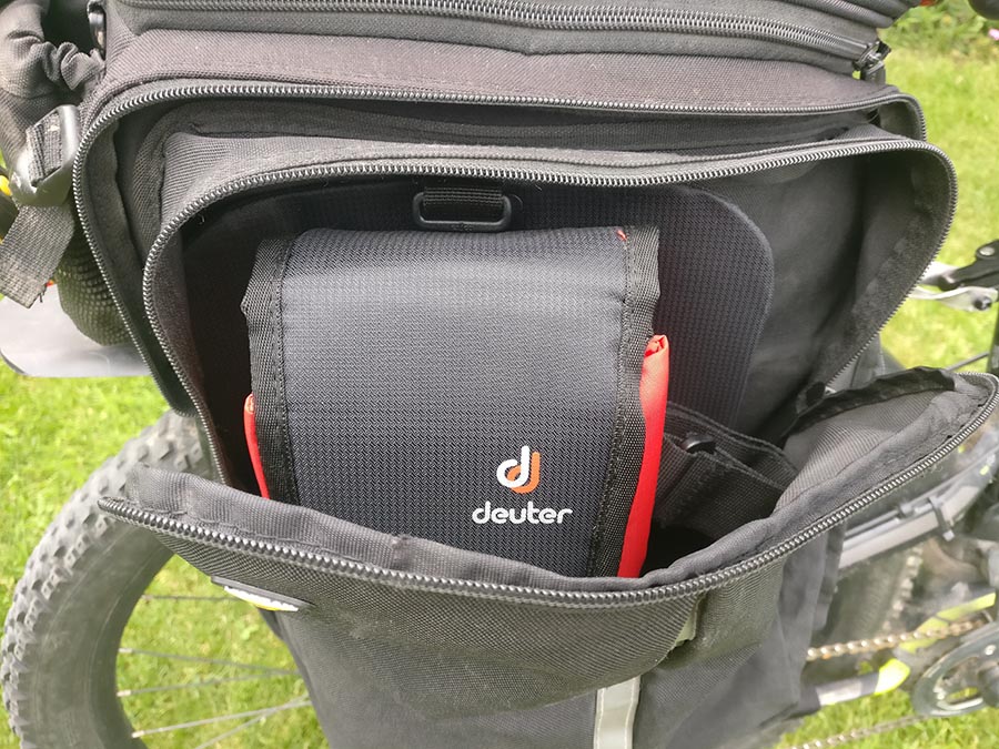

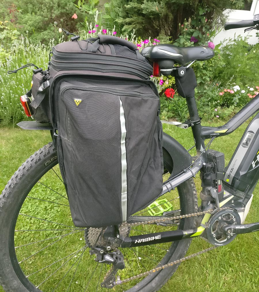

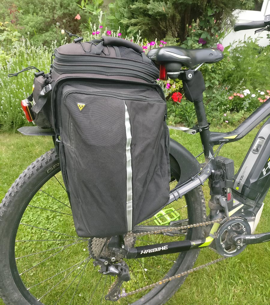

How it works with Topeak MTX Trunkbag DXP (I would say nearly perfect - the backplate it a bit small, but with the pannier closed the fit is perfect, the battery is not moving at all, possibly the zipper is under a bit too much tension):

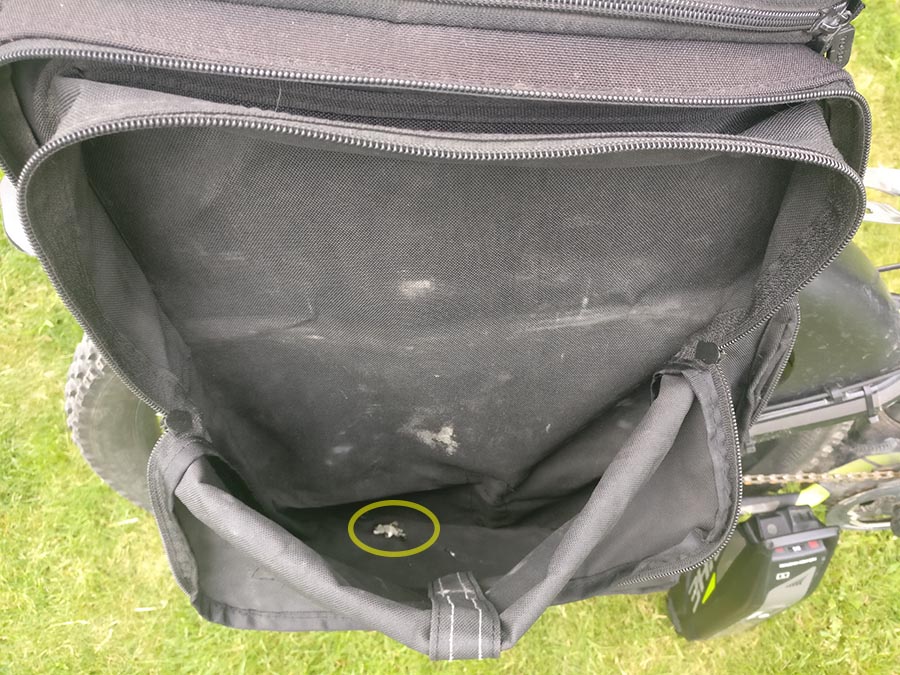

And this is what happens if you ride too much with your battery just tossed into the bag (without the padded protection of the e-Pocket). I hope the e-Pocket will remedy this (holes on the bottom caused by the heavy battery). This could be probably avoided by putting a piece of cloth between the battery and the pannier.

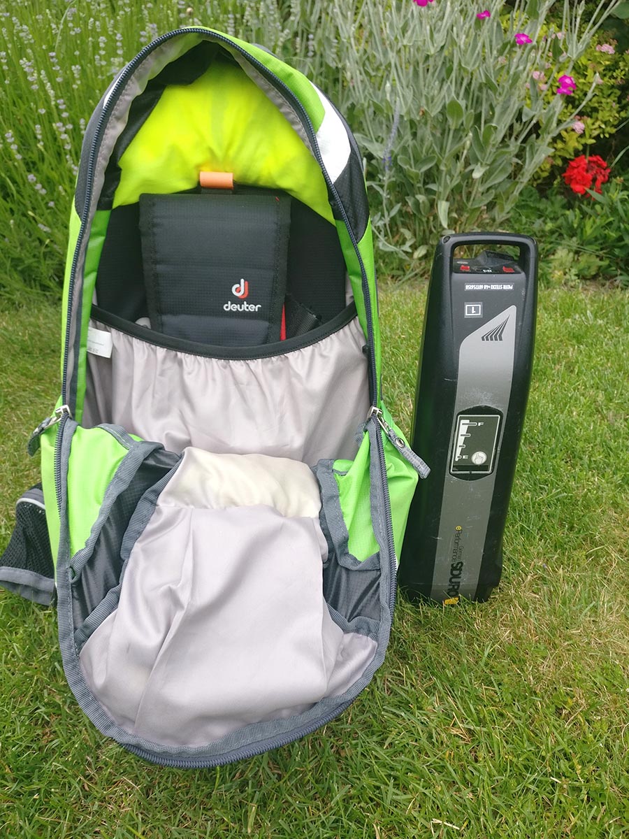

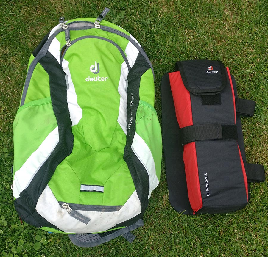

And as originally intended by Deuter, with their Superbike 18 EXP backpack (for more aggresive riding):

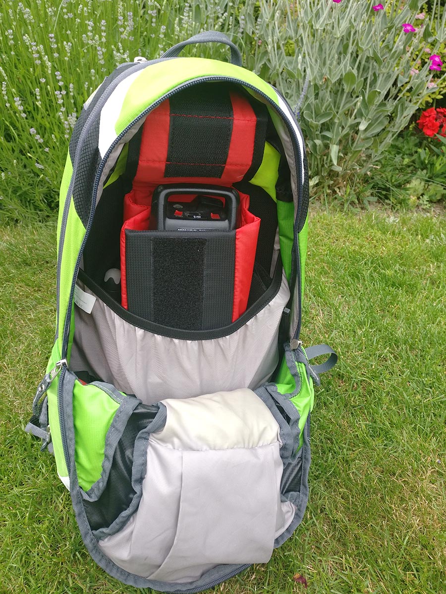

The backpack layout helps to keep the e-Pocket in place - the internal waterpack pocket + orange strap at the top - part of Deuter backpacks (while the pocket in the backpack helps with the stability, the strap I don't consider critical):

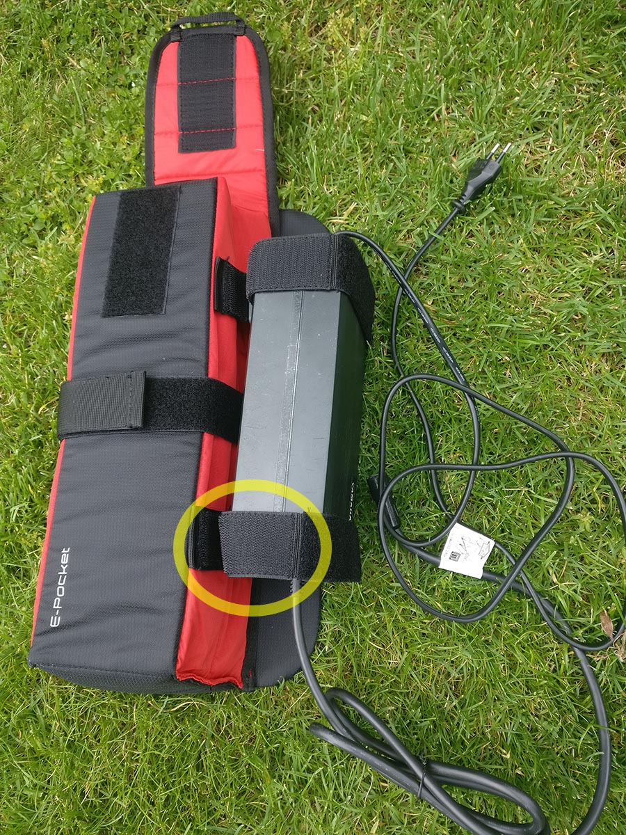

And finally - the velcros for keeping the power supply in place are too short for Yamaha power supply (you can check this even at their company photo on the label - the first one in this review):
Deuter E-Pocket
