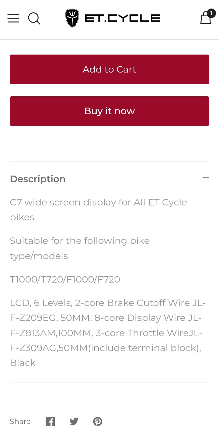

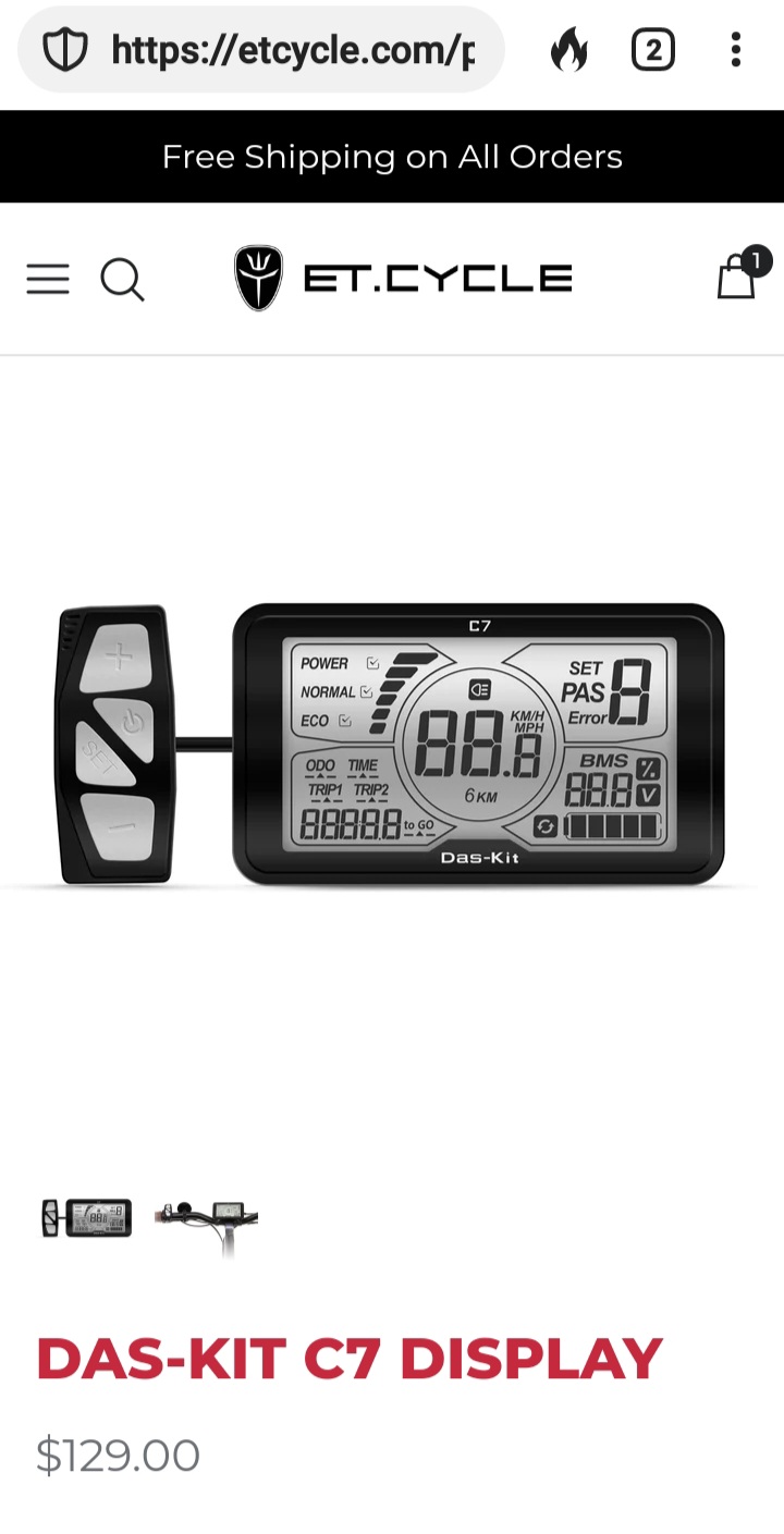

They may not ship it to Australia or Europe?
The C7 display seems to be sold out everywhere.
Leoncycle may be sold out too, but I'm sure their website will take your money?

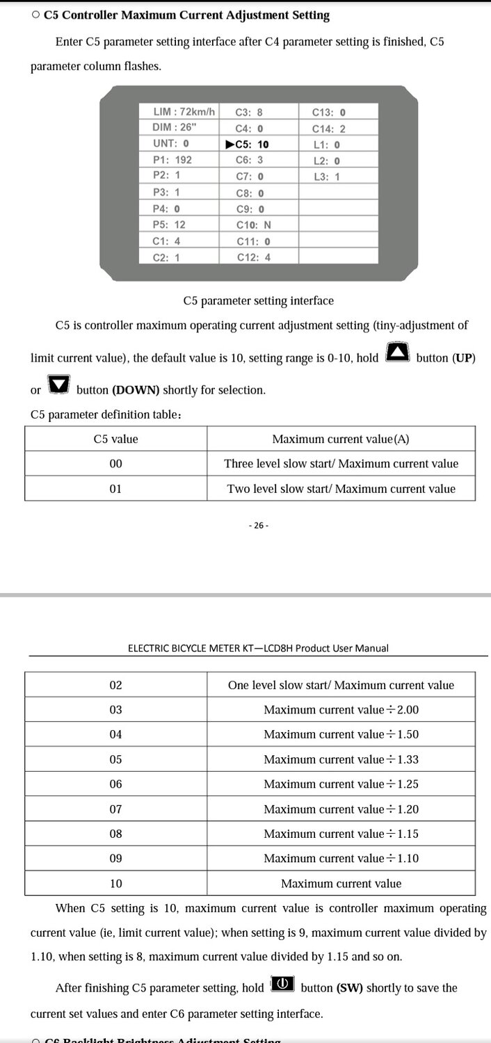

I'm 98% sure that your motor is a 500 Watt motor with a 750 Watt peak.
18 amps × 48 volts is 864 Watts.
My low voltage cutoff on my Reention Dorado battery is apparently 42 volts.
18 amps × 42 volts is 756 Watts.
My fully charged battery is 54.6 volts
18 amps × 54.6 volts is 983 Watts.

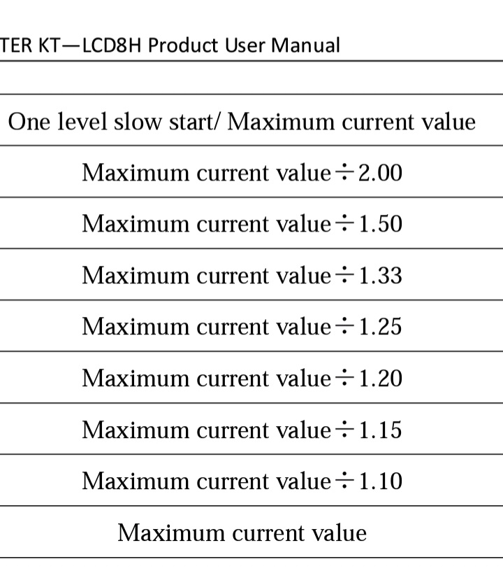

A 25 amp controller may overpower/overheat your motor and burn up your motor cable,
but you can reduce the maximum power of the KT controller.
So you can select the maximum power to be,..
12.5 amps, 16.7 amps, 18.8 amps, 20.0 amps, 20.8 amps, 21.8 amps, 22.7 amps, or full power of 25 amps.

My ct6-fb controller max 18a compared to US 22a
My dehawk battery max current output 15a idk what the US one is but I would be higher
Plus the display differences
And I dont even know if the motors are the same
These differences would would make a difference wouldn't they?
Or if I go the US controller I'll get 45kph on PAS with the AUS performance? @PCeBiker
The offroad display can be set too 32kph throttle and 45kph PAS but max speed is 32kph for both
I can do 32kph on the throttle which is perfect but I also want 45kph on PAS but I'm now thinking it will be to expensive to achieve.

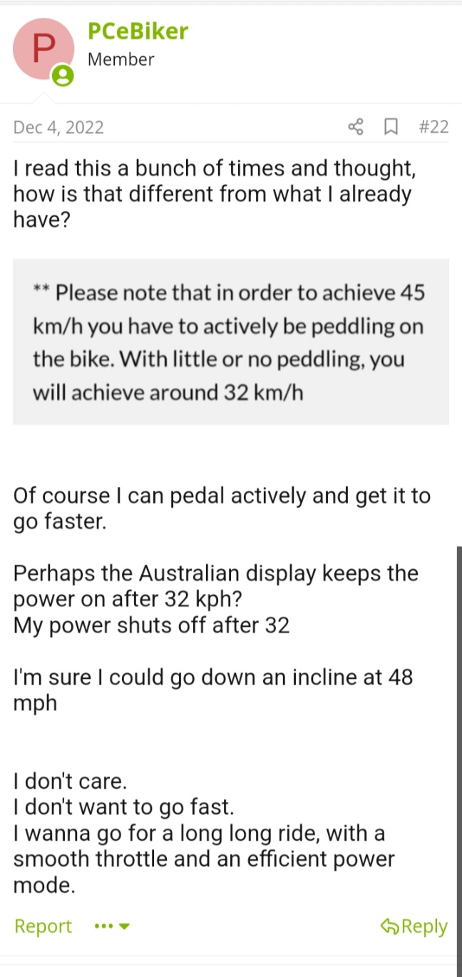

It's all maxed at 32 kph.
It doesn't matter what you do with any of the settings, the maximum speed is 32 kph changing wheel size doesn't work either, but the off-road display and my original display did it differently.
The off-road display did allow me to chose PAS mode 6 at 45 kph, but It Was A LIE !!
If you could get your hands on an American display, it will not cut the power to the motor until you have reached 42-48 kph.
Your BMS or Controller may cut out on you before you get to top speed.
(Which is a good thing.
You don't want to cook anything or burst into 🔥 's 😂)

How do I get my hands on a US display? Anyone got one? Anyone knows a US shop who will send me one? Etc
I contacted et-cycle in the US and they said they don't ship overseas

I can select the maximum power to be,..
12.5 amps,
16.7 amps,
18.8 amps,
20.0 amps,
20.8 amps,
21.8 amps,
22.7 amps,

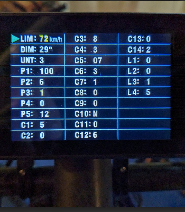

I'm removing my Das-Kit Controller and Display as well as my cadence sensor/PAS sensor because it is connected directly to the controller with a 3 inch wire, and I don't want any sensors on my bike at all.
I'll delete my speedometer too or just let it read 72 kph for kicks. 😂

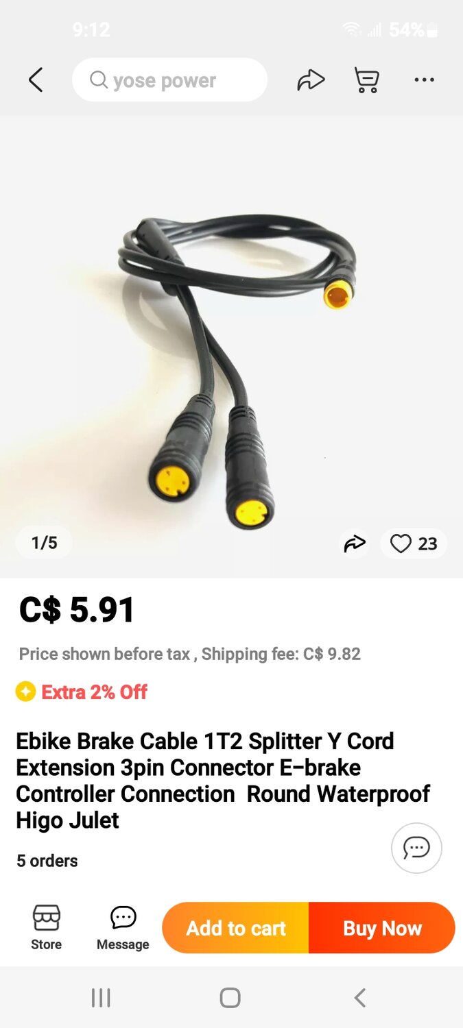

Just replace that stupid quick throttle with a thumb throttle👍🏻
I bought one.
Seven bucks,...
Most throttles come with the wrong end 3 pin connector on it but there's connectors to plug them in.
Male to male, female to female, or y-connectors..

Well, I'm not tearing into my motor to count the magnets and teeth on the gears to figure out the gear ratios, so I'll have to figure out how to get GPS on my phone to check the speed.
I'm going to enter whatever I need to, to get my speedometer to read 72 clicks. Lol
