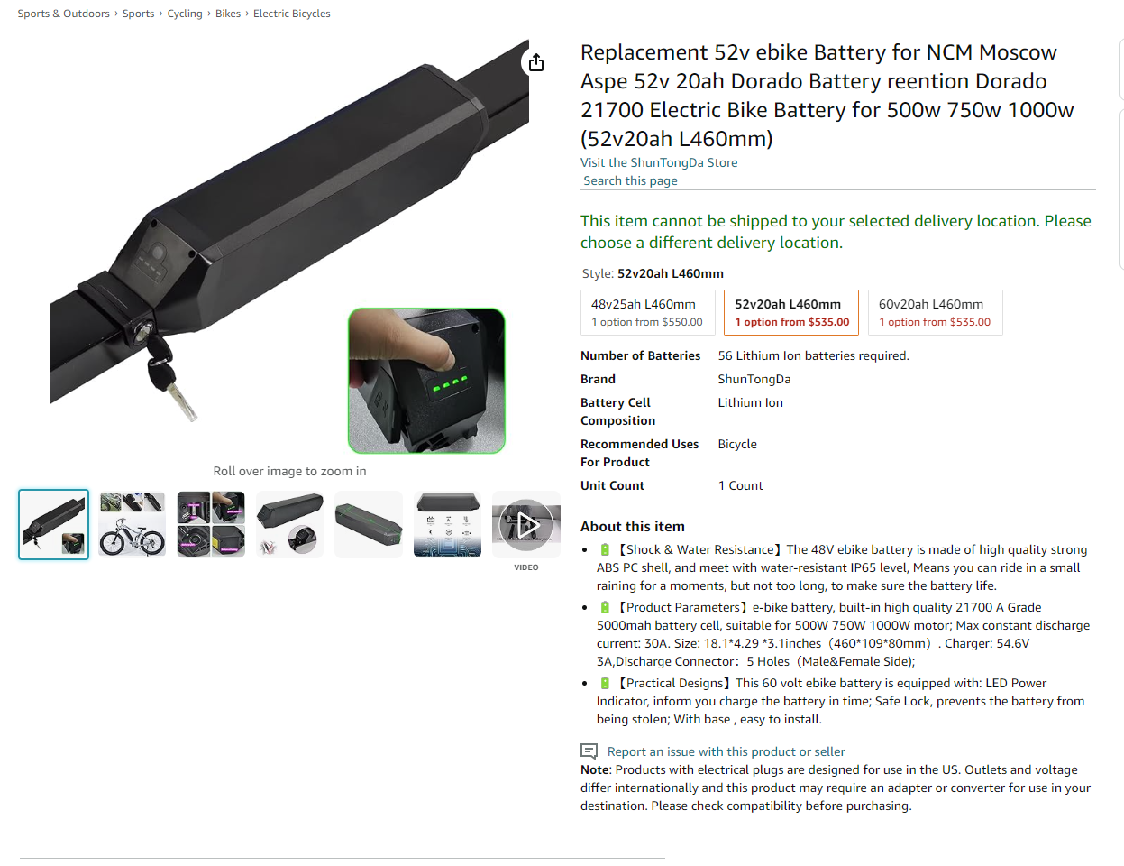

Hi.I need some advice. I would like to buy a new battery with the new 21700 cells. I found a lot of ads on aliexpress, even on amazon where they sell 52v batteries for NCM Moscow. Can someone confirm me if the Das-Kit CT5-I5 controller can work with a 52v battery? I read that the Das-Kit Controller CT5-I5 has a 60v Mosfet. Here's an example.
I remember this thread,..
The link in the link doesn't work.
I found it here,..
If it were me and I wanted to know, I'd hook up my bench power supply to the ebike, and turn it up to 58.8 Volts and see what happens.
It either won't work, or you'll get error code 2 or you'll blow it up. 😂
Or it might work fine?
Keep in mind that a lot of capacitors have a maximum voltage of 60 VDC, and 58.8v is pretty close to maximum.

the thing with the Moscow is that anything you change ....motor ....controller or the display you have to change the whole lot
