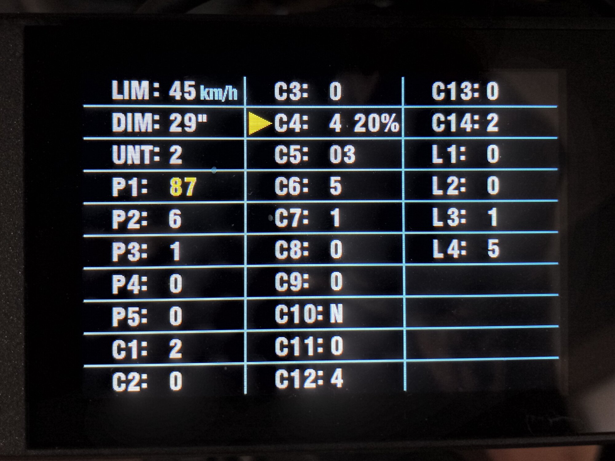

These are my display settings.
I turned my power/speed down to half and turned throttle gear down to 20% of full power.
(which would be 20% of 12.5 amps)
That's just for throttle gear 1 and the power/speed goes up with each throttle gear, up to the maximum power setting for throttle gear 5.
C5 setting from 00 to 02 only relate to PAS mode settings, and I didn't connect my cadence/PAS sensor.
C5=03 Is half power.
C5=10 Is full power, 25 amps.
(PS,.. 25 amps at full charge is 1365 Watts, and 25 amps at cut-off voltage (~40V) is 1000 Watts)
The bike REALLY slows down at close to cutoff voltage.

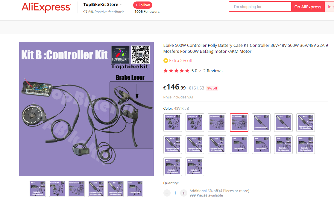

I found this complete controller on a forum that fits the das-kit completely, just needs to be replaced. I don't think I will spend any more money on this, I'm thinking of buying a Super 73 RX and the das-kit ebike I will give it to my brother. I think I will only change the throttle with a 300x Thumb throttle or a 20X Half Twist Throttle. I think the half twist throttle is much better, what do you think? What should I choose? Thumb throttle or half twist throttle?
https://www.aliexpress.com/item/33017453619.html?spm=a2g0o.cart.0.0.191538daZocEbM&mp=1 And I have one more question, does another display not work with the das-kit controller? For example, a KT display.

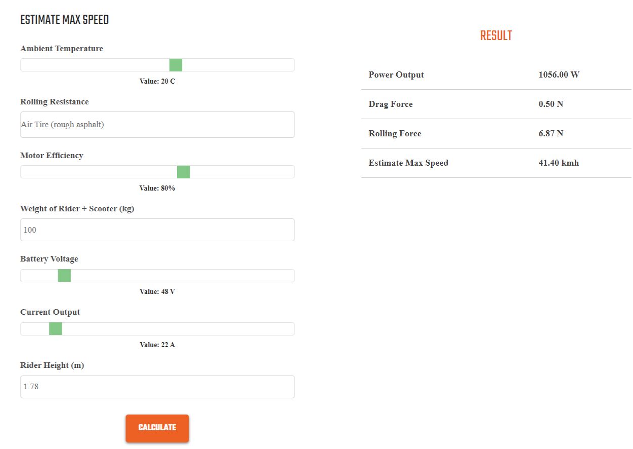

I have found this calculator, so the peak power of the das-kit CT5-I5 controller is 22Amp.My top speed on flat road is between 38-40kphn and And if I keep the wheel in the air, it reaches 45khp. If I change the tires to some full road ones like for example Super Moto-X, the speed will probably be a little higher. The cross tires slow the bike down a bit to reach maximum speed. https://www.falconpev.com.sg/pages/calculator
That's my understanding.
The the American version of my e-bike is unlocked with 22Amps available and goes up to 45 kph.
My Canadian version is turned down to 18Amps (500 Watts) and is speed limited to 32 kph.
The European version is limited to 15Amps (250 Watts) and is speed limited to 25 kph.
I'm pretty sure that all the limiting is done with the display, but there may be a bit of firmware in the controller for the different markets?

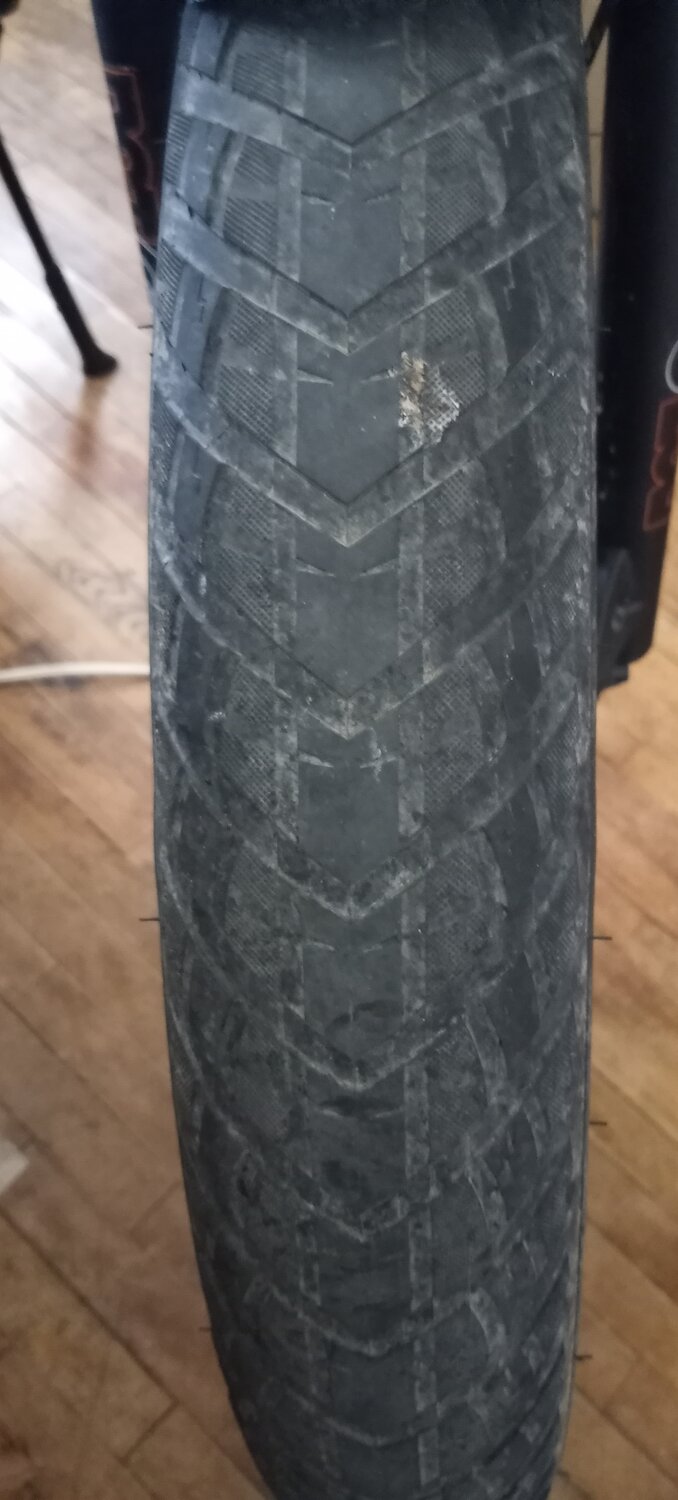

Keep in mind that your top speed is mostly dictated by wind resistance, but more efficient tires can only help.
Another thing about the Super Moto-X tires, is that you can start doing things like this on clean asphalt.
I've got street tires that allow me to do this,..
It's as FUN AF to lean into corners!!
You will just have to learn to not try it in the dirt.
It becomes intuitive.
