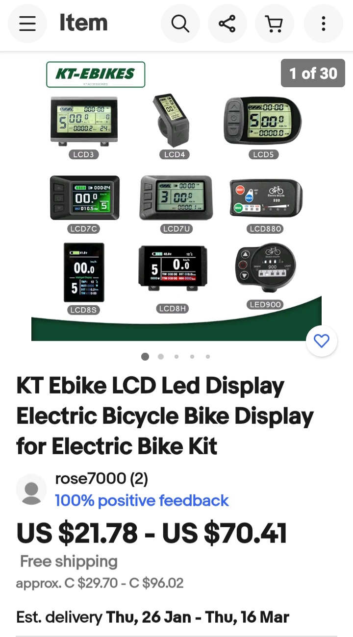

I'm pretty sure that these are my display options and I think that I want the regular LCD3 version unless it's not as functional and easy to play with as your color LCD8H version?

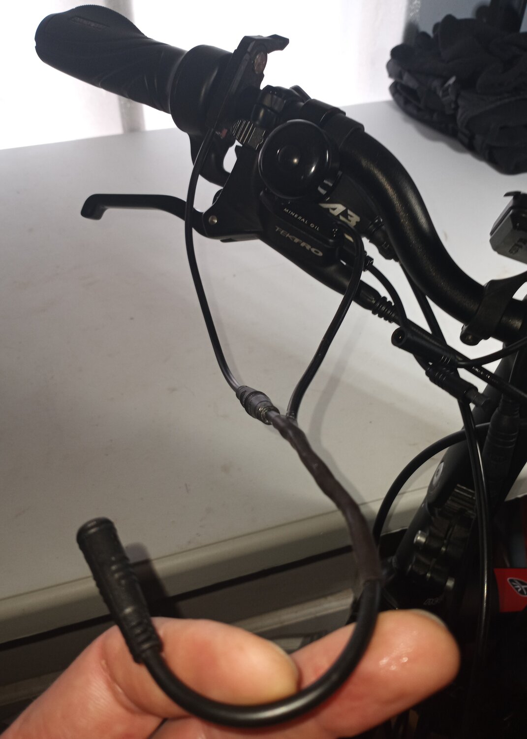

Do you remember how you connected your 2 pin brake cutout switch (or switches) to the 3 pin KT brake switch connector?
(I assume that your Moscow has a 2 pin brake switch like my T1000?)

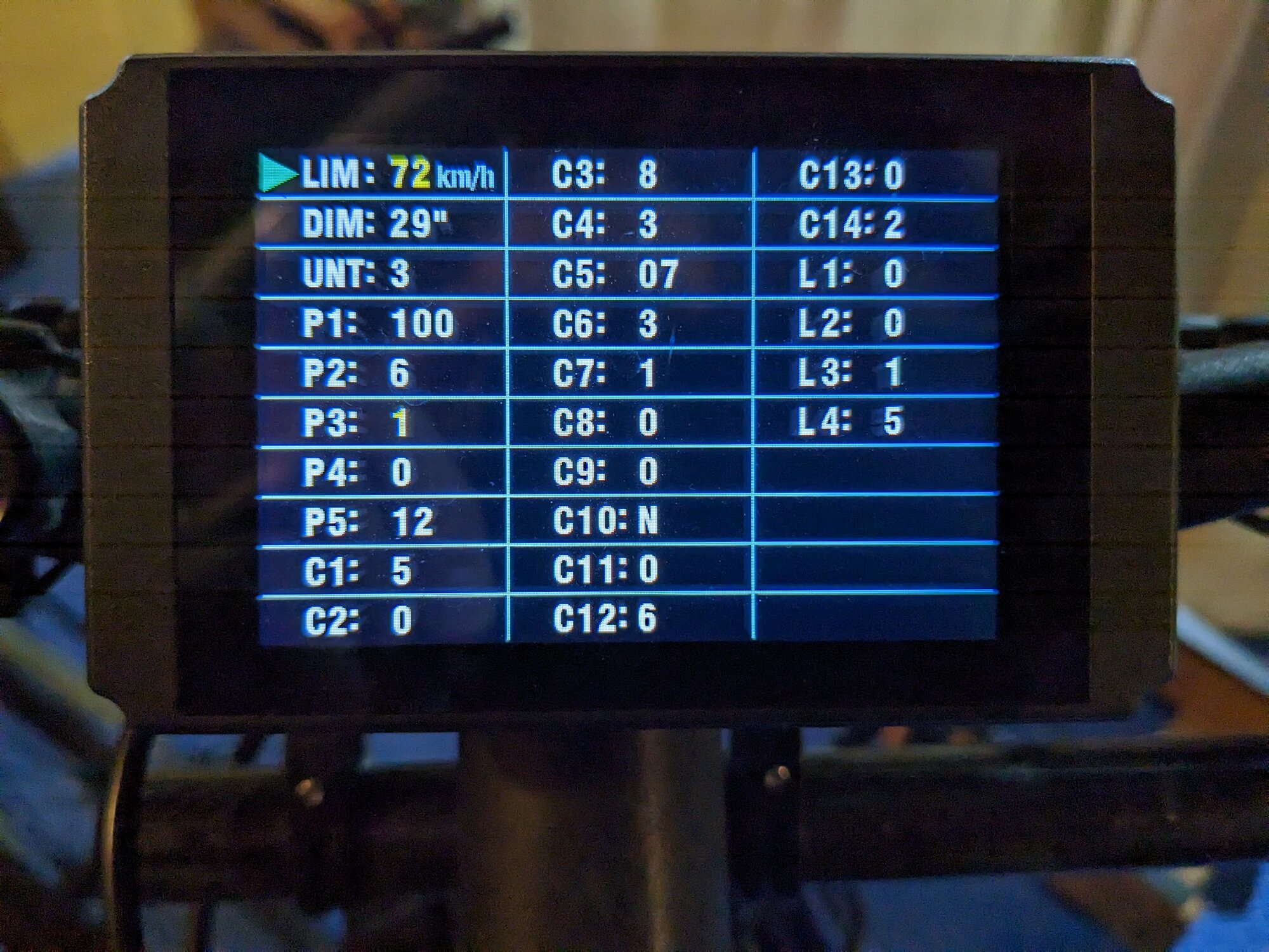

Yeah, if you find a way to configure the individual PAS levels, that would be a huge win. They're sort of configurable, as a whole, by adjusting the max current which basically seems to compress or expand a power level shape curve... also by altering the overall assist strength (ie eco, normal, sport/power, or something like that).
But yeah pick the right display. The settings are all done there, but I imagine they are saved out on the controller. Not 100% on this though. Sounds like the setup might work for you though based on your needs. The whole thing is definitely more responsive than the stock. You get the "constant current/imitation torque" setting that it seems most people do the conversion for which is nice, if you're pedaling. But, you can also set it to work similarly to the stock controller in that each PAS seems to be tied to a set speed. That set speed seems to be a bit more variable than the stock setup, but it's more responsive. Again, nice if you are pedaling, not so useful if you don't plan to much.
I didn't have to replace the brakes. I'll take a look in a bit and post back. I thought the brakes on the KT controller were still two pin and the throttle was 3. I can send you I bought on Alibaba if that helps. Not sure all the sellers are still selling the same stuff at this point but it could be useful.

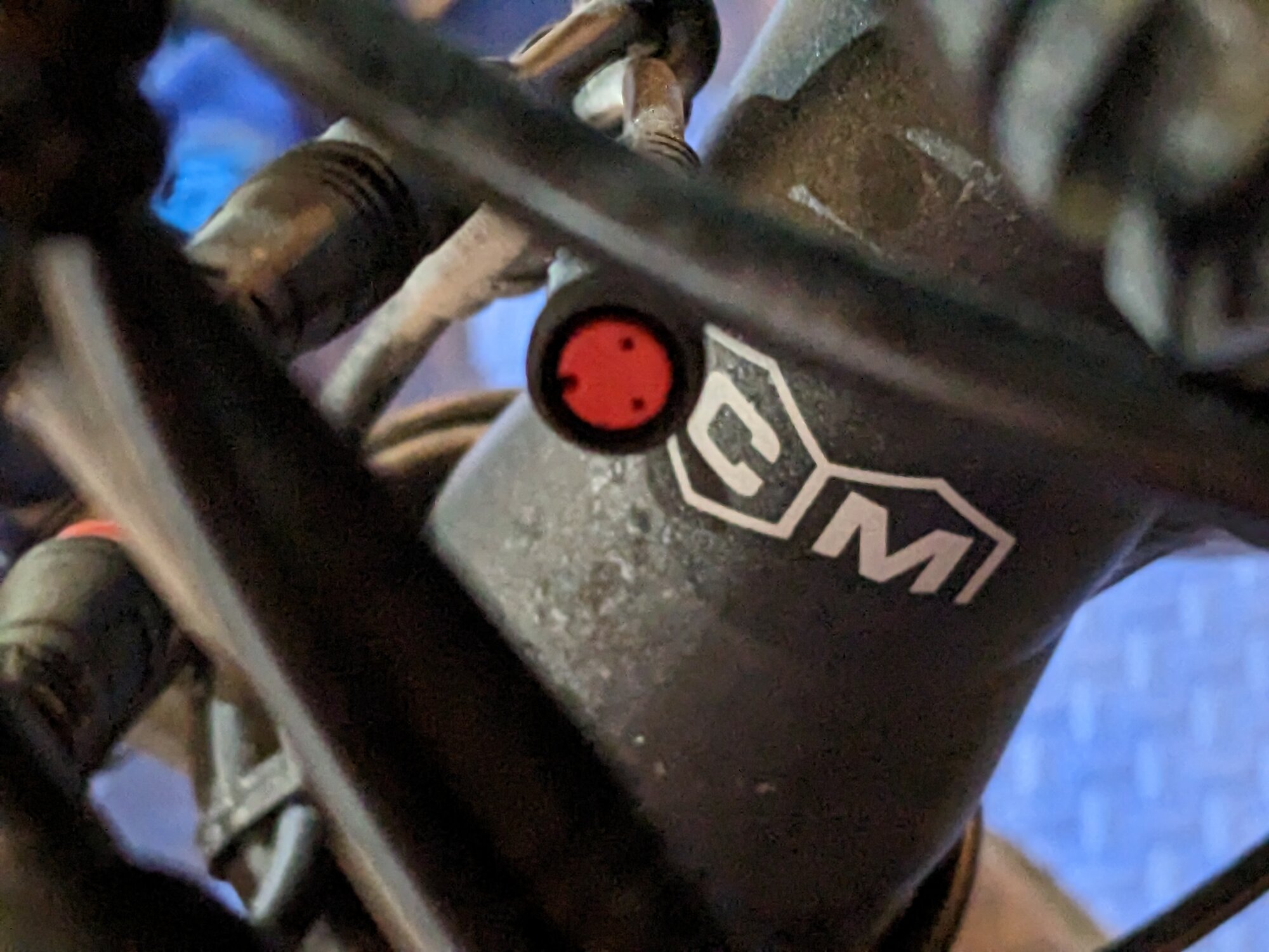

Here's some pictures that might help. The brake is two pin. What you might be thinking is the third pin is just a slot for the connector.

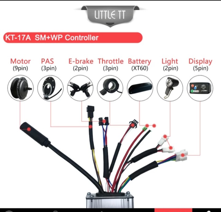

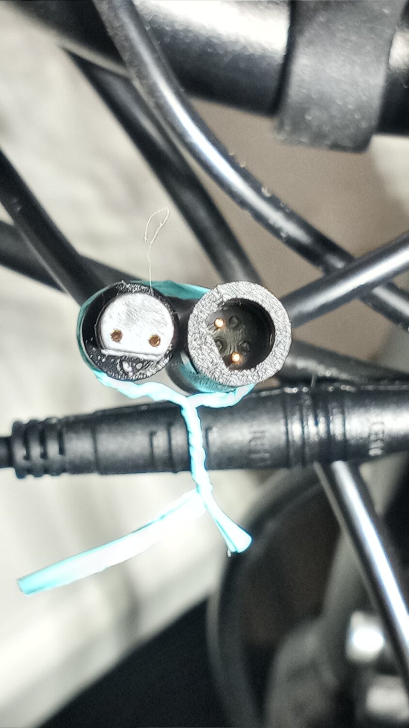

I'm actually investigating this right now and I probed my brake switch to find that it is just an on/off switch.
All the KT kits (as well as all the Bafang stuff) seem to use a three pin HALL sensor plug for the brake cutoff switches as well as the throttle and PAS sensor (cadence sensor in my case).
This is what I'm finding for all the KT stuff,..
I think that I figured it out.

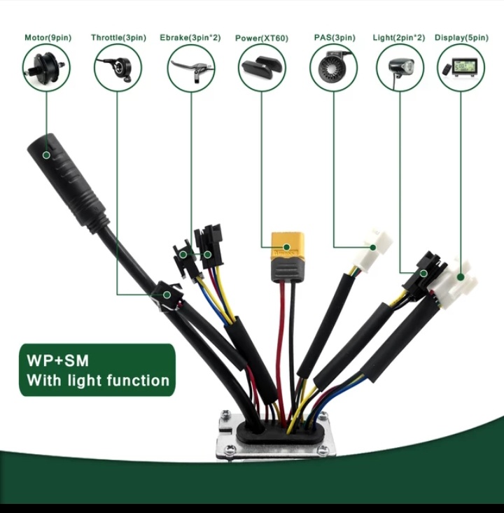

The kit that uses waterproof Julet connectors does use a yellow 3 pin Julet connector for the brake switch, but it is only using two of the pins.
These are the pictures of two identical KT controllers, one with Julet connectors and one with ordinary plugs,..
Screenshot_20230105-115010_DuckDuckGo.jpgScreenshot_20230105-114043_DuckDuckGo.jpgScreenshot_20230105-115133_DuckDuckGo.jpgScreenshot_20230105-115059_DuckDuckGo.jpg
The ordinary plug version lists the brake switch input as a two pin input, but has two different plugs to use in case you have a 3 prong plug.

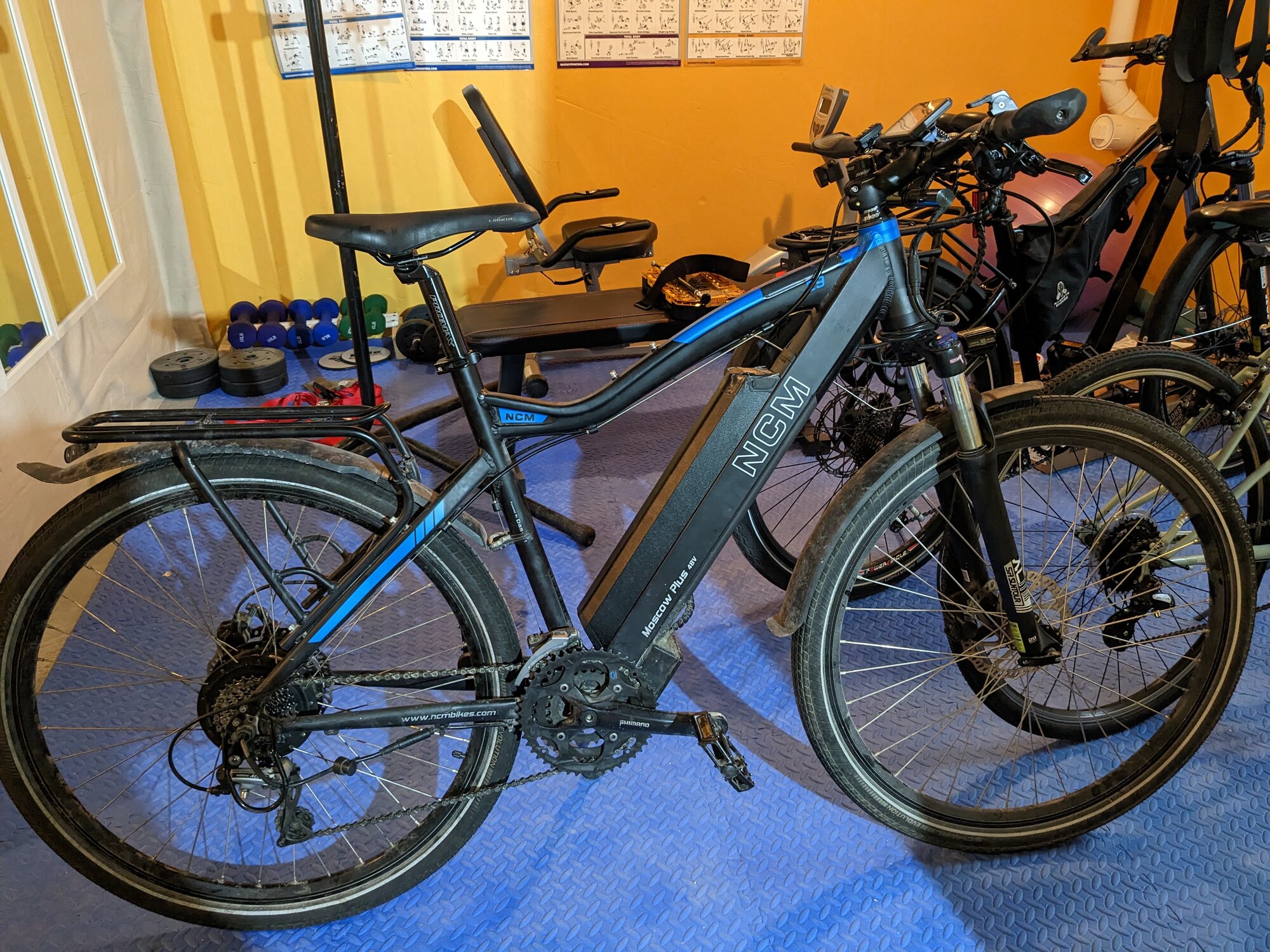

Now I know what my bike will look like with the KT Controller installed.
It's a bit bigger than the original.
Did you have to use the box?
The controllers I'm looking at appear to be built into a waterproof aluminum box.

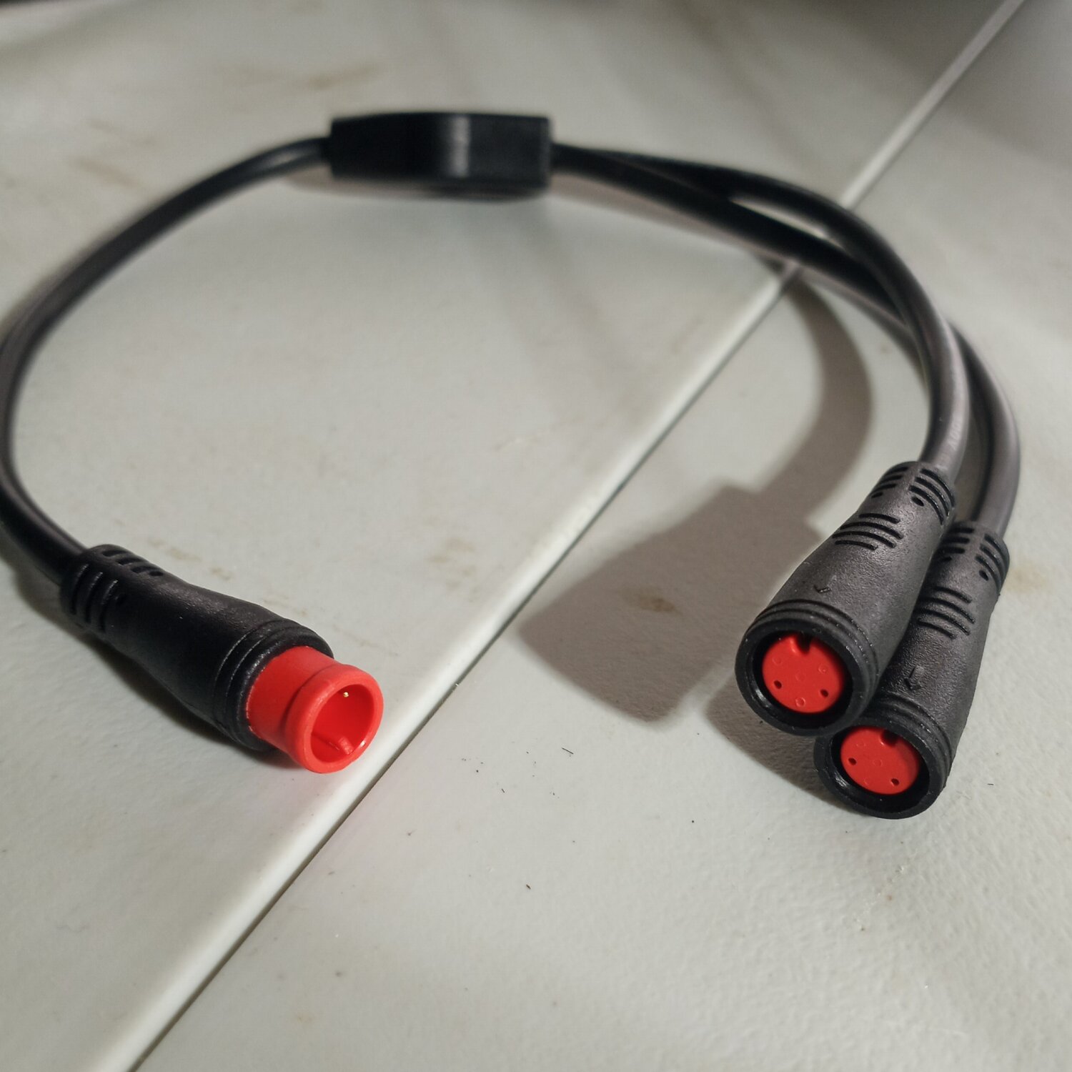

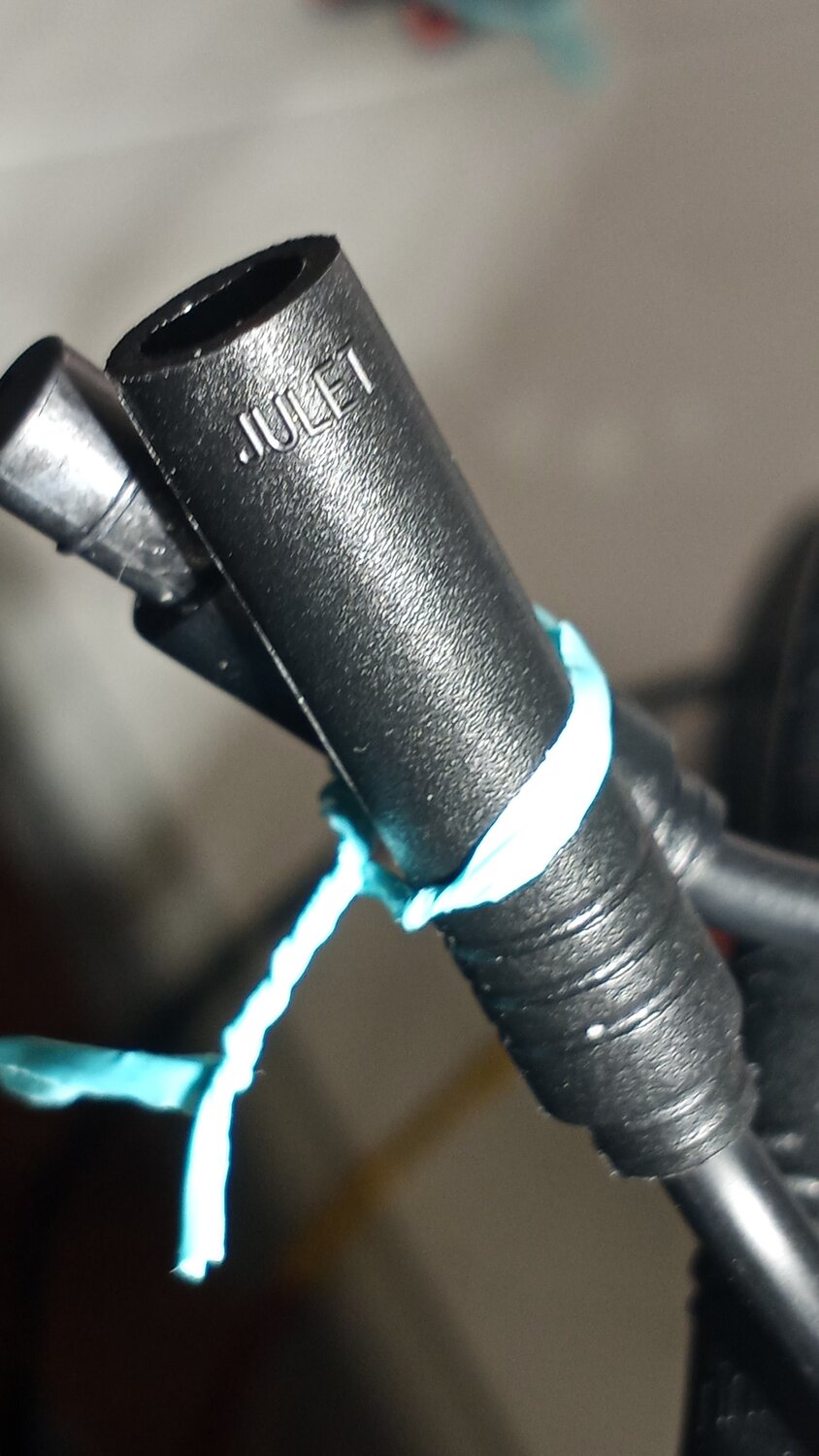

My Tektro brakes have some weird 2 pin Julet connector, so I'm going to have to cut and splice that wire.
I'll probably cut the wire off at the display so I can keep the plug.
This is the normal Julet Y-plug I bought thinking I could use it if I trimmed and shaved it down to fit, but even the pin spacing is different so I can't use it.

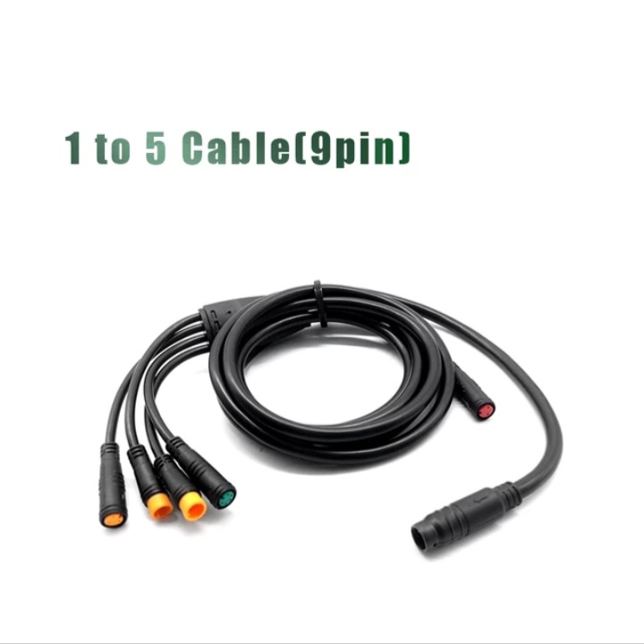

The controller and the 1-4 cable.
The 1-4 cable has an 8 pin connector.
The 1-5 cable has a 9 pin connector with the extra pin to turn on the bike lights when you turn the displays backlight on.
The controller that supports lighting, has another plug coming out of it to plug the bike's lights into.
I didn't have to use the box. I did as added protection and I felt it made it look a bit more finished. The box there fit the controller pretty well so it did not add to much bulk. The aluminum case is technically waterproof, but it's not potted so there is just a seal wedged between the box and the two lids. It made me a bit nervous to rely on that, and I didn't want to risk hitting the box on something, whether I was pulling the bike up over a higher curb or whatnot. That said, you're right it is bigger than the original. The aluminum box itself is. I think that's the only real downside to this conversion, but finding a way to bolt the controller down to where the original controller is, and routing as much of the wire internally, from that area, keeps it looking somewhat reasonable.
You've got the weird 2 pin brake connectors that I have. I did exactly what it sounds like you might be doing too... cut the connectors at the display. I made an adapter instead of messing around with the connector at the 1-4 wire or up by the brake. So one end connects to the existing brake connector, using the connector taken from the display and the other end connects to the 1-4 using a red julet connector I picked up on AliExpress.

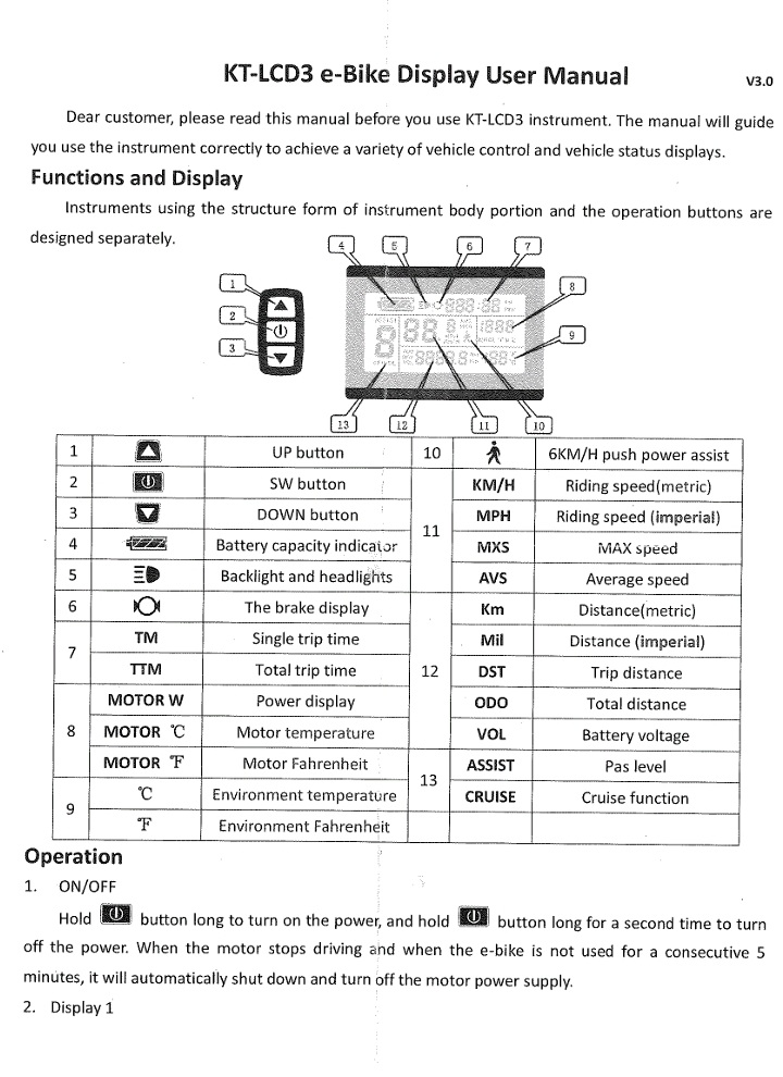

Fred sent me the manual for the display that I was thinking of, and it doesn't do much at all. It's only 4 pages long.
It doesn't allow me to turn down my controller.

So it looks like I'm going to get the same display as you, the LCD 8H.
(there's also a vertically mounted version, the LCD 8U.)
There is a version with a USB port, but I don't think I'd use it. I can just plug into my battery's USB if I need to.
There's also a newer version, but I don't like the swoopy 3D look.
I want to see a numerical readout of my Watts.
AliExpress doesn't show the button panel or the handlebar mount, but I assume that it comes with that?
I'm pretty sure the button panel is part of the display and wired directly into it?
Thanks, that's great news.
I know that this conversion can work for me then.

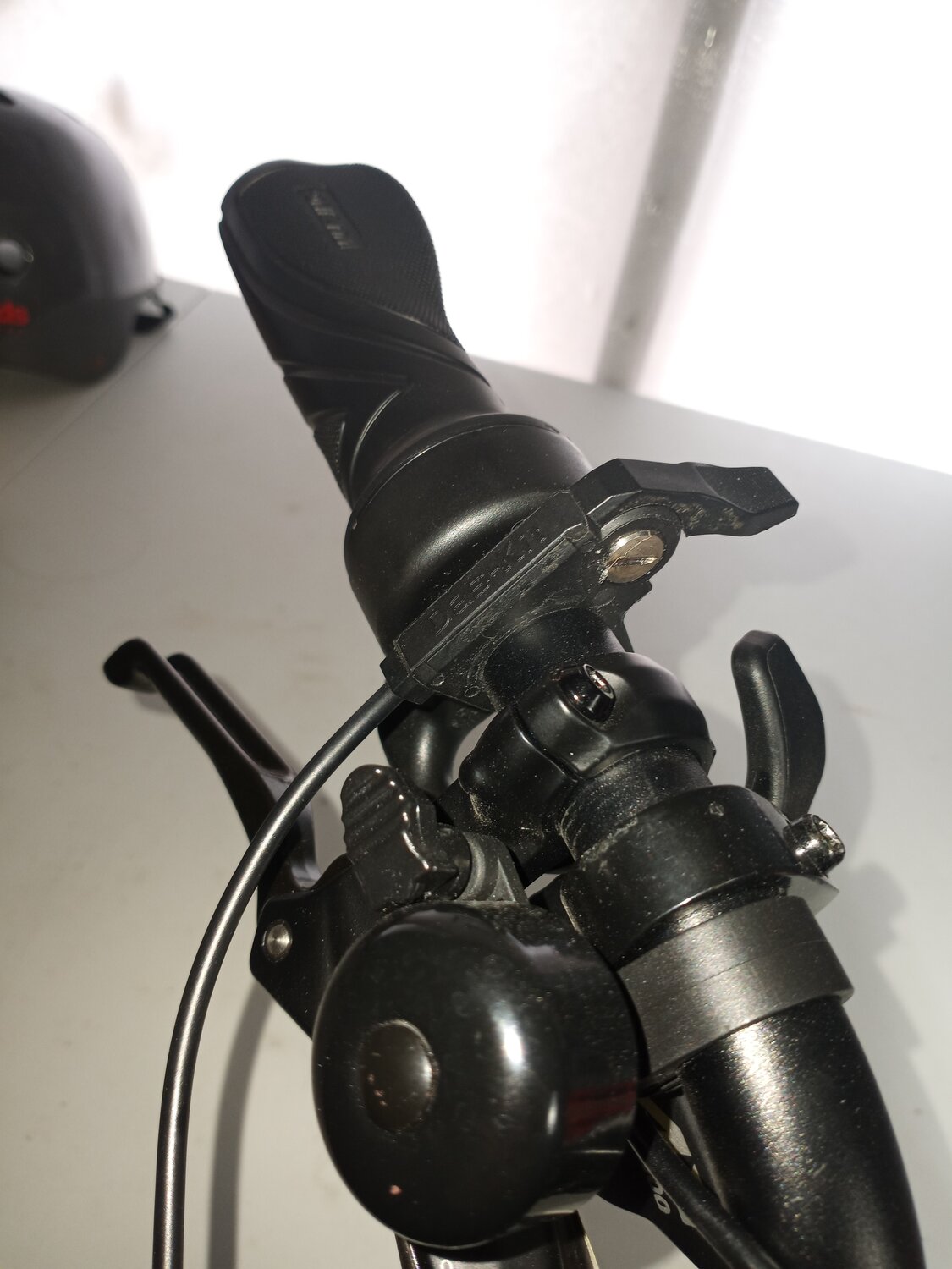

I made a similar connector to install a second throttle,..
I added a twist throttle and took apart my thumb throttle to replace the spring with a rubber washer so that it will stay where I set it.
Now I use the thumb throttle to set a cruise control throttle as a cruise control.
It works great (except when I hit it by accident once and almost launched my bike to a river. Lol)
The two throttles are hooked up in parallel and which ever throttle (or PAS setting) is set highest overrides the others.

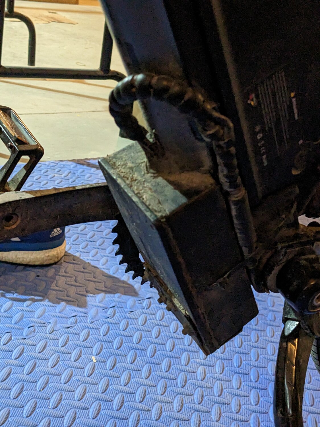

I was worried about heat at first. I used to feel around the box after riding the big with a lot of load and really didnt feel any heat... and that black box is pretty thin. Probably helps with the controller max current ramped down and I'm usually not hammering on it too much. Most of the time I'm using 100 to maybe 350w. Only spike to around 800 for short times, but I also let the bike slow down some on hills, and I'm pedaling too.

I read through that entire manual and I was a bit lost and confused by all the parameter settings.
My biggest concern is not knowing what motor is actually on my bike.
I believe it's a 750w 1000w peak motor that's just limited to 18 amps for Canada.
I have no idea what the parameters are and I don't want to have to open up my motor to count the magnets and gear teeth and spin the wheel to find out the gear ratio. Lol
But apparently the factory presets have worked for you, so I should be fine with the KT display/controller.

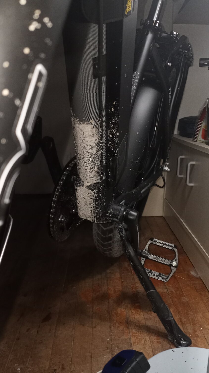

I think what I might do is trim an inch or so off the hollow semiround down tube so I can at least raise the box up higher so it's less inclined to get hit on the bottom?
This is my bike now and the controller is covered in crap.
So the controller is kind of in a precarious spot for spray and gravel and such, but it's not hanging below the bottom bracket.
