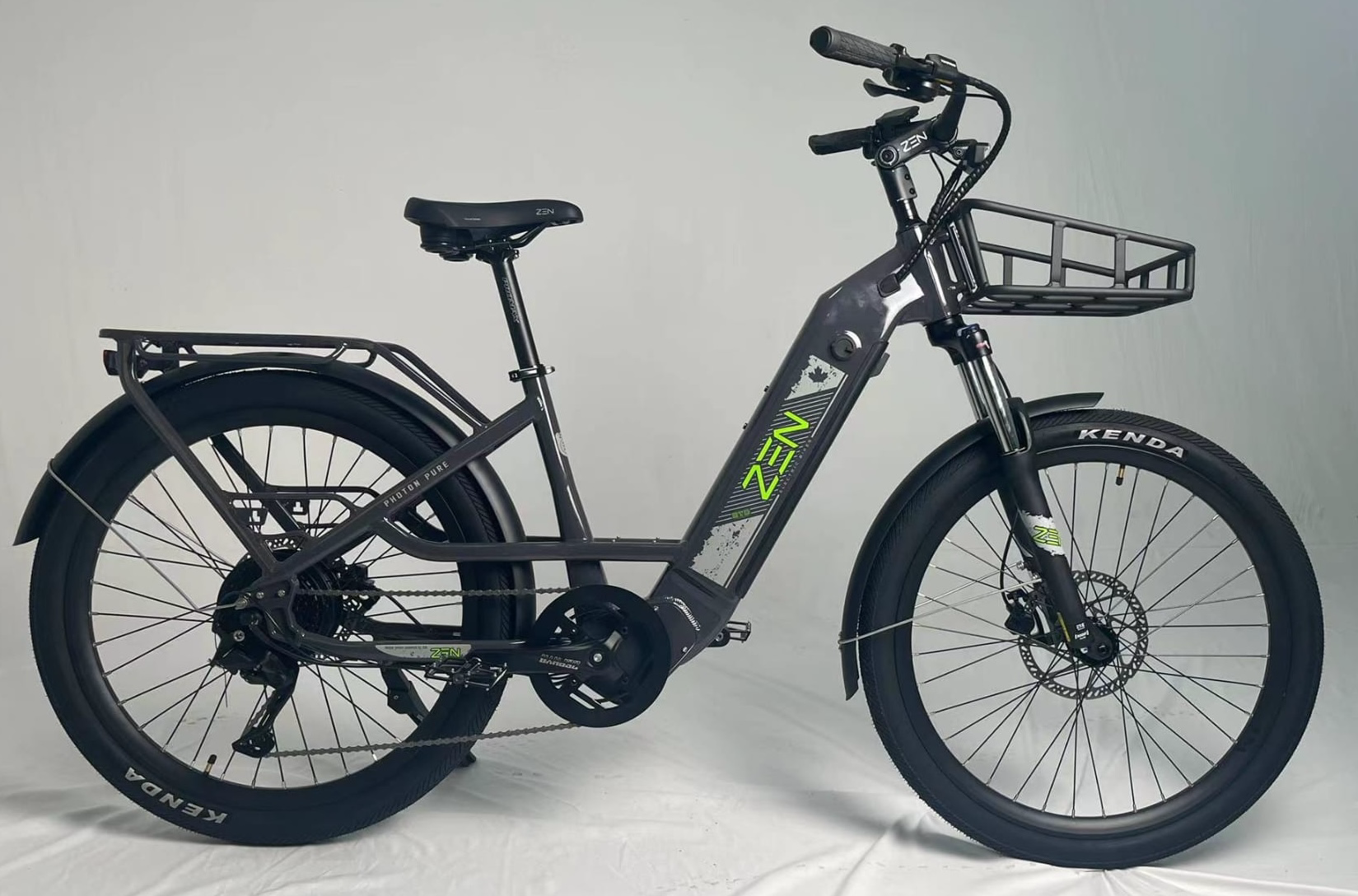

We are thrilled to introduce the Zen Photon Pure to the eBike community. This is our second model in the 2024 Photon series, with a 750W motor torque sensing motor, two battery options for extended range, and IoT capability for GPS tracking.
Specifications:
  • Motor : Zen 500W Canada (32 kph) | 750W USA (28mph) w/ High-resolution Torque Sensor
  • Battery : 52V, 15Ah or upgrade to 20Ah (UL-2271) battery with CANbus communication
  • Charger : Smart 4A UL-certified charger with temperature modulation
  • Controller: 12-MOSFET, 25A sine-wave controller
  • Shifter Rear : 9 Speed Shimano
  • Brake : Tektro E-350 brakes with E-cutoff
  • Fork : SR Suntour XCM-32 Boost suspension with thru-axle and boost spacing, 120mm travel
  • Tire : Kendra Kwik seven sport - 27.5" x 2.4" E-bike specific tires
  • Throttle : Yes
  • Seat Post: Standard seat-post
  • Assist levels : 5
  • Color : Lime Green, White, Grey
  • Warranty : 3 Yrs (Battery)
  • Lights : Adjustable stem and integrated 400 lumen lights
  • Display : 3" LCD display with USB-C charge port
  • Integrated rear rack and optional front rack
  • IoT capable for GPS tracking
$100 off first 50 orders in the USA and first 50 orders in Canada! Accepting orders from first week of February.

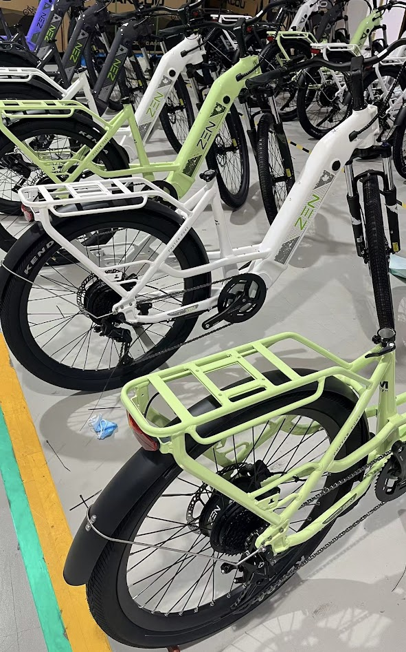

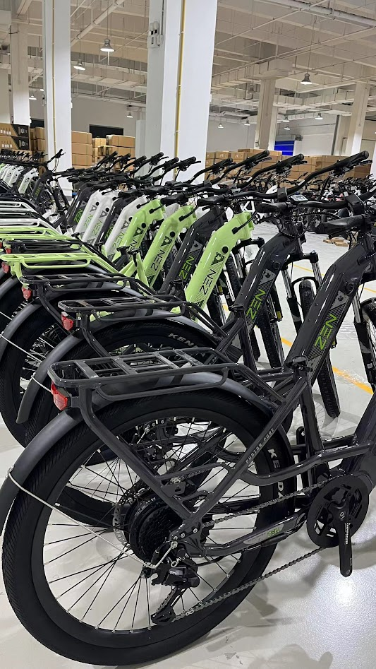

75% assembled Photon Pure bikes leave our factory tomorrow and get loaded on the container. Tne vessel is expected to leave Feb 9th or 10th.
The rest of the assembly, QC will happen in Halifax, Canada.

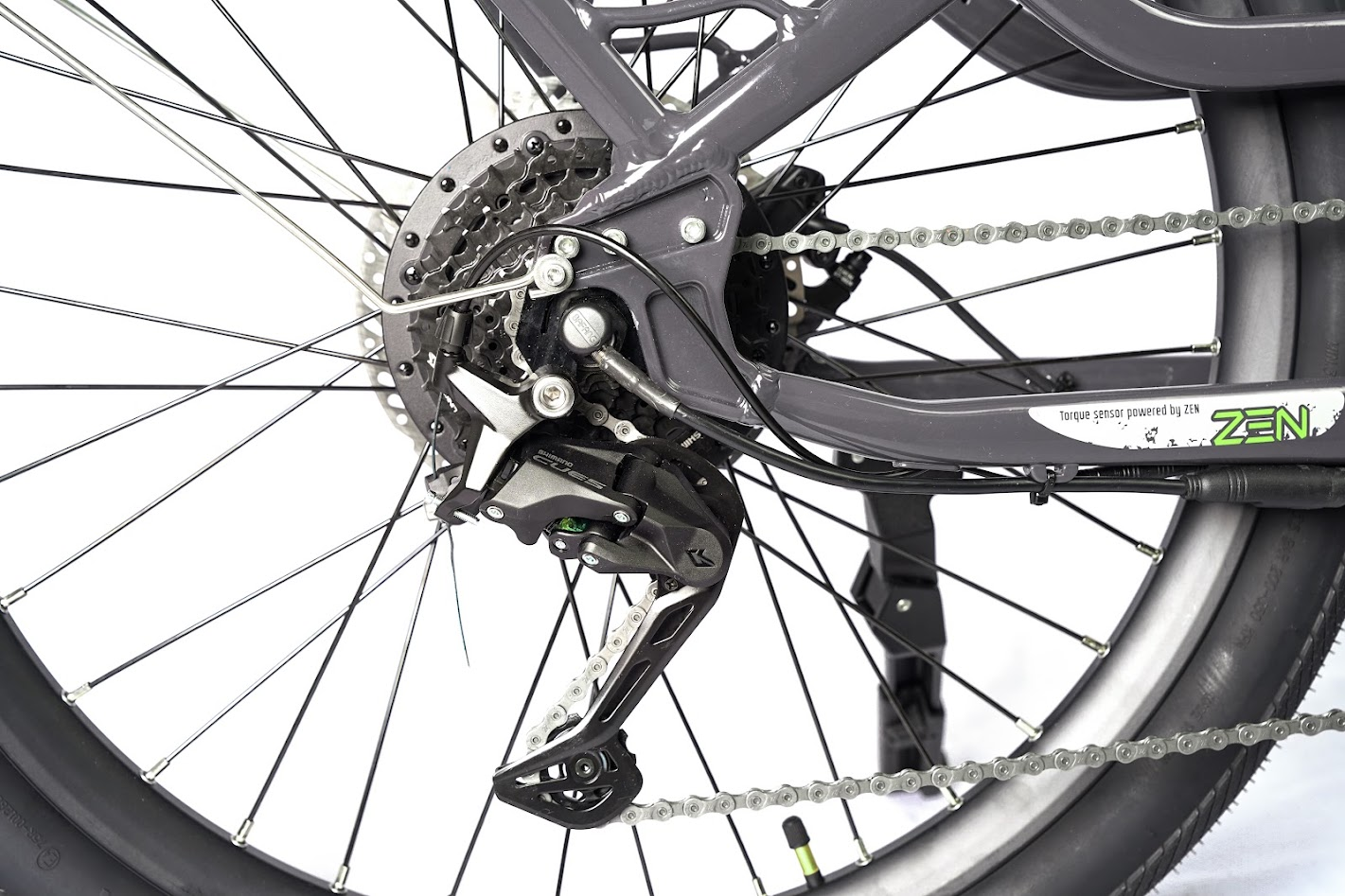

We have worked hard to ensure these Photon Pure bikes come with top-level components; for example, derailleur + shifter + cassette are E-bike Specific Shimano Cues Linkglide. These are typically found on $3500+ bikes.
Most bikes in USD 2000 price point are spec'ed with Altus or, at the most, Alivio derailleurs, which can also be found on <$1500 bikes, but we did not want to compromise on any of these.
