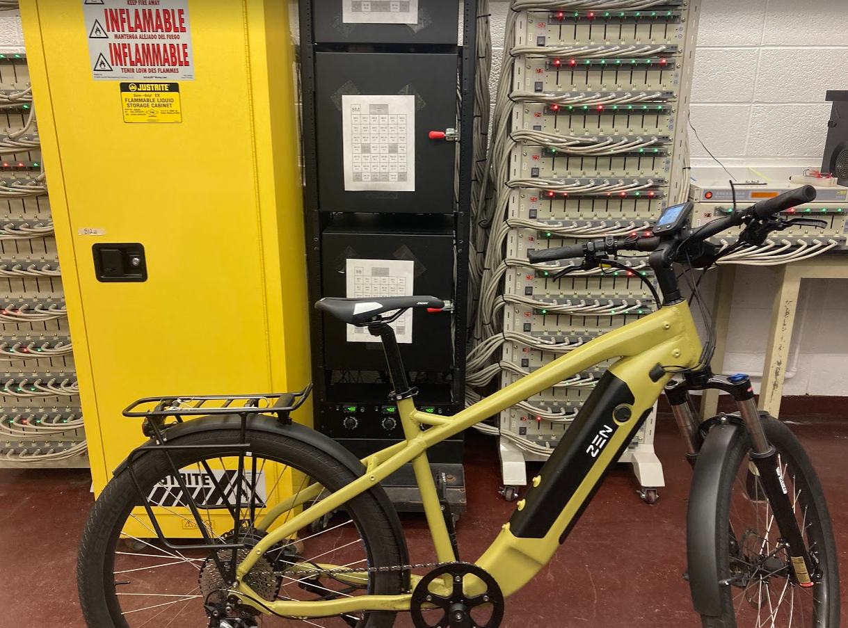

We have been busy designing an advanced battery pack for the Shakti model. This is a bike we are eager to bring to the market in high volume. There have been various setbacks in terms of supply chain but it has given us extra time for refining the product.
One of the critical components of an E-bike is the battery and we are testing various cells at different temperatures using temperature-controlled test chambers, as you can see in this image below.
We are co-designing our own BMS with our engineering partner.
We want to offer an excellent warranty (a min of 3yr on a battery pack) to our customers that is unheard of in this price range and we are doing our homework to ensure these packs last a long time.
