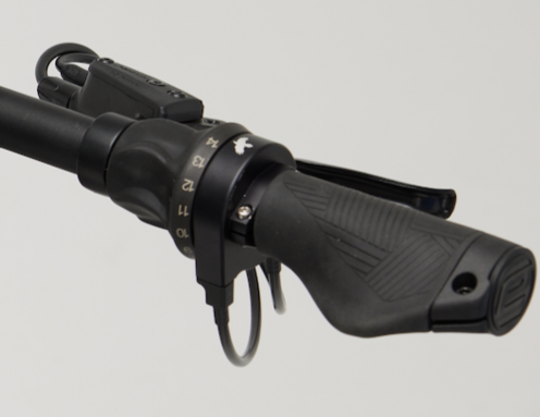

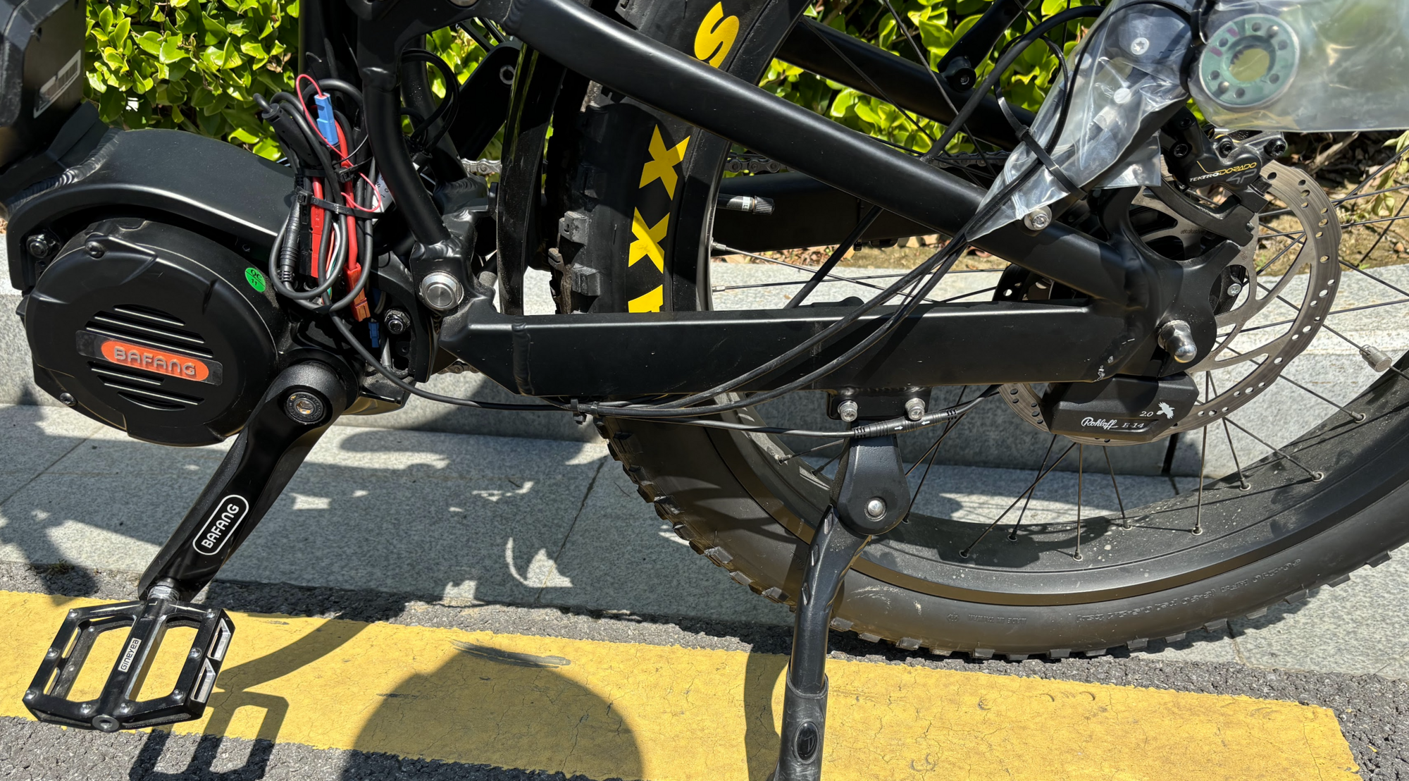

If you place an order now, the delivery will be sometime in late August. If you can wait until September, then you will be able to use Rohloff E-14 electronic shifting. While I was at the Bafang factory, we tested the new electronic Rohloff system, and it worked pretty well. See the image below. They will announce this at the EUROBIKE show this year.

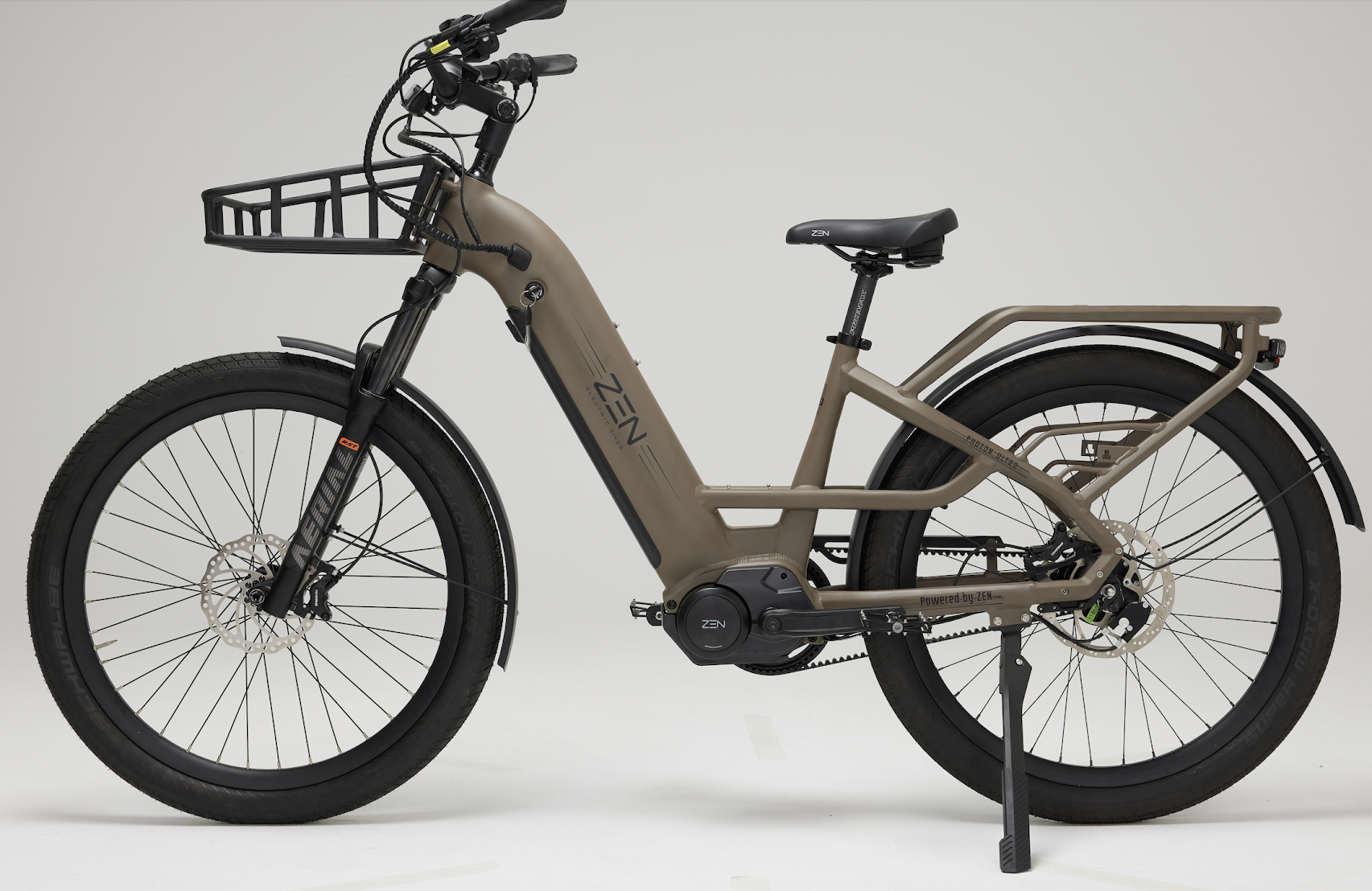

For those who patiently waited, this week, our team is preparing the shipment of the Ultra bikes. Here are some pictures with the Rohloff hub installed.
The new motor is 3kgs lighter the Bafang ultra but produces significant power. Aurora Blue, Earthstone Brown, Zen Ivory are the colors.
you can count on us to deliver high-quality products.

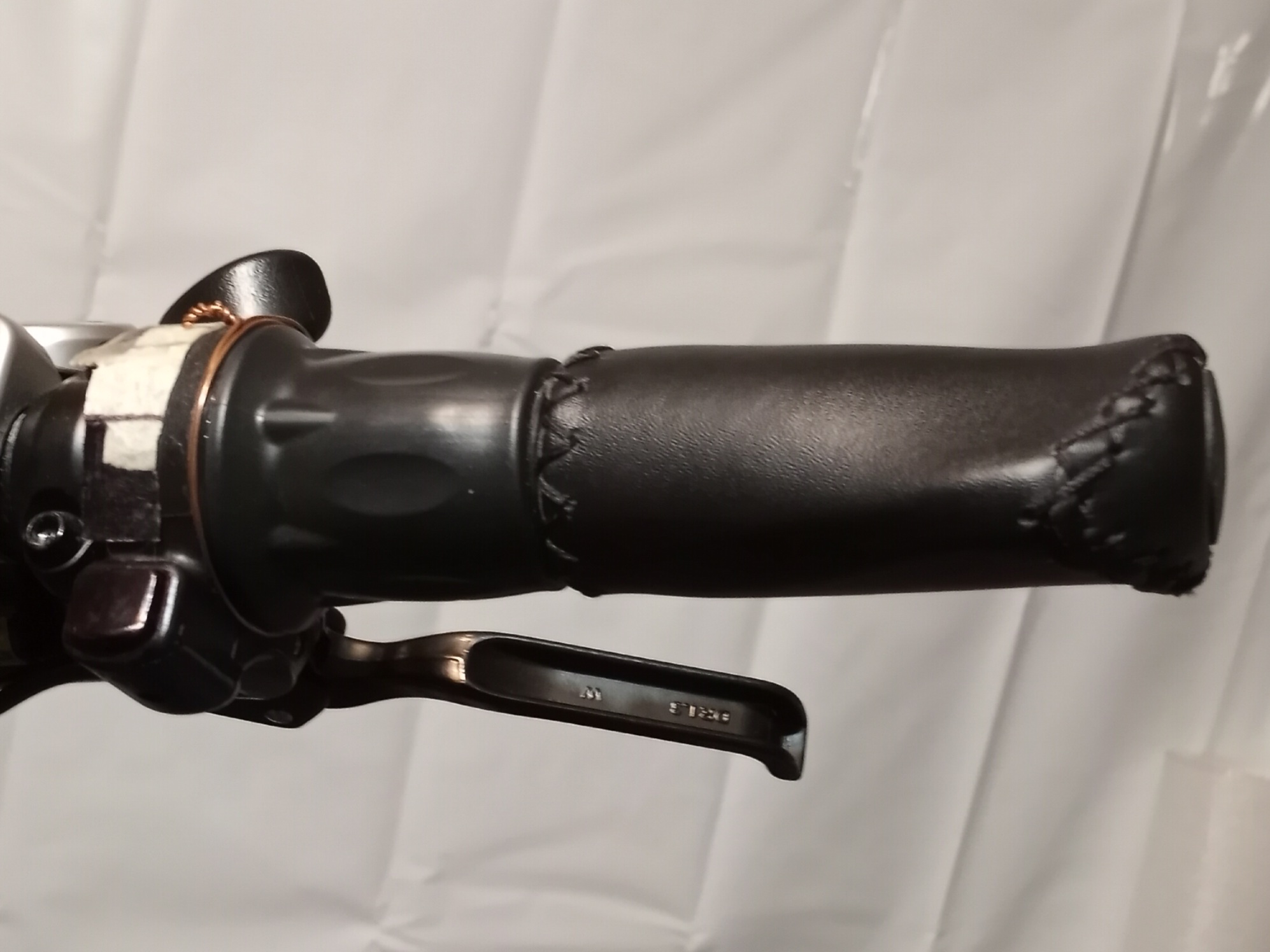

Ha! my old e-bike has a right hand shifter on the left side. 😂
Ha! looks like we've unlocked a whole new level of riding skills—ambidextrous biking!
Wait a minute,..
That's not a left hand shifter on the right side.
That's a right hand shifter installed so that you shift using your left hand. 😂
That's seems pretty tricky to operate. 😂
My throttle is similar but I adjust my throttle and hold on with the same hand,..
Wait a minute,..
🤣 ERGO Don't let photographers assemble your e-bike or maybe it's the 2025 Rohloff!
