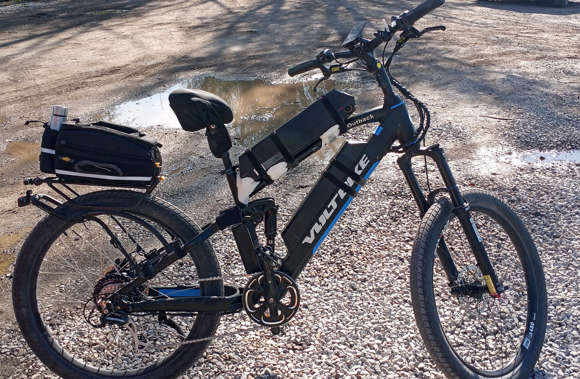

I had it mounted on the rear rack, but that gave me a speed wobble then it broke the rack off my e-bike.

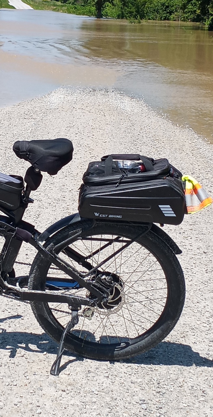

I tried a rack mounted battery bag but my spring seat, spring seatpost and suspension frame would hit the battery when the springs compressed over bumps, so I had to extend it further out on the rear rack.
The weight extended out past the rear axle gave me a speed wobble, (and it was unsprung weight) then the 20 pound battery bag broke the whole damn rack off my e-bike, so I had to start over.

Best solution would be to mount it to the down tube but...
Yeah, and it looks like it's a bit too long to fit on the down tube without sticking up past the top of the tube towards the stem and handlebars.

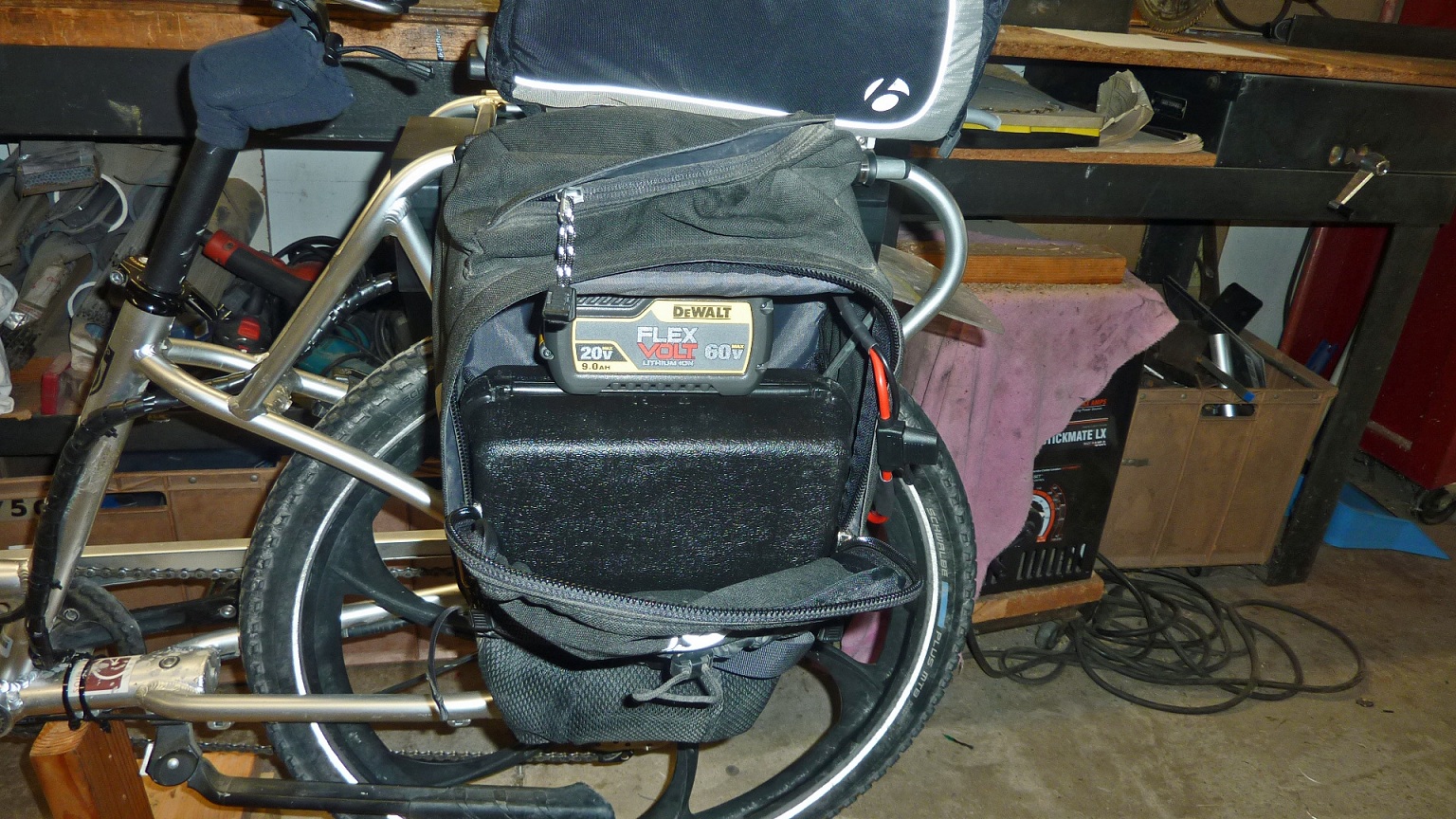

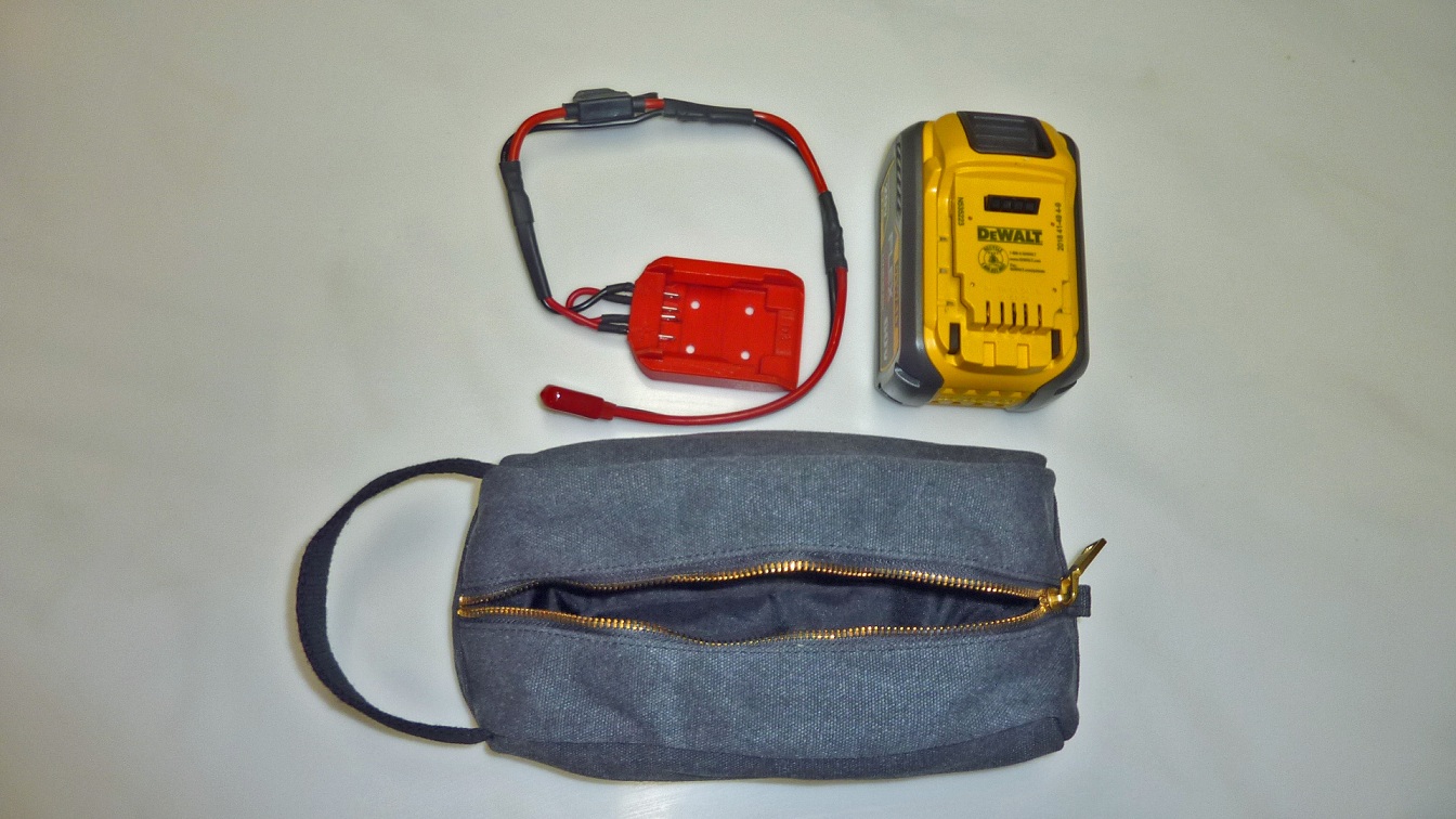

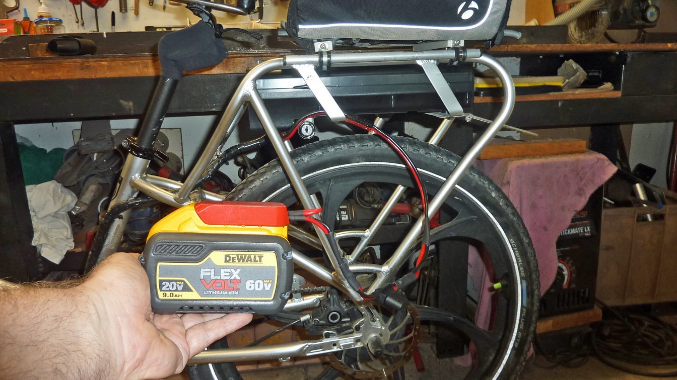

Most of the time, I carry one of my cordless tool batteries as a spare. I use an adapter with an Anderson PP45 connector that mates with those used on the bike.
I carry it in a bag, which can hang in a variety of locations on the bike, or just put it in a pannier.

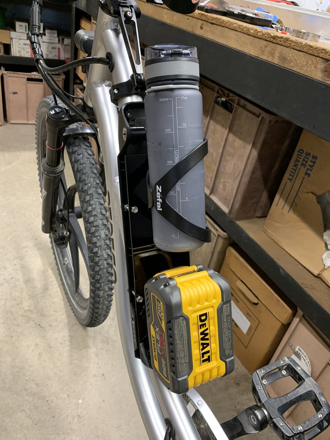

I can also use an adapter that slides into the downtube battery mount:
