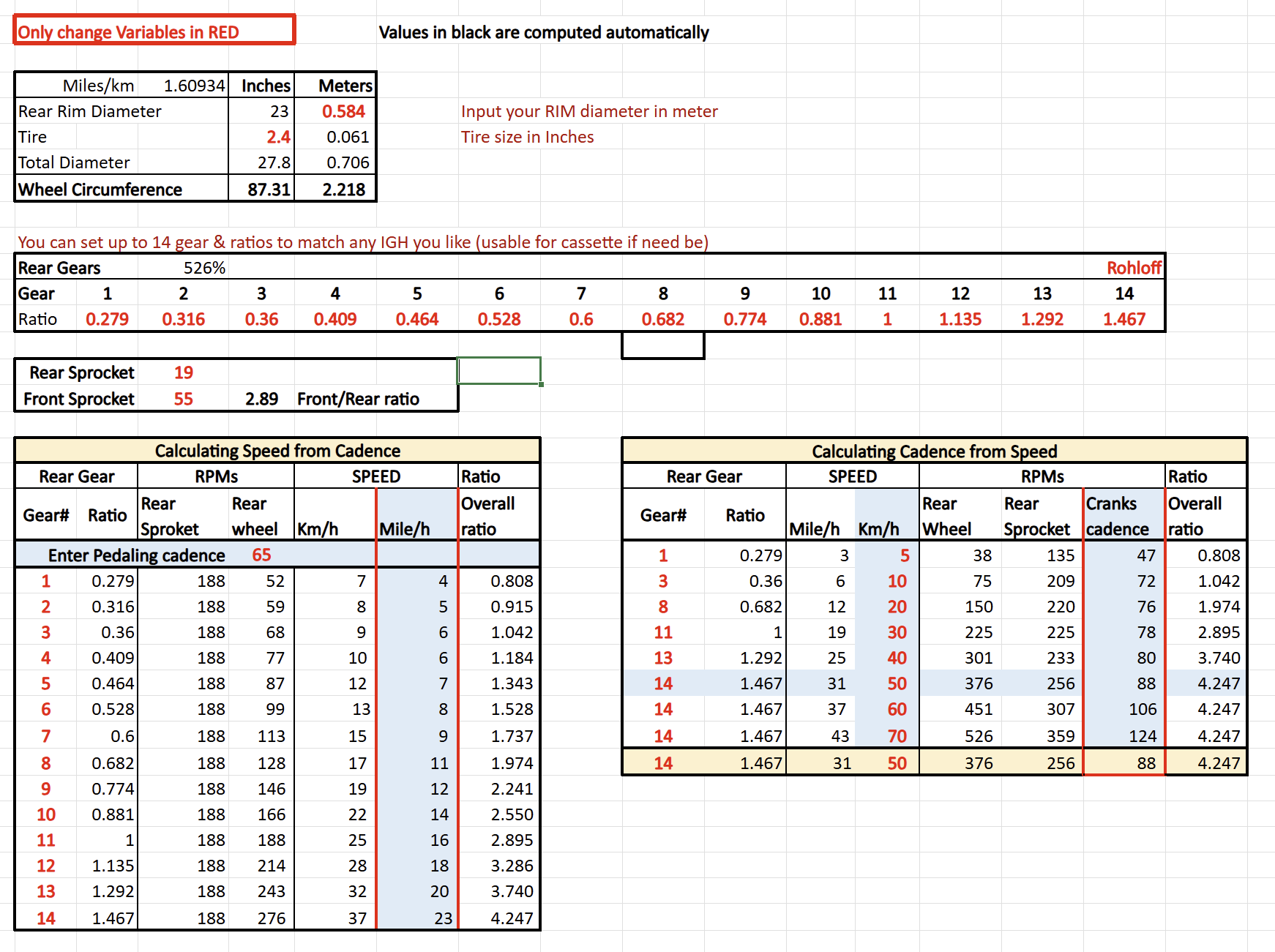

If a 60T sprocket does not fit, we can look at 19/55 (see below). For that @Ravi Kempaiah needs to confirm how much range there is at the rear axle to move the wheel forward or backward.
The 2.75 ratio is certainly better, but is it doable? With all the very low gears on the Rohloff and an available 1500watts I dont think climbing that hill will be an issue…it wont be a fast climb but will be doable.
Ravi, what do your engineers say about the 55/20, 55/19 or 60/20 options?

With 60/20 external gearing, all of those speeds would increase by 20%, but I'd worry about the effect on the 35% climb the OP faces on every ride from home.
Going from 22/55 to 20/60 basically shifts the lower gear by a little over one gear.
So unless he has to use gear one today with 22/55 he shouldn't miss it when going to 20/60

With the stock 55/22 gearing, the OP would have to pedal at a sustainable 78 RPM to cruise at 16 mph in 11th gear. That's a long way from his preferred 60 RPM. He's clearly an experienced cyclist, so we have to take that 60 RPM seriously.
How much cadence can he expect to gain with realistic training? I went from a tight 75-85 range to 80-90 in a year and 2,000 mi of casual hilly low-assist riding after 20+ years away. That 5 RPM bump brought me back to the cadence of my youth with no further gains in the 8 months since. I'd need serious training to get much higher, and I'm not about to spoil my fun with that.
The OP sounds like a stronger cyclist than I am at about the same age, so maybe he can add more than 5 RPM with realistic training. But going from 60 to a sustainable 78 RPM sounds pretty implausible. He told us flat out that even 70 RPM is unsustainable now in 11th gear at 16 mph.
A couple of things, first I did find a bike shop that has experience in gates belts and rohloff axles. i did do a 20 mile ride averaging about 17+ mph on the flats in gear 14. I am not sure that moving that speed down around gear 11 is going to make it any harder to pedal, but it will allow me a couple of gears to go faster if I have the strength to pedal. Like Jeremy said, I can hope to get my long ride average up a bit but am old enough not to shoot for the unachievable. My legs are still pretty strong from lifting and carrying heavy objects and living in the mountains means every walk is a combination of uphill and down hill. But fast I am not!
If your shop can fit the 19t rear without changing the belt or front sprocket, that would seem a good next move. You can enjoy the benefits while your cadence comes up. At 67 RPM, 55/19 will give you 15.9 mph in #11.
After a few conversations with Zen and Ravi, they were kind enough to offer swapping a 19 tooth sprocket for my 22 tooth. One of the questions that came up from the bike shop was whether the bike has a tensioning adjustment. The individual that called me back is the expert on that part of the bike and explained how easy it is to make the adjustments. Apparently I will not need a different belt. I am now waiting for the part to arrive and then will take it to the shop in Boise. Thanks everyone for your help.
I think the 80 - 90 range is the high average for the novice cyclist so going above that is a ceiling on most of us without some serious training and a time machine. I think working up to 75 is within the average humans capabilities where 95 is starting to push boundaries.
He actually sounds stronger than I so that's why I think he can, I think he can...
