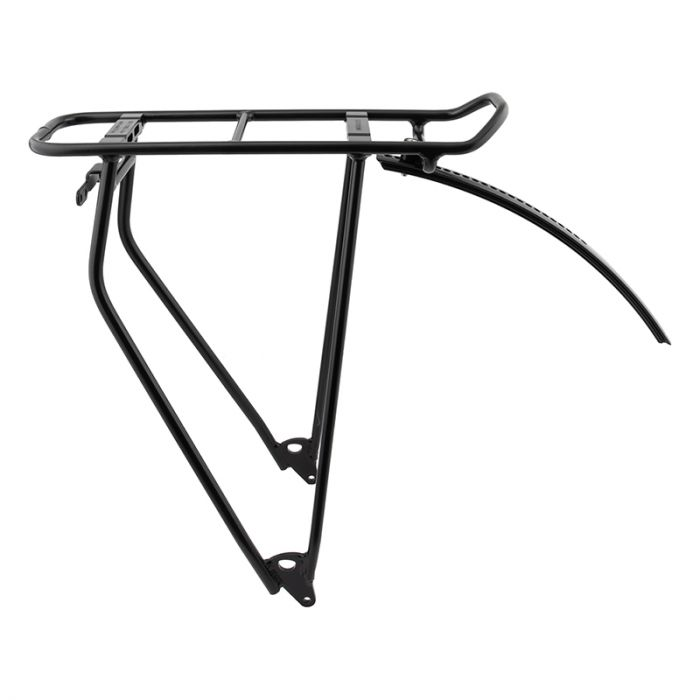

The rear rack is rated for 60lbs of cargo. So, 30lbs on each side is no problem.
The rear rack is independent of the fender. As you can see in the image below, the supporting arm runs below the fender for a very clean look, while maintaining strength.

The ol’ supporting arm under the fender…… the oldest move in the book.😁
1st I am very supportive of Ravi, knew him before when we rode a little together on Stromers , I will be purchasing at least 1 of these bikes as soon as available. That being said I do not like the design of the the under/in fender support. It appears to be what was on the Stromers . I had issues with my racks on all my Stromers , at least 4 of them. The screw into the fender area could only be tighten after removing the rear wheel. On my wife’s, ST2s the screw sheared off, fender and rack dropped to the wheel spun back locked the rear tire in place and both rack and fender were trashed , luckily i was coming to a stop when it happened only waited an hour for my wife to pick me up
if on this rack I can reach all screws on nuts to tighten then no issue but if not I will be concerned about them coming loose and a repeat. I will have at least 3 batteries on the bike every ride , usually 1 in each bag I assume ,water, tools , fruits …lots of vibrations
I would trade clean look for what appears to be improved mounting if I had a choice
my opinion yours may differ

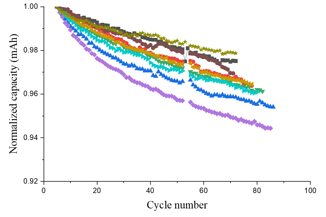

Aren't the characteristics of these cell fairly well understood? Did you learn anything new from the testing that changed your opinion of what cells to use? Nice marketing video, but I'd find it more interesting to hear you picked X because of...

Only capacity vs voltage curves are understood but how they behave at different drive cycle conditions (temperature, C/rate, calendar aging, impedance growth) is not something many E-bike companies do.
We kept the video fairly generic but I have 20 pages of test reports with a lot of details. We have invested a lot of money and effort into these tests and until we see our ROI, it would not be prudent to disclose them.
We have found some surprising results, especially in our cold temperatures testings. Below, you will see data up to 85 cycles but we do have data up to 500 cycles.
I am happy to help the community if they need some testing on a particular cell or offer relevant information that would help prolong the life of their battery pack.
