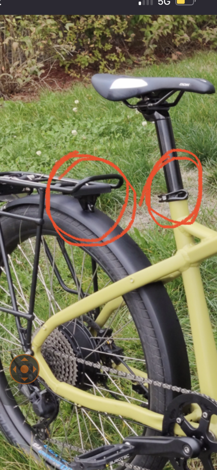

-rack needs to be independent of the fender ; else you'll have the weights (30lb backpack/2x25-35lbs panniers ) on the rack pushing into the fender or most likely breaking the welded connection between the rack and the fender !
- seat clamp has to go for ebikes shipped to Ny/La/Sf unless you send additional seatpost and seat every time they will get stolen😉;

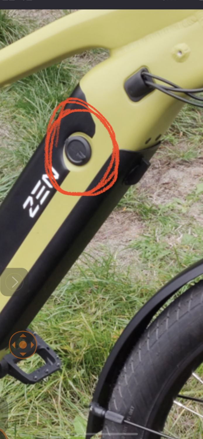

- charge port is it totally removable ? If so, Someone will definitely mess with the ebike when it's locked and remove that and then we will need additional port covers...

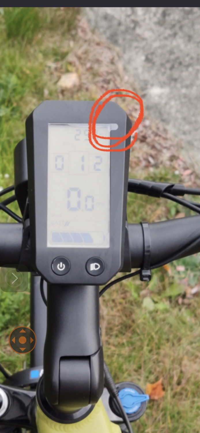

- WHAT IS THAT on the top right hand side of display ? Is it a plastic film covering/obstructing the full display ??

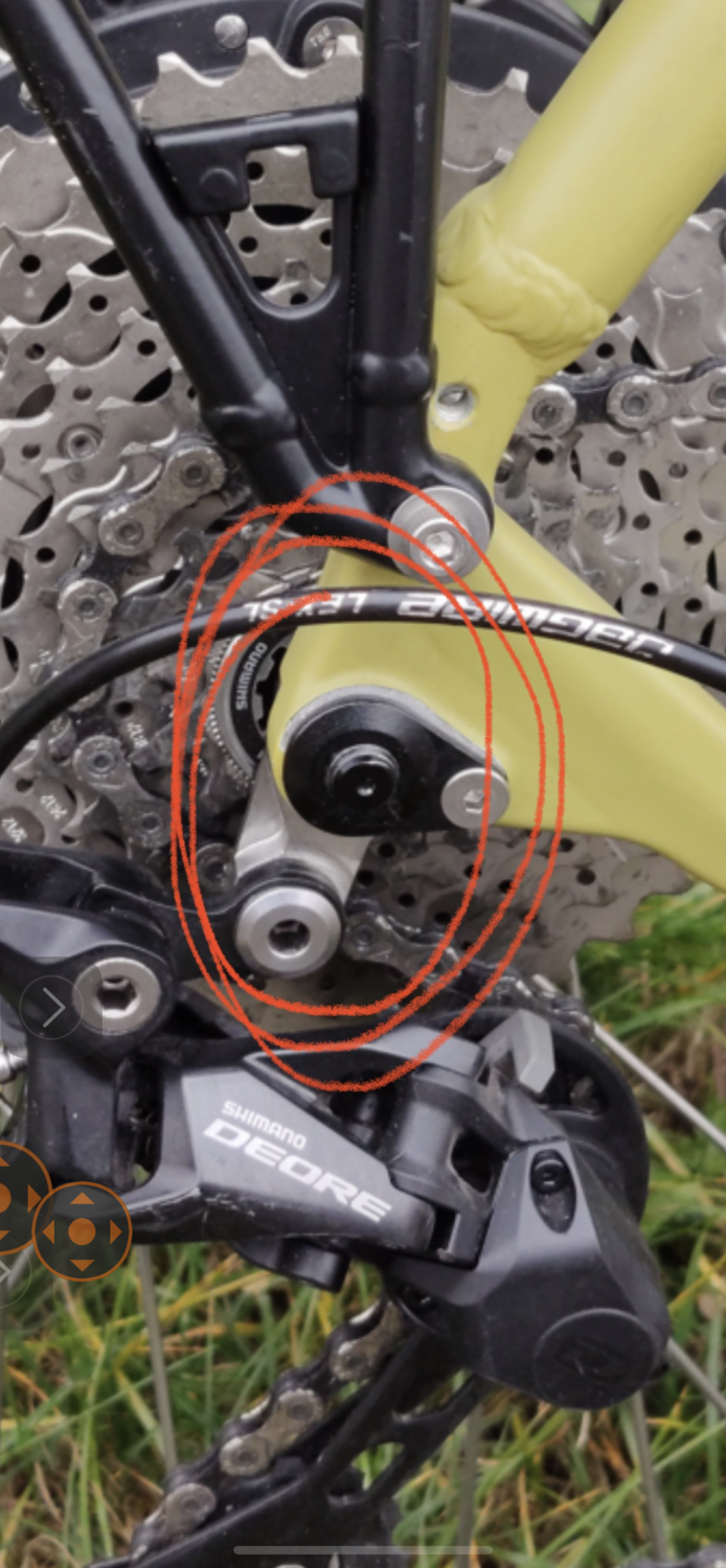

- The REAR DROPOUT AREAS....back to where is all the fun... why is the RD connectting on the inside of the frame ? Never seen that b4 !
That may cause some breakage in the drop out area ( well the connector should break first , But being that it is on the inside of the frame that will be harder , so it will put additional stress on that area)if the bike gets you know dropped/ crashed on that side;
Are the Steel torque arms on the inside of the dropouts ? What is the W of the thru axle ??

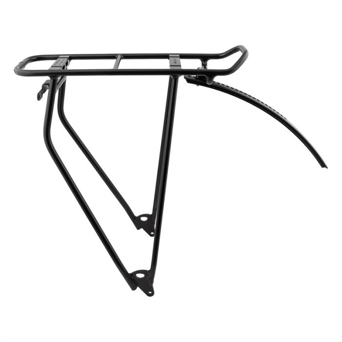

Thanks for this comment. This would be a good place to clarify some doubts so other readers may benefit.
The rear rack is rated for 60lbs of cargo. So, 30lbs on each side is no problem.
The rear rack is independent of the fender. As you can see in the image below, the supporting arm runs below the fender for a very clean look, while maintaining strength.
The charge port is not removable. It is a rubber flap that covers the charge port so that rain/dirt doesn't get inside.
Regarding the seatpost collar:
If customers are inclined, we could offer an ABUS or HEXLOX as an upgrade for front wheels, seatpost collar, etc.
This is a personal choice just like the saddle.
As I mentioned in my previous post, we designed a custom steel dropout that acts as a Torque arm on both sides.
It is not a typical bicycle dropout. It is a steel dropout that helps secure the thru-axle motor.
I've got to ask ... over the past 20 years have you never unpacked a new electronic device or appliance?
"THAT" is clearly the tab to make it easier to remove the temporary protective film on the display.
IF you are not in a nursing home and can read with the two glasses that you have , you can CLEARLY see that I did mention that possibility of the film covering.
Now the part that I do not understand , is why you did not choose to understand that particular sentence of mine but instead choose to disregard it ??
"Is it a plastic film covering/obstructing the full display" ?
