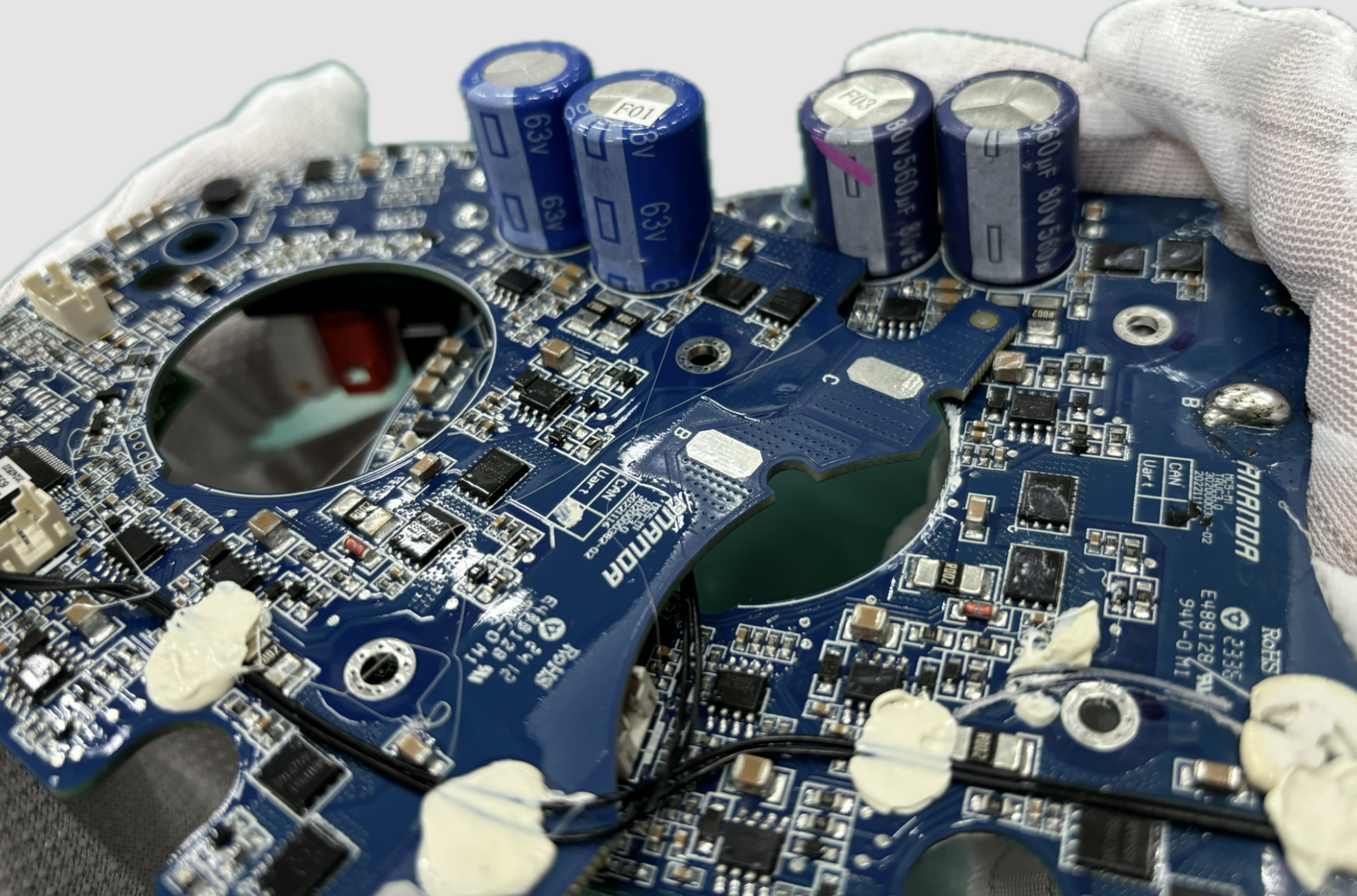

We discussed at length on the performance of this new motor M6100, customization to make it US-market friendly. Below, you see the difference in the controller used in the regular 48V motor (uses a 63V capacitor) and 52V motor (uses a 80V capacitor). The firmware is also different on both. we are one of the rare few that use 52V system.
The motor armature is also bigger and allows for larger current - 30A than 20A on the regular M100 motor. So, this motor has tremendous potential and what we found is that it requires some update on the programming side and it would be a clear winner. It is smoother and lighter than M620 motor from Bafang. So, we have decided to work with them to fine tune this motor further.

One thing that caught my eye if I'm reading the board correctly is that the 48v is marked UART whilst the 52V is marked CANbus

You have very sharp eyes!
Because our BMS and charger all communicate on CANbus, we have to use this. When you have CAN, the charger can precisely show SoC and stop the charging process once it reaches the desired voltage and error rate is much smaller.

No one gonna slip it in the CAN_bus on me! 🙃
I'd think the benefits would be multifaceted with the higher level of communication between the display as well being able to convey such info as charge cycles, cell V, temperatures(battery/controller).. etc, and facilitating a more accurate range prediction...etc.

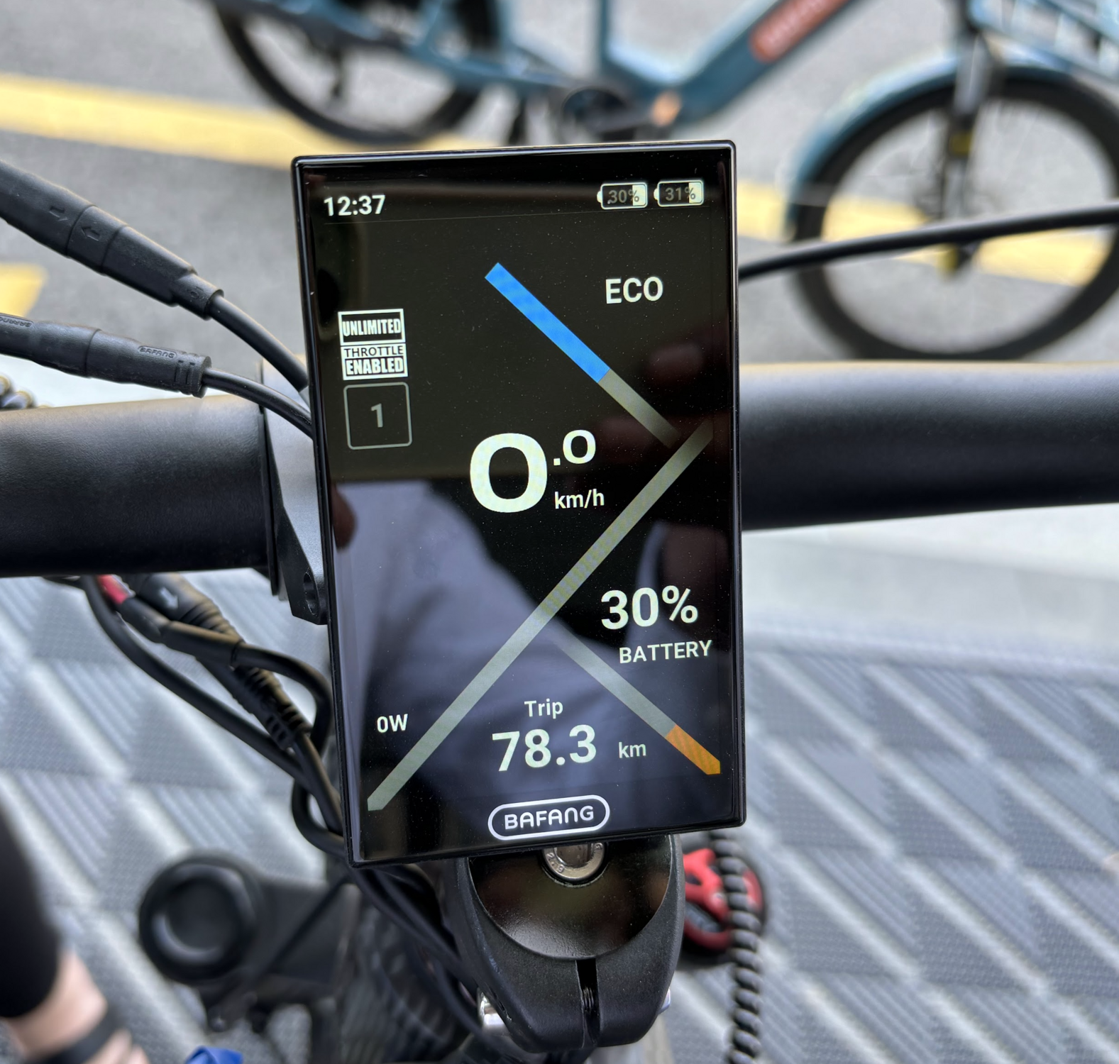

This feature will enter the market later this year. We saw the new displays from Bafang and they have dual battery options, Class 1,2,3 can be changed on the display and tune the torque and power curves using the App.
This is possible because all peripherals communicate via CANbus.
This will help cater to wider section of the market and enable full use of motor's power.
