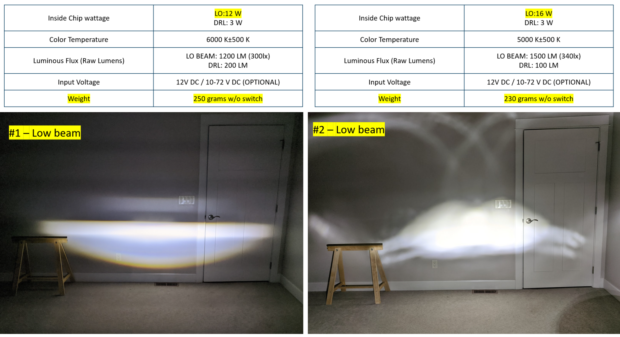

E-bike lights:
Paul was kind enough to test various lights and picked these two. Option #1 has a sharp cut-off but it is more focused. Option #2 is not as sharp but it has a wider throw of light.

i liked the light on the left
