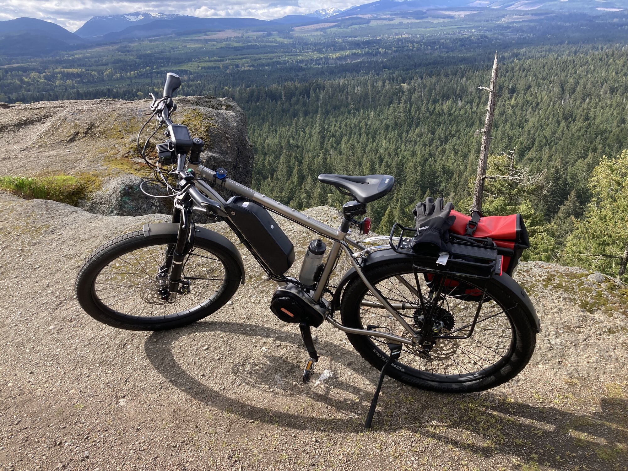

I took my UC Pro for a 55km ride today (the rain stopped!) and I have to say this bike is a joy to ride. It's very comfortable and the power is addictive.
I rode up a REALLY steep hill during my ride. I don't know what degree of steepness this 1 km hill is, but only a handful of riders on regular bikes have made it all the way to the top without getting off and walking.
I rode up in level 3 (I have mine set to 5 levels) and the bike flew up the hill. With some of the steeper parts I hit 1300 W.
This like is turning out to be my favorite bike. If I could use all of the gears and the bike was a bit smaller it would be almost perfect. I say 'almost' because I'm still think it looks a bit DYI, but that becomes irrelevant when I ride it.

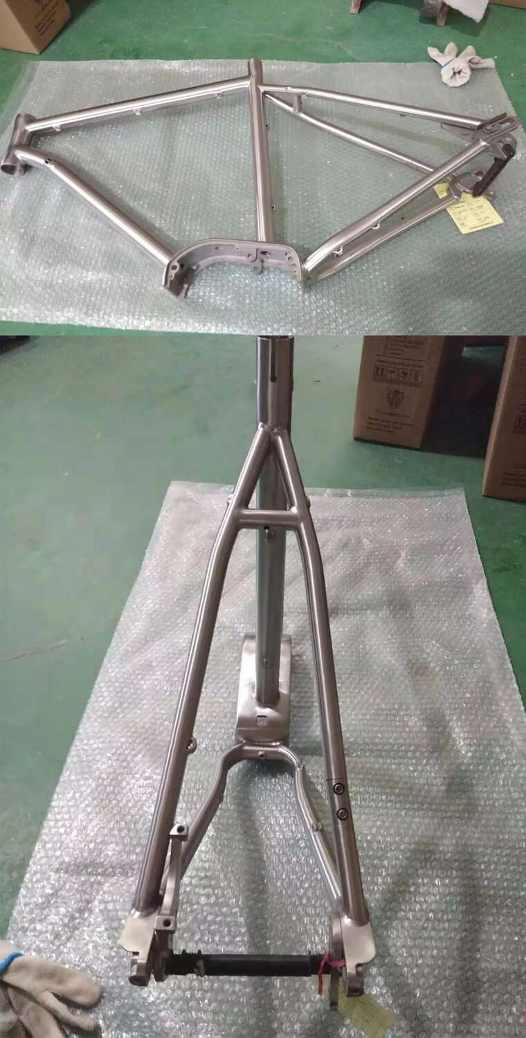

The Baoji Titanium Valley, near Xi'an in Shaanxi Province, China is the titanium center. They went into partial lockdown on April 15th.
One of the titanium producers (Shaanxi King-whale Information Technology Co., Ltd.) is up and running (maybe).

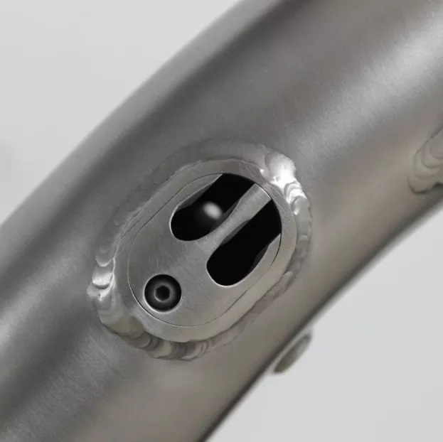

But look at the welding job (lower photo) at the seat-tube ? And is the seat tube supposed to be offset of center at the motor housing like that ?
See: Titanium frames for more photos. Look closely and there are more sloppy welds.
Welders I've known produce 'rolls of dimes' welds. That stuff is awful.
With titanium it's what you can't see that's the big danger: Oxygen embrittlement

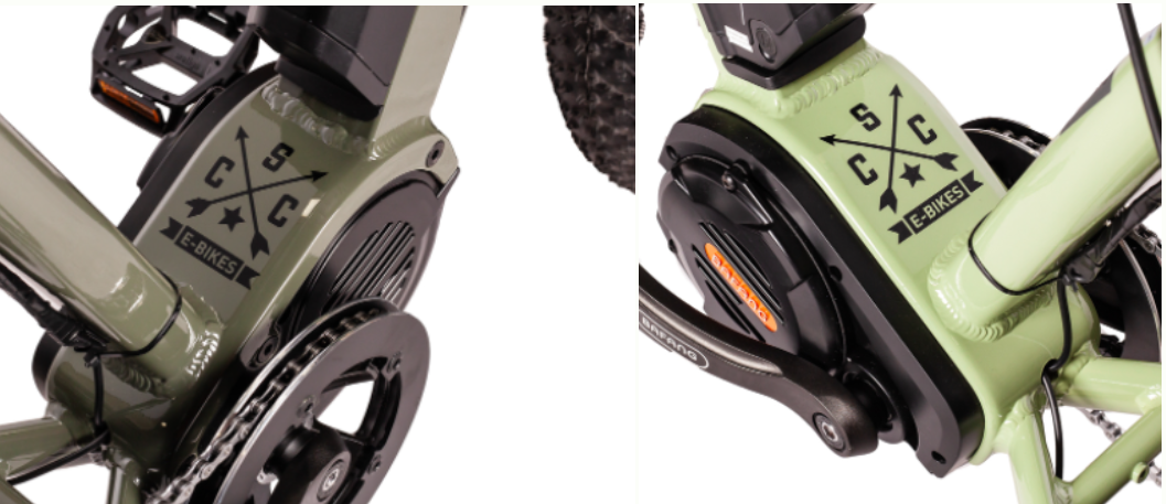

What’s your opinion of Carver TI frames? I’m going to do a regular bike build with their All Road frame. They do custom stuff so I’m curious to see if they would do an ebike frame.

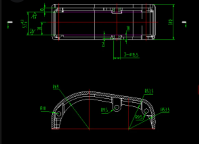

Offset is normal, the motor itself is not symmetrical. Looking at the outside of my E06 frame the seatpost is centered, but the actual mounting points that line up with the motor mounts are not. The mounts on the motor are offset at least 1cm to the side.
You can see here in the CAD for the bracket the mounts are offset to the side
That offset isn't normal. lol. The photo of the seat stays - botch-welded in crooked to make the hacked in, off kilter seat tube fit is a dead giveaway.

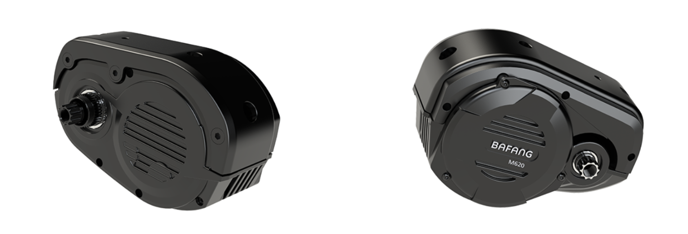

Not sure why you keep posting that fuzzy pic in Chinese? Of course the motor has an offset. The version in English shows that.
But I just want to get this straight. You're saying that HUGE offset is normal, but your tube isn't off-center like that at the motor bracket?
This begs the question: Are the G510 motor brackets all (relatively) the same?
If 'YES' it's welded in the wrong position.
If 'NO' then what's your point, posting stuff in Chinese that's entirely different ????
Do you think this company dumped the Bafang licensed mount cad cam and just made up their own mount?
You completely lost my simple mind, but I guess it make such perfect sense, if you don't think about it.

Here from Bafang's website you can see the bracket and how much the motor protrudes on the non-drive side, along with that plastic cover
Here you can see how the motor fits up with a frame. The seatpost isn't full centered (to the outer dimension) but the flanges in the bracket are still way offset for the motor to keep the chainline correct. The Ti frame pictured probably just has a little extra on the non-drive side that the plastic cover fits into. If anything providing better splash protection.
