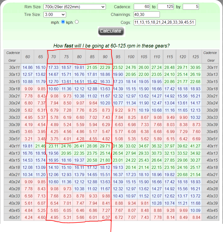

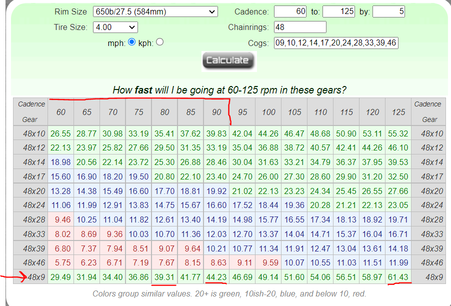

How large of a chainring can the crosstour fit? A 48T with that e18 cassette is going to give a top speed of 39mph at a comfortable 80rpm cadence (average range for recreational cyclist is 60-80, optimal for humans is around 90) on the 27.5x4's. Now for me, honestly 40mph is a pretty good top speed for my commute; I only have a short section between home & the greenway that I have to share with cars and it's all residential or by a school, and I wouldn't go that fast on the greenway with others on it - it goes right to my office. I can 100% see the case for 61mph speeds in rural areas but you'd need over 5400W to achieve that (slick tires, asphalt, 165lb rider weight, 70lb bike+gear weight, no headwind)
at sea level (5000W @ 2500ft a.sl, 4300W @ 6800ft a.sl - CO avg elevation, highest of any state, lucky!) Omnicalculator - cycling wattage
You can use the tool at Bikecalc - Speed at cadence to figure out what setup will be best for you & your bike. My totally unprofessional advice would be find the combo that gives you your desired top pedaling speed at around 100-120rpm since the motor is going to be more efficient the faster it spins, and keeping up a higher cadence for cruising (90-110) is going to pretty easy with an assist level. If you're cruising, doing so at a littl lower speed will be more efficient (less watts spent moving air)
Quick little math here, using 1kW of energy, you can see how dramatically range drops with higher speeds edit this is at sea-level, conditions as described in the prev case
20mph @236W: 84.74mi, 25mph @426W: 58.68mi, 30mph @ 705W: 42.55mi, 40mph @ 1594W: 25.09mi, 50mph @ 3045W: 16.42mi, 60mph @5196W: 11.54mi

Here's a chart showing what I can expect with my setup using a 30T & a 40T chainring. The 30T is definitely more for mountain goatin' and keeping a higher cadence at lower speeds up inclines, but you can see with the 40T in the top 3 gears I have a good cruising range from 22~30mph, and I can still boogie on up to 41mph if I need to give it some sauce - which makes sense because I'll probably wind up setting my X1 to 1000W nominal (1700W peak?). Like I said it's dependant on your needs - and 36mph does sound like a pretty sweet cruising speed, taking into account your handle is Fast n' Furious lol

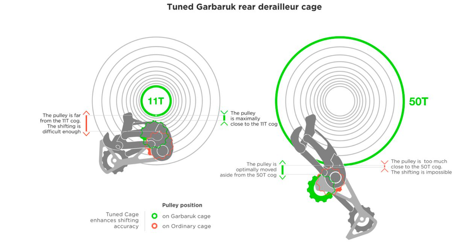

@Lsthrz you can see here on Garbaruk's illustration what's going on with the derailleur when we're using a cassette with a wider range than it can handle. Don't get the Ceramicspeeds I suggested those a joke! If you want to burn money and be cool get the Kogel's - they're about the same price lol. You can absolutely just go a whole different groupset including the fancy electronic ones before spending that kind of money on a cage & pulleys. I ordered the Garbaruk cage & pulleys (splurge!) from Bike24 for the same price shipped as direct from Garbaruk before shipping - I mostly searched around because Garbaruk didn't have the pulleys ready to ship. If you do go this route, you might as well order some backup Magura brake pads since they're about half USMSRP through an EU retailer. I'll be checking this whole setup with an 11-51T I don't expect any issues even though the product page says 11-50T.
Loamoak, I'd be the first to admit that I know very little about how derailleurs function, but looking at the cross chaining on my UC Pro I can't help but think that nothing can be done to this derailleur to stop the chain skipping in the cassette's smallest 3 cogs. The chain angle from the front ring to the 11, 13, and 15 rings is huge.
@Deacon Blues you're right the cage won't do anything about the chainline being out of wack. That's gonna be handled by moving the chainring up front outward. The chain should be perfectly straight on the middle cog ~2mm outboard of the middle cog as per the article linked by Jon below. Do you know what your rear axle spacing (hub/dropout width) is? If the frame has fatbike spacing then it would need the fatbike spider, but it's free to check if flipping the chainring to the outside of the current spider fixes that issue. I think the illustrations & discussion around that was covered either in your thread or KW's thread. You can follow this Park Tools guide to ensure you derailleur is set up correctly. I can see why WW is seeking to get some dealers stocking their bikes - if they can get a good distribution network then outside of parts compatibility that would eliminate assembly & shipping issues - the bike's final assembly & setup would be done after shipping at the LBS and customers would go pick it up, so no risk of any issues arising from rough handling. Another benefit is freeing up team WW for more R&D/polish on bikes, of course supplying through a dealer network may or may not raise the price on the bikes.

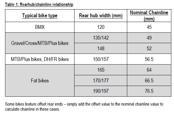

A handy reference for chainlines from Raceface:
A nice writeup from Wolftooth: https://www.wolftoothcomponents.com/pages/boost-chainline-and-chainrings
Interesting quote from that:
If you are running 12 speed, the clearances are so small between chain and cassette that you MUST run a boost spaced chainring with a boost spaced bike. If you don't, the chain will "tick" on the next bigger cog when in the smallest 2-3 cogs on the cassette.
The center of 11 speed cassette is ~44mm from the centerline of a bike. Why isn't that used as the chainline?" Well, for proper shifting on a 1x setup you want to be at least ~2 mm to the outside (towards the small cogs) otherwise the chain will catch on the next bigger cogs when pedaling in the smaller cogs. So a perfect 1x with minimal cross-chaining in the big cassette cogs is 46-47mm.
@Jon A nice find on the article, makes more sense that it would be a little outboard of the middle cog. That ticking on the larger cog can also cause skipping because the cogs have ramps on them to grab the chain when you shift. Some cassettes have different patterns or more aggressive ramps than others so this could be more or less pronounced depending on whether you're rocking the e*thirteen, Shimano, or Sunrace cassettes.
