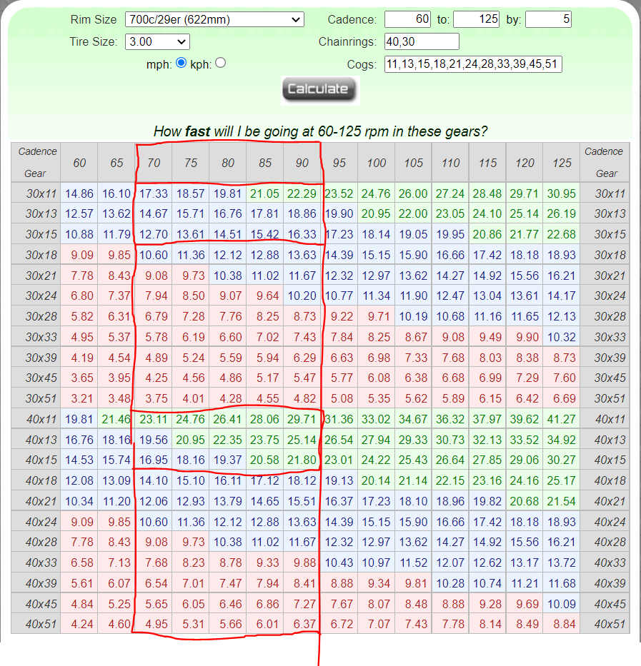

Here's a chart showing what I can expect with my setup using a 30T & a 40T chainring. The 30T is definitely more for mountain goatin' and keeping a higher cadence at lower speeds up inclines, but you can see with the 40T in the top 3 gears I have a good cruising range from 22~30mph, and I can still boogie on up to 41mph if I need to give it some sauce - which makes sense because I'll probably wind up setting my X1 to 1000W nominal (1700W peak?). Like I said it's dependant on your needs - and 36mph does sound like a pretty sweet cruising speed, taking into account your handle is Fast n' Furious lol

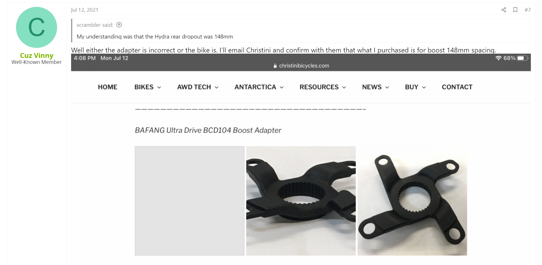

I say it's the offset - bigly.

Deacon ... that IS a huge offset.

While hydaphiles were upset it was too much offset, that's supposed to be the correct offset fitting for a 148mm rear. Are you wider?
If not what?

I looked around on endless sphere for you. Fat Bike's were adding additional 6mm offsets for this exact problem.
I thought from the start there might be a coefficient factor. 8mm is a lot. 6mm is the most common.
The fat bikes documenting were boost and 177mm, not the 197mm tail.
@Jon A nice find on the article, makes more sense that it would be a little outboard of the middle cog. That ticking on the larger cog can also cause skipping because the cogs have ramps on them to grab the chain when you shift. Some cassettes have different patterns or more aggressive ramps than others so this could be more or less pronounced depending on whether you're rocking the e*thirteen, Shimano, or Sunrace cassettes.
Yeah, I hadn't seen that extra 2mm before, I hadn't really thought about it much beyond "aim for the middle!" But it does make some sense in that an angled chain only hangs in the air on the big cogs but can run into the next cog on the little ones. And it does seem to line up with the nominal recommended with a lot of systems.

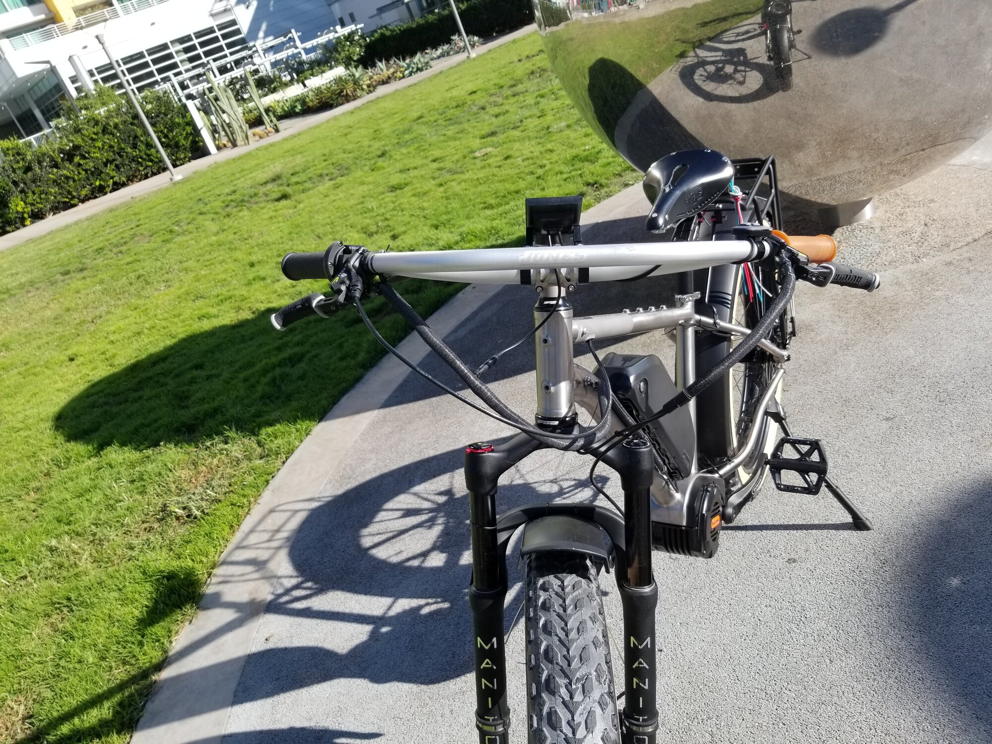

Reply I used the imagery of a duck billed Platypus because My bike is outfitted with what was available…With the understanding that any parts Pushkar had on hand were quality ..so while I may get 27.5 x 2.4 rather than 3.0 they’d be quality 2.4 s … they are. … I got the available Rohloff when Kindernays were delayed and it works well.. . took a little tinkering and an added belt snubber and some belt tensioning..but again no belly aching about a Rohloff
Overkill upgrades on forks and brakes due to supply and my “commuter” can take a 4” curb with ease and handily toss my big ass over the handle bars if I locked em up at 20 mph..
Much like the platypus some things look like they don’t belong.. my version of the CT is all externally wired and lines don’t match up very well up front .. al least not as well as any CT picture I’ve seen.. .I did get some aftermarket spiral wire organizers for “cock pit” cleanup and it looks ok But kind of like a duck bill on an beaver . i got the Magicshine battery instead of the wired light and much like the Bafang 2300 it’s way overpowered for my needs and adds more wire … again not a deal breaker but it only kinda looks like it “otter?”
Since Helios and I said Adios after a year and my ill fated brief dalliance with Hydra ( as commuter) fizzled , I feel fortunate to have this quality ride and am grateful for the service I received .. to the point of Pushkar remotely accessing my laptop on a Saturday morning to troubleshoot an Innotrace issue.. while wrangling his twins! . Need I say more?
Not perfect… but when they see me coming with the Bafang hum and the GP5s raised up like bull horns in a Magicshine halo ..I’ll ring my dime store bell ( spurcycle are back ordered) and pass on the left… thinking about my friend with the oddly webbed feet.

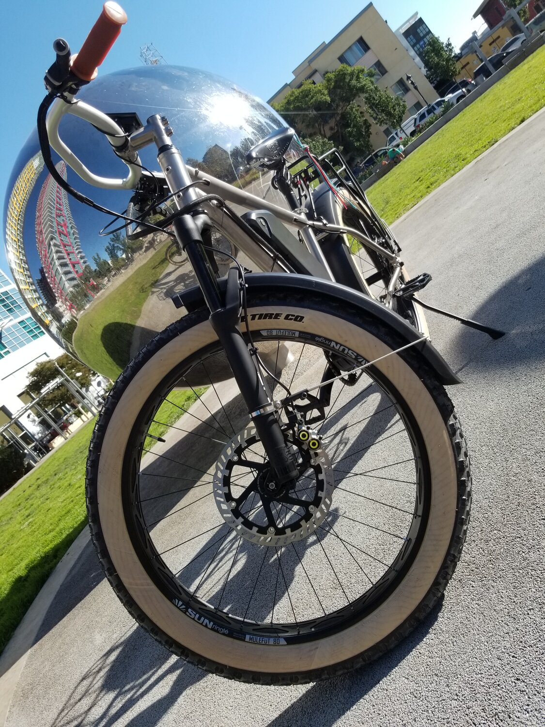

Those're 80mm rims. 27.5 x 4.0 would suit this bike, in Eco mode, L3.
I'm running a 46t ring. A 50t would be a lot more top end, but more torque on the drivetrain.
Unlike an IGH, the Archer will shift mid speed, no pause - crunch, your in. Easing out on throttle saves the day !
Get moving and out of traffic's way, then use pedal assist saves 3 - 4 highest gears. No sense needlessly wearing them out on stop- go City traffic.

F&F, notice any chain skip? With the wider chain stays and wider wheel I suspect your chain is much better than the setup I have.
None. And I'm watching with you in mind.

Wide Q factor required to clear chainstay's reasonable for me.
