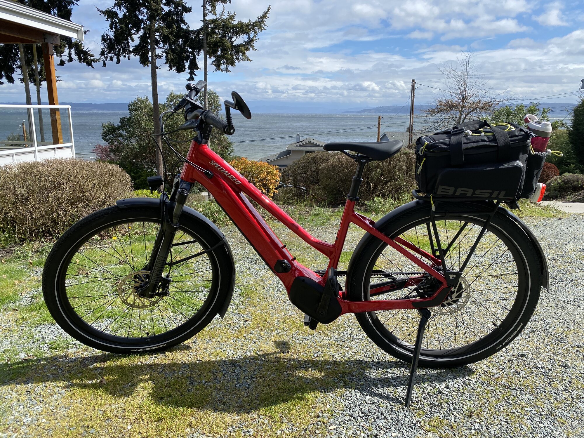

I have had my Vado 5 IGH for about 2 weeks. It’s a beautiful red step through!!!. I now have about 85 miles on the bike, flat and hills. It replaces my 2020 Vado 3. I have easily adjusted to the automatic gear changes, in fact, I never want to go back. However, I do have a serious issue with this bike which is supposed to have so much more power than my Vado 3.

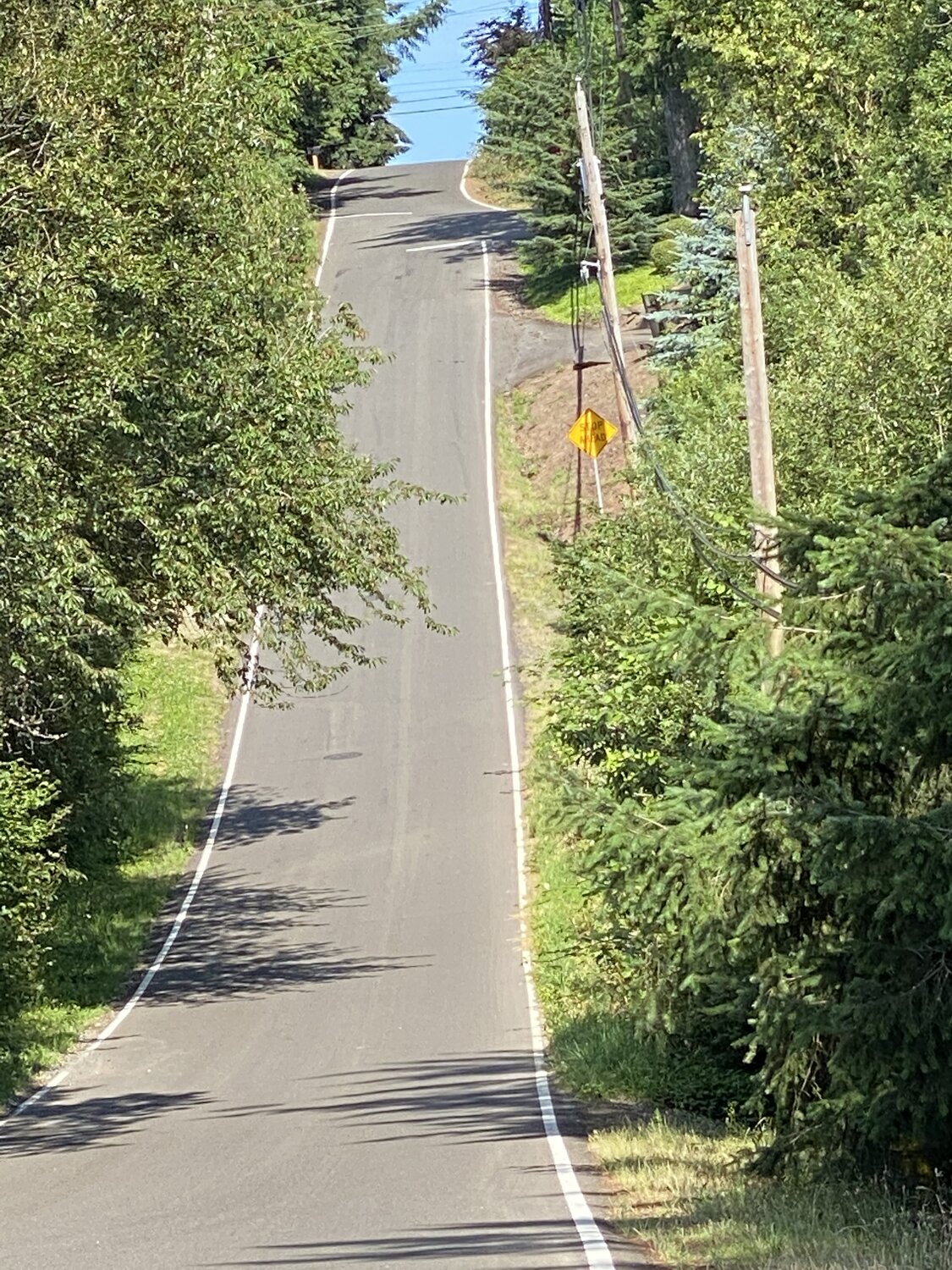

I have to regularly ride up a hill on the road I near my house. It has a 20-30% grade and is about a ¼ mile long. One of the reasons I upgraded to my Vado 5 IGH was to have more power to climb the hill. The Vado 5 IGH has me pedaling harder and slower on that hill than the Vado 3. On the Vado 3 I finished the hill in second gear, level iii, speed about 7 mph, pedaling without much effort. Vado 5, I finish the hill in first or second gear (according to the gear graph), Turbo, and about 4 mph….and more effort pedaling. The motor seemed to be struggling. It didn’t purr up the hill, but jerked a little. I have gone up that hill numerous times with the Vado 5 IGH using different cadence levels (slowest, slower, slow, fast). I always use Turbo up the hill. My Turbo is set at 100/100. Nothing seems to help make the climb easier. With the power this bike is supposed to have, it should easily surpass the performance of my Vado 3…..and right now, on that hill, it doesn’t perform as well.

The picture does look like my hill. So the Vado 5 IGH does not gear as low as my Vado 3? I would really like to talk to someone at Specialized who knows the Vado 5 IGH well.
